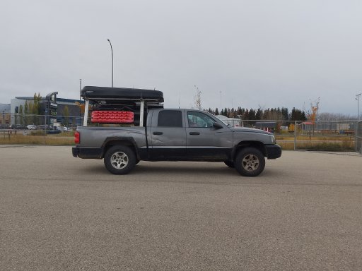

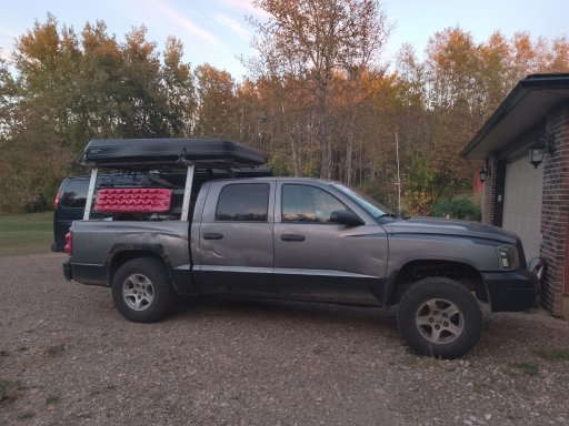

Updated photo showing the repaired body damange. Pic taken on our expedition to the Rockies Sept 2023:
Far from body shop perfect, but it's way less noticeable and won't rust away now.

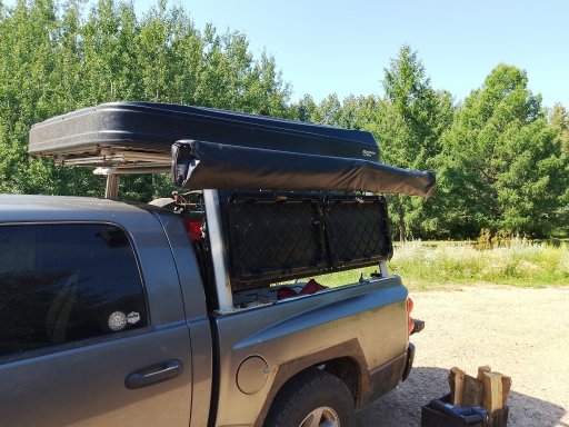

Big day for Rumble today. I installed the Evergear 270 degree batwing awning from Princess Auto today. Cost me $233 Canuck bucks, shipped to my door, taxes in. I've been considering this since the expedition in September of last year, and at that price with free shipping, I couldn't say no. As I type this, I'm out bush camping with my 5 year old son and making great use of it :)media.jpg

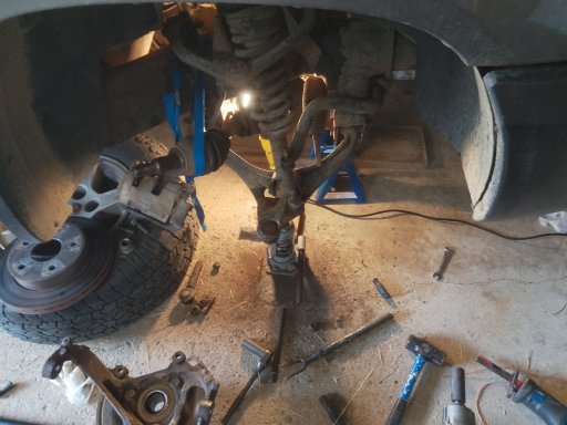

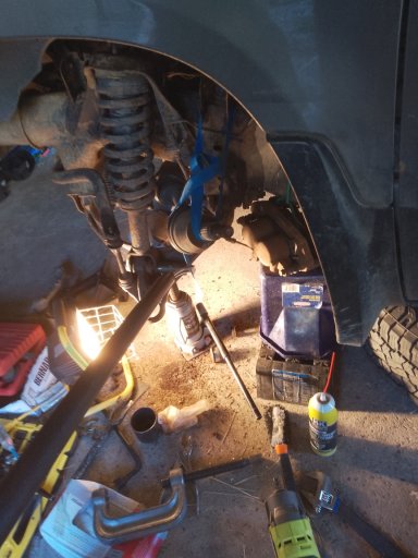

Rumble is currently in the garage undergoing repairs. I'm doing basically the entire front end suspension: struts, upper control arms with ball joints, complete tie rods, sway bar links and lower ball joints.
I hit a bit of a snag with the lower strut bolt as there's no way on this planet it's coming out without an impact, but my buddy has one and I'm borrowing it tonight, so should be good to go after that.media.jpg

The sweet, sweet taste of victory.
The first serious battle was getting the tie rod end out of the steering knuckle. I had to cut it off with a sawzall and press it out with a ball joint press. It shot across the room like a champagne cork lol

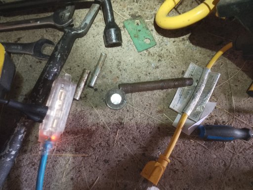

The bottom shock mount bolt was an absolute bear to get out. It took a solid three minutes with the high torque impact (to say nothing of gallons of penetrating oil) just to budge it. Then trying to get the bolt out was a nightmare. Persistence and some very creative use of a ball joint press won the day, however the bolt was horribly rusted and slightly bent, so I had to cut the head off to drive it out backwards. I ordered a new one from the dealer. Assembled some while waiting for the chance to drive to town for it.
(Breaker bar with +5 Pipe of Leverage bending like a licorice stick)
RIP shock mount bolt - it was rusted to crap and slightly bent.
Sweet, sweet victory. Next the shock bolt goes in and the knuckle goes back on.

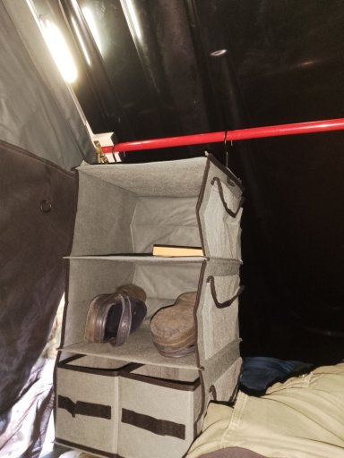

Not technically a rig upgrade, but a minor improvement to the RTT setup; got a set of magnetic LED lights with USB charging and motion sensor option, as well as a hanging organizer. The red bar is an old broken metal broom handle that just so happened to fit perfectly across the tent. The two lights and the organizer were $20 each, all in.

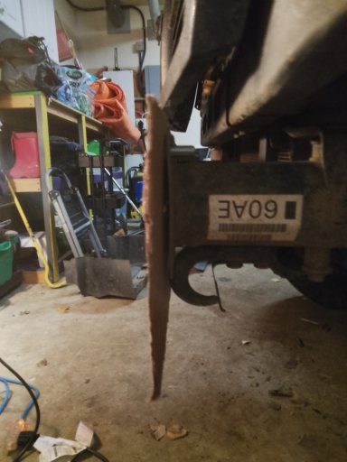

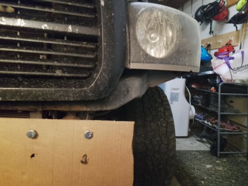

So, I had a crazy idea I wanted to test out. So far, it looks extremely promising that it might work. Can anyone guess what it is? (No, it's not fitting a cardboard bumper, you jokers...)
Reactions: Mekcanix
CR-Venturer
3,372
Ardrossan, AB, Canada
Jas
Spr
16340
Keen eyed observers may have noticed that the bolt hole pattern on the carboard matches a jeep. Yes, I can fit a jeep bumper on my truck with very minor mods (drilling four holes in the front bumper mounts to accommodate the shorter vertical of the jeep bumper mounts.
I may do this, however the repair of the transfer case took precedent, and Rumble has been fitted with a new-to-me transfer case with only 128k kms on it, as opposed to the 350k or so on the truck. I had to replace both U-joints in the rear drive shaft while I was at it, but Rumble is riding smoothly and 4wd has never felt so good!

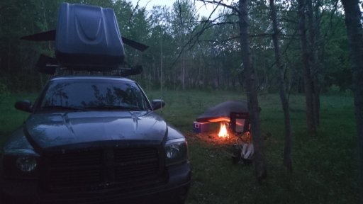

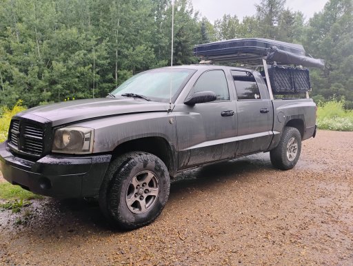

My summer season had a rather rough start. I went out for an overnight camp out on the crown land not far from home and found much to my dismay, that my tent was very wet inside and my mattress was soaked. I was extremely baffled by this, as I've had it out in heavy rains even while deployed, and never had water get in. I was forced to drag the mattress out and dry it by the fire, and wipe out the inside as best I could with the rags I had on board, and a bit of paper towel.
I checked it thoroughly when I got home and could see no way for water to get in. In talking later with a buddy of mine, he said he had the same issue with his Alucab tent, and it was caused by sudden changes in the weather producing large amounts of condensation. Hopefully a one off, but he installed vents on his tent to equalize the pressure, so I may give that a try.

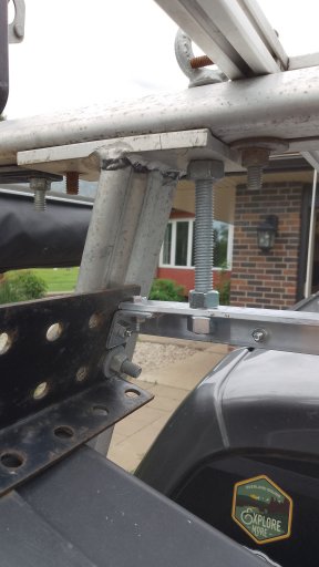

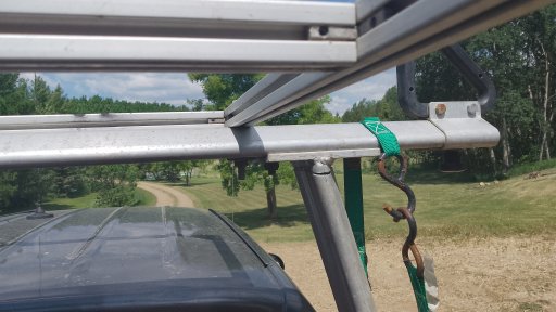

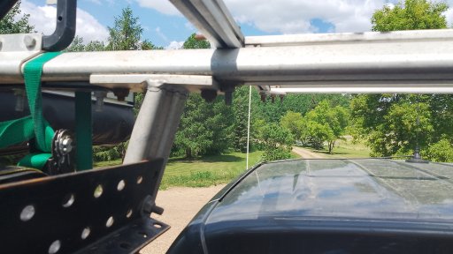

Going from bad to worse, when I got home from the trip, I realized to my even greater dismay that the two front uprights of my bed rack had cracked at the top, one completely detached and one about 2/3s detached:
In thinking about this issue and how it could have happened, I figured that the side to side motion with the rooftop tent on put too much stress on these joints. I considered several options, like completely replacing my setup with something different, but I really like this setup and money is very tight. I also considered replacing the uprights and rebuilding the custom stuff onto the new ones, but even this was $218 if it was on sale, and more like $350 if not. I figured that even if I did buy new uprights, I would still want to add some bracing to the rack to prevent any side to side motion, and thus alleviate this cracking issue. In the end, I decided to "repair" the rack and add the bracing. Down the road, if I decide to replace the uprights, the bracing can very easily be added in from the start, preventing this situiaton from occuring again. After some thinking, I drew up a design based on aluminum angle and flat bar, bolted together and bolted through the top of the cross bar, through the brace, into the upper edge of the trussing:

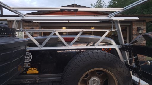

You can also see in this photo the steel reinforced expoxy I used to glue the cracked uprights back together. Not perfect, but it's something.
This photo was taken just before the last flat bar was put in place and all the nuts torqued using the trusty german torque spec, "Gudentight."
The rack is now absolutely rock solid with zero side to side movement.

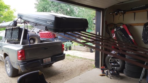

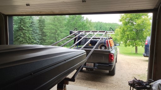

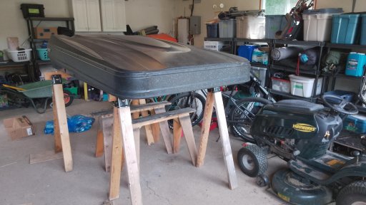

When taking the tent off, I had a friend come over and help me, but he's going through some difficult things right now, so I didn't want to trouble him. I came up with a novel solution to do it myself:
That's a farm gate we had laying around the property. I strapped it to the end of the bed rack with the blue straps, wrapped the chain around the sawhorse to secure it, and slid the tent up into position.
Cost of the repair/bracing was $90 for everything I had to buy, but that included the epoxy and a 240+ piece nut and bolt assortment, part of which I still have, so really it was less money.

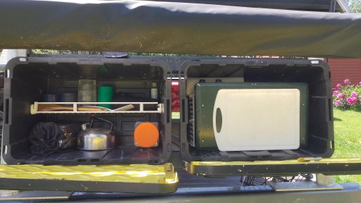

Finally got sick of the Plano case for the kitchen bin. It was just too inconvenient, always getting jumbled up, hard to reach and find things, awkward to move around, always getting buried by things in the truck etc.
So I revamped my whole kitchen setup:
Not exactly a mod, I know, because I had these bins and the shelf inside the left one for a long time, but I feel like this is going to revolutionize my overlanding. I can easily reach everything when the kitchen is deployed under these bins with the coleman stove on it. No more rummaging around in the big plano case, having the rain and dust get in etc. I might work on doing away with my Woods folding camp kitchen entirely by rigging some kind of table or bar type thing that hangs from the edge of the box when set up, as I've seen someone do on here.

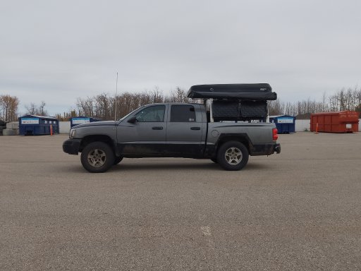

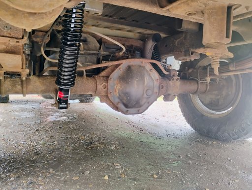

I've been annoyed by the horrid sag in the back end of Rumble for a long time, the product if extremely old, rusty, tired springs with 358k+ kms on them. I added helper springs last year, which did help some and improve the ride, but it didn't eliminate the saggy back end entirely. More recently, I found that they make these coilover shocks for the 3rd Gen Dakota, which is kind of awesome. Considering that new leaf springs would cost me upwards of $900 canuck bucks for a set of two, the 120 bucks or so I spent on the helper springs combined with $214 or so for the coilovers seems like a good deal.
The sag is almost completely, if not completely gone now, and the ride quality is even better:

Looks like she sits good and level now! Nice find!
Thanks! I'm very pleased with how it turned out. Ideally, I would prefer to put new springs, but given the age of the vehicle, the mileage and the very high cost of new springs, I feel like this is a much wiser approach in my case.
