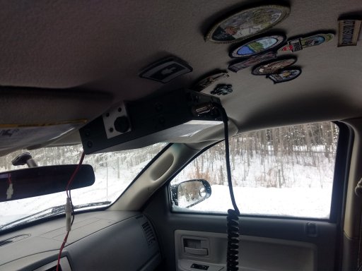

So I finally decided to hook up my CB radio. Eventually, I also plan to get a cheapo VHF programmed with the LADD and FSR channels, but I really like my CB and I'm curious if it will work better/be more popular in Alberta than mountainous BC, where its effectiveness is limited.
So I tried every spot I could think of, but honestly, CB radios are pretty big and the room in the Dakota's cab is very limited. I finally settled on removing the map lights and screwing it into the plastic frame above the headliner. There were two perfect spots to drill for the mounting screws.
Eventually I may buy some slightly longer brackets to mount this a little bit more level, but I can see the readout and controls well enough, so this will do for now. I may also try to rig up a way to have the map lights attached to the bottom of the radio so I still have the functionality.

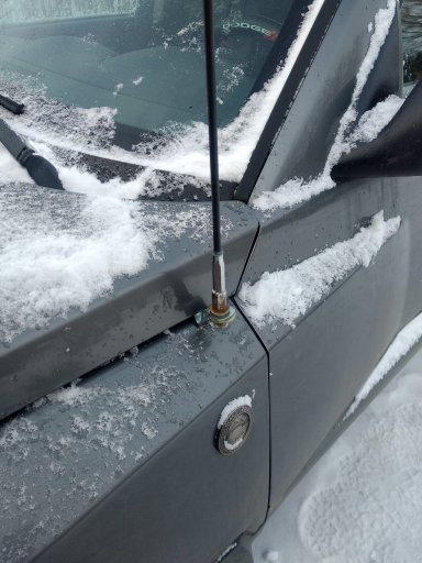

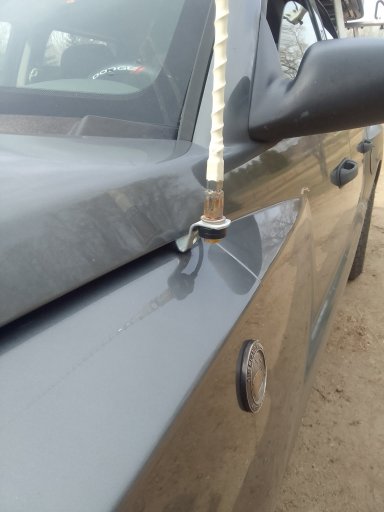

I also fabbed up a hood mount from some scraps of a broken come along I had laying around. I decided that a hood area mount was the simplest and easiest way of running the cables, so that everything goes forward instead of trying to run the cable out the cab vents behind the rear seats or something.
There's only barely enough room for the coax connector, so I may end up going with something like a firestik fire ring connector eventually, but for now this will do.
Next I have to find some electrical wire to hook up the radio to the battery, and then hook up the antenna and tune it. When I find some power cable, I'm going to park in the garage to let it all warm up before I start prying trim panels off, since they tend to get quite brittle in this -20 weather.

So I got the CB all hooked up and it works, with the SWR being okay but not great. I suspect the biggest culprit is the old coax cable I'm using. It was on the CR-V previously, and when my father in law salvaged it for me, he nicked the sheathing on the cable. I taped up the spot, but that's probably a factor in the not-great SWR. It's at least within a reasonable working range, however, certainly good enough for convoy work. Eventually I'll replace it with a firestik fire ring cable.

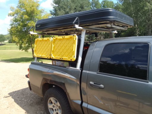

Rigged something up I've been mulling over for a while. I've wanted to integrate the CR-V table into the new rig somehow ever since I put the rack on, but I wasn't sure of the best way to do it. Finally it dawned on me that the wheelbarrow mounting brackets I've had kicking around for a couple years might be just the ticket, and indeed they were!
I just had to cut some notches into the edge of the table to allow it to fit into the brackets, but this has the advantage of preventing side to side movement, so the table cannot slide out sideways. The awesome thing is, the latch has a built in locking mechanism so that you have to push up on the table to get the latch to be able to open by sliding toward the tailgate. Seems quite secure.

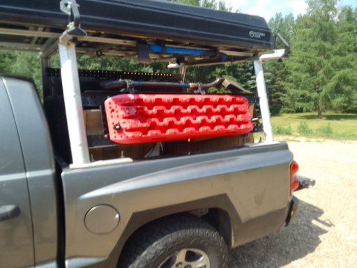

My RTT didn't come with poles for the rear facing door, so I made some. Now I can prop all three flaps open and still have some rain protection.

Well, it finally happened. My confidence overran my skill, and Rumble had an unfortunate encounter with the end of a guard rail. It was a very tight entrance into a cool little track beside a lake nearby, and on the way in I beautifully navigated around it, not touching it at all. Well on the way out, the angles were very different, and very much worse, and this was the result:
Embarassing to say the least, but I've been working away at fixing the body damage as best I can using hot glue pulling, hammers, etc. I have made some signficant progress, and while it will retain some "character" from this incident, I hope to get it looking fairly decent again.
I also added a flag mount:
And I rearranged my recovery gear to make room for some storage bins, as I find lack of storage space a real challenge:
I plan to paint the lids black and add some "hinges" to the bottom as well as probably some cords to stop the lids from going beyond horzontal when open.
