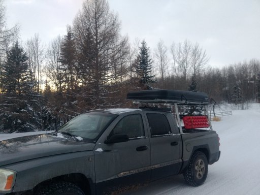

So the next mod I did was to build racks on the sides between the uprights of the bed rack to hold the recovery boards and, on the opposite side, the axe and shovel:
Funny enough, I did this in order to clear up the top part of the rack for more cargo, or perhaps, someday, a rooftop tent...
And then "someday" came a lot sooner than I ever expected. I had been considering a RTT for years, and had decided that if I ever did get one, it would be a clamshell style one, for many reasons. I always decided not to go for it, though, because of the staggeringly high cost of RTT's, with hard shell ones generally being the more expensive. One day, however, I went on Princess Auto's website (kind of the Canadian version of Harbor Freight) and discovered their already very affordable clamshell RTT was on clearance for a shockingly low price of $1235 with free shipping!
It was frankly too good a deal to pass up. Even if I were to decide that RTT camping wasn't for me, I could probably re-sell it for more than I paid. So I bought it.
It comes with the little wire arm thingies to push out the flaps into awnings on the sides as well as a telescoping ladder, a hanging organizer thing and a little rechargeable Chinesium camp lantern, which was a nice touch, I thought, even if it is a bit cheapo.

Today, I mounted the RTT, and it looks great:
I drove to town and back and found that at least up to 80kph, there's no annoying wind noise, and the handling of the truck is great. It even improved my traction in 2WD by adding some more evenly distributed weight to the back. I plan to add some vertical bars to the rack holding the traction boards so that I can bolt them on rather than using the bungees I have there temporarily.
I also plan to experiment with attaching a shallow shelf or bracket underneath the upper rack to slide the CRV picnic table into for storage.

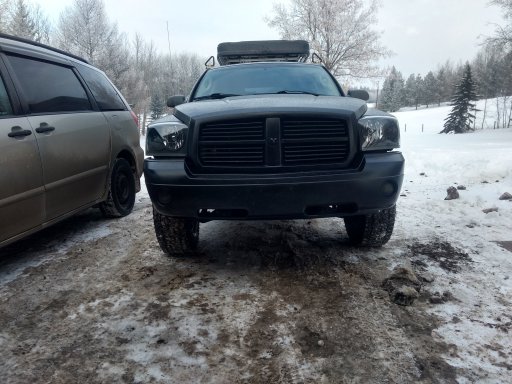

I gotta say, I'm really starting to love this truck. I've pulled like four random people out of the ditch already this winter lol I'm looking forward rectifying the front lift situation and building more on it.
Looks like I'll be getting a new bumper from the wrecker on the 4th of January, so I'll post up when that's all done.

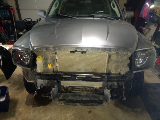

So I received all the parts last week for the repair and got started on it in earnest yesterday. Got decently well into it. I managed to get rid of the dent, rust gash and cracked paint from the driver side fender right behind the headlight:
Got the new headlight housings in and they look good:
I've got the first coat on the bumper, and it looks pretty good. should be good to go with another coat today.
The grille is giving me more trouble. 2 coats so far but I knocked it over and it got dirty, and then there's some kind of crinkling issues in spots, so I'm going to aggressively sand it today and re-coat it, hopefully that will resolve the issue. Once the painting is all done, it can all go back together.
Unfortunately I discovered that there's something wrong electrically with the passenger side front marker light/turn signal bulb, as I replaced it with a brand new one and got no result. Also my passenger tail light is out as well, which is annoying, but oh well.
I will post up the end result when Rumble is back in fighting form. Cheers!
