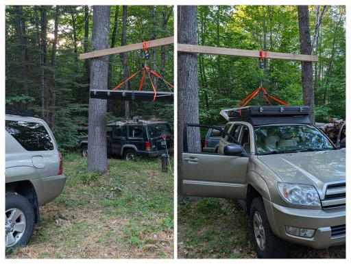

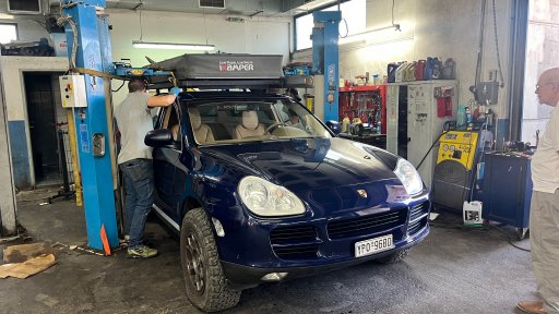

Finally mounted the CVT RTT. Took a bit of figuring. It is a little over twice the weight of my tepui ayer so not able to just muscle it up. I don't have a garage, carport, or even a handy tree so had to get inventive.

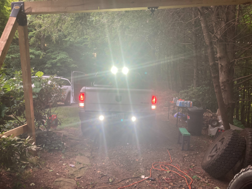

I built a lift system a year ago so I can just lift off the tent. It is a must have. I was working on backup lights last night but you can see the lift system in the foreground. oh that is also what we did last night.

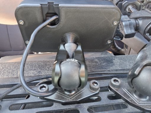

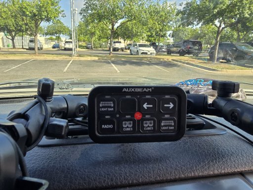

This very small upgrade has been in progress for months.
I put in an Auxbeam in May of '23, but never had a good way to mount it. I wanted it secure to my built right dash mount, and I needed to be able to reach it. About 3 months ago the idea of 3d printing it hit me. Well I didn't have a 3d printer and I know very little about 3d modeling but I know drafting so how hard could it be?
I found a few models for a backing plate for the 8 gang auxbeam and I found some models for the ram mount ball mounts. I was able to marry the 2 in the modeling software and come up with a 3d model of a backing plate for the 8-gang auxbeam with a ram mount ball on the back. Step 1 done. Step 2 was to get it printed. I didn't have a 3d printer but between my birthday and some sales I decided to get one for myself. After a week of familiarization with the printer, I finally felt comfortable printing my mount. And here it is!! It's printed in PLA which I'm worried the heat here in Texas will cause to warp a little bit. If I does I'll print it again in something like ABS or another higher heat plastic. But for now, I have my Auxbeam switches mounted on my Built Right dash panel right where I want them.
I like that setup. What are those brackets holding the 4x4? This would allow me to setup on the lawn with some flatter ground.

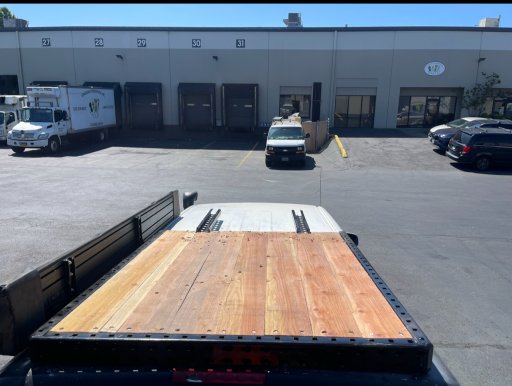

Was doing a little reorganizing at work and found out we had an extra upright for pallet racking that had just been shoved to the side for years. I needed a rack on my canopy so a little cut here , a little weld there couple of fence boards and $32.25 later I have a little rack . Not the prettiest thing I’ve made but for almost free it will get the job done 5FD567EA-5067-4759-9684-967D6041F292.jpegIMG_8044.jpeg

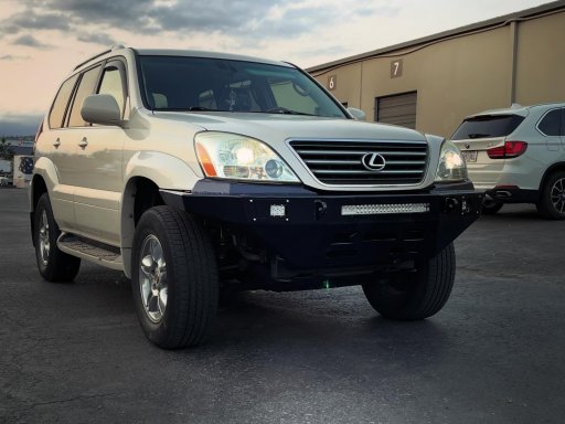

I said "No"
Backstory; Some guy parked on the side of the road in front of our house, walked down the driveway (350') and asked me if I was interested in selling my truck. Was the most random thing. :expressionless:

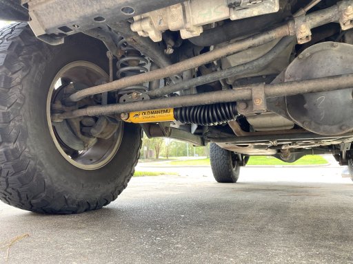

I started getting a very noticeable creak from my front end when I'd release a full left turn lock. Hard turn to lock, then relax steering and.. crREaAK. It honestly sounded like a dampener to me but when I went to my local lift shop to investigate, they told me it was all of the tie rods and front end links and most definitely NOT the steering stabilizer since those don't go bad. $65 diagnosis fee. Total repair to be ~$1,800.
Wondering if my lifetime Mopar warranty would cover it, i took it to the Jeep dealer. They said its the stabilizer and definitely NOT the tie rods and links. Also, $250 diagnosis fee. Not covered under warranty so ~$950 to replace the steering stabilizer.
So all in, I had spent $315 in just trying to figure out the creak that I could have swore was the dampener.
With this money invested, what the hell. $140 for a brand new Old Man Emu dampener, 30-min to install in my garage and Bam! No more creak (so far at least).
Lesson learned... (again).... just trust my knowledge and stop asking for other's thoughts. The amount of times I've gone to shops/dealers and argued with them on what the issue is when I turn out to be right is far too often.
