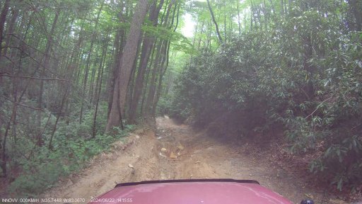

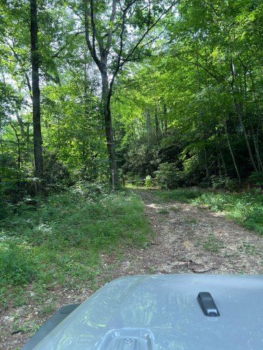

I've tried to go up Old House Gap Rd several times, but it's always gated on Mortimer end. The other end is open out of Linville, but the "Trout Unlimited" group has petitioned Grandfather district Ranger to close it because "off-roaders" were contaminating the stream for fishing. Never mind that the trail never gets closer than 75 ft to it.
What they ended up with is an 8-mile-long private fishing river.

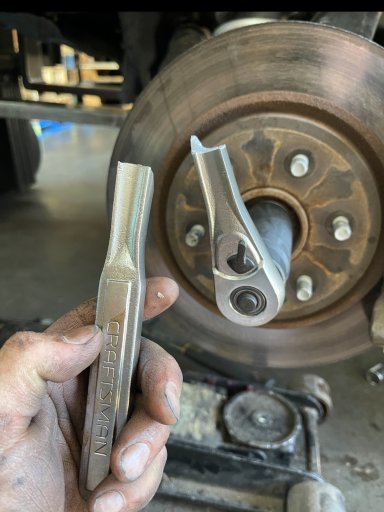

Have had an odd creeking popping coming from my front end for a while I couldn’t track down . It would only make it when driving not when cycling the suspension with the strut out , not when cycling the suspension with the forklift just in motion . Turned out it was the one piece bushing design in the upper arms that didn’t have a lot of travel before they started binding IMG_7765.jpegIMG_7766.jpeg . replaced them with some bilsstein arms much better bushing that’s greasable . Decided while it was apart I would replace all the ultra cheapy suspension parts from when I did my Titan swap with better components. Got everything mostly torn down and then realized I’m stupid and ordered frontier parts and not Titan parts ….. crap so I put it all mostly together but still had the hub units to replace while I still had things apart but my ratchet had other ideas
so after punching myself in the chest and falling backwards into a tool box I said screw it good enough and slapped it together took a hot shower and drank a bottle of wine

Sometimes ya just gotta punt.

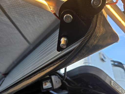

Add a set of kickass LED lights under the RTT and ran an extension cord under the bed from the back seat area of the power wagon to the back of pickup bed. I usually travel with solar power bank in the cab and one in the bed. If I am only traveling with one I still have power out back. I can use my 400 watts of solar to charge both power banks now. Kickass lights are dimmable and can be amber or white or a combo of each. Under $100 for the whole kit.

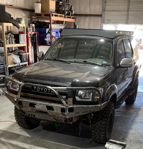

Started my Coastal Off-road man puzzle (aka bumper) on my 07 Sequoia
Finally got back on the man puzzle after a long delay. Short of some finish welds and light tabs I’ll be blasting, painting and mounting winch soon.

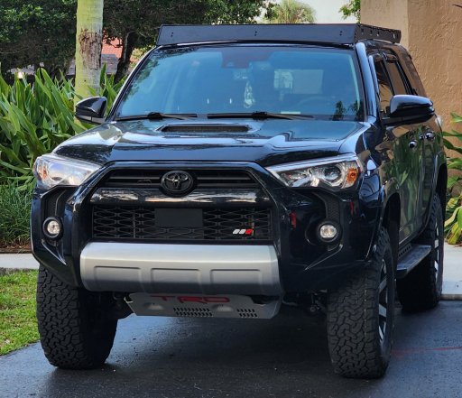

Finally got around to ordering and installing the lift, tires, and roof rack and panhard correction kit! Ironman FCP Stage 2 (3/2), new 285/70's, and a new Sherpa Crestone. Did it all in one day (9hrs total) with help from my stepson on the roof rack. Can't wait for new adventures and already looking at new accessories!
