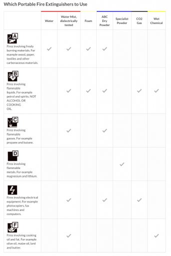

A small update/bump to this thread. I was reviewing what I had for safety equipment, I have a plastic handle valve ABC extinguisher in the back, but I want to have something mounted near my driving position in the cab as well as at the back near the cargo/tailgate area.
For dry chem type ... I have been reading that the 'A' type might not be a good idea for vehicles as it can corrode metal/connectors/electronics and when it gets hot it basically is impossible to remove the mess. Using 'A' type in an engine bay with lots of wire and connectors could actually cause MORE damage than a localized fire alone.
The other 'BC' dry chem seem appropriate but are not always as suited as the Purple K (BC) type.
I went with Purple K over an ABC or standard BC dry chem. It's the most effective of the 3 on a liquid fueled fire (and less corrosive to electronics than ABC dry chem) . I also wanted metal hardware, since I seem to always end up breaking the plastic ones.
I ordered two sizes and I will find a spot for both.
Amerex B410T, 2.5lb Purple K Chemical Class B C Fire Extinguisher
Amerex B479T, 5lb Purple K Chemical Class B C Fire Extinguisher

Purple K very well might be the best way to put out a fire, but if you want to be able to use anything after putting out the fire, it sucks huge!!
We had big Purple K's hung in each of the four corners of our new hangers. When the Aircraft Insurance Inspectors saw them they said, "you should just let the aircraft burn if you plan on using those. They will do more damage than the fire." Very corrosive and invasive.
If you are saving a life and/or structure, by all means, it is a great extinguisher. On a vehicle where you might want to salvage something, use CO2.

I wonder if he was confusing it for the type A that I was describing. (the "A" portion contains ammonium phosphate and it will digest aluminum and circuit boards in a matter of minutes. As a matter of fact you can't get it off the surface fast enough to prevent the corrosive effects) Or a mix. From what I have read, the purple K is not corrosive. Purple K is a dry chemical called potassium bicarbonate that is non-conductive and non-corrosive. It can be difficult to clean up, but that is not the same problem as corrosion.
Doing a little more reading, people still say purple k can be corrosive, but far less than an ABC. It is more effective on vehicle fires though. So take that for what you will.
I'll take hard to cleanup over a destroyed electrical system and corrosion. Pure CO2-only might very well be a better option, I will have to look into that more. I haven't seen as many co2 setups on vehicles though. The large nozzle/cone could be problematic for where I need to mount mine.
Nope, not confusing Purple K for A, at the time the hangars were built Purple K was the latest and greatest, very expensive at the time also. We still have the Purple K's at the hangar, just not where anyone can use them. As far as the corrosive effects of Purple K, I do not know, I can only echo what the Insurance Inspector said.
I do know that Simple Green says it's biodegradable and safe to use on aluminum, but further reading tells you it's not safe for aircraft because of the ammonia and the actually make an Aircraft Simple Green. Not this has anything to do with Fire Suppression, just making a point that some things we think are safe for certain conditions may not be.

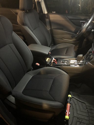

I have the element. Have not used it yet. Mounted to the passenger seat bolts in the Forester with the bracketeer mount. Fits very well and works with so many different extinguishers. IMG_1474.JPG
