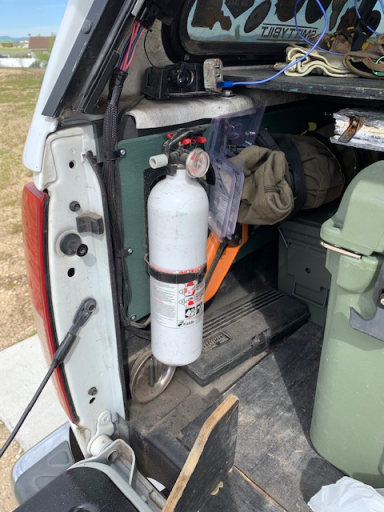

Happy to have gotten mine installed today in the back of my truck. I previously had it in its box inside of a bin. No use in there. [emoji20]

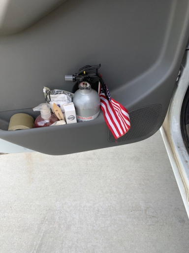

I carry a basic dry chem in the cargo area and one of the Tundras in the center console. There's really no good spot to mount any other kind of extinguisher up front so I figure the Tundra type can can give me time to vacate if needed and get to the larger one in the cargo area.

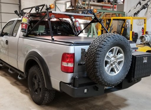

Currently, I have two rack mounted 10#ers and a small one in the cab.
