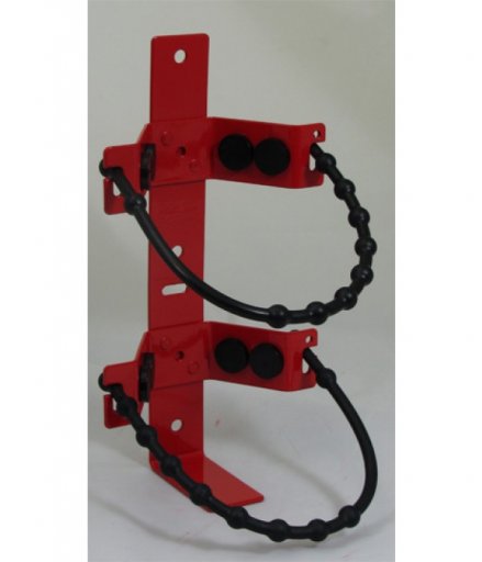

I have 3 5# extinguishers in my Willys. I have a 5# Halon (1211) and 2 5# ABC (3A, 40BC) mounted in steel brackets with rubber straps. I used to have a 5# Purple K but kept getting it and the 5# ABC confused so I went with 2 ABC's.
Yup, I know sounds like a lot of overkill. After the fire is out I have never once heard anyone complain about too many extinguishers or having one that didn't get used. Once things get to burning too much is just about right, especially if it's my stuff.
Here's a pic of the brackets I use, easy to use and secure.

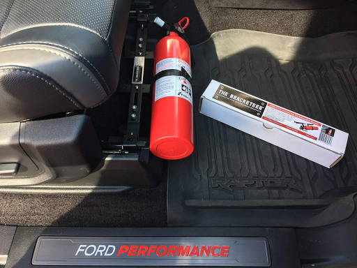

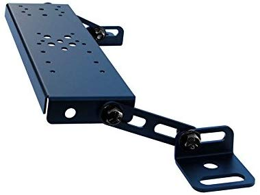

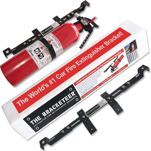

I need a good mounting solution in my Frontier. Would like to do driver’s floorboard at the base of my seat. Gotta happen soon.
1577778619494.png$59.99 on Amazon.
1577778974546.png$96.91 on Amazon.........
H3R Performance SM01BK Fire Extinguisher Seat Mount

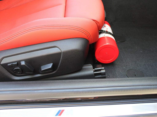

You really do not hit it with your heels, once you have the bracket adjusted as close to the seat without interference,.....AND your seat position is set for you. Allows quick and easy accessibility when you need it. I have read where people have mounted 2 (driver/passenger) using 2 different type units to tackle different fire types.
******** Saw that vidio, and have made comment on it before..........DOWNRIGHT SCARY. I think he carries 3 now, as does some on this board, for just that reason. A situation where 2 is one, and 3 might be adequate.......ERR....hope is adequate.*******
PS, Buy a metal head/rechargeable fire bottle, no cheap plastic unit.

Thanks for the bracket info!
I've seen the Bracketeer before, but not sure that it'll fit my Frontier. I've got plastic surrounds that cover the sides of my seats that wrap around & cover the front of the seat rails. I'll take another look & I'll check out that million dollar jobbie, too.

I have the bracketeer in my GMC 1500 it works well just don't slide the seat all the way forward or it will dislodge the bracket, ask me how I know!!!!! LOL

i've got a Bracketeer in my forester on the passenger seat rails. fits perfect. i suggest it. mega easy install. i also have some plastic tabs on my rails and they dont get in the way.
Yeah, Wifey's old (2011) Forester rails were a LOT different than my Frontier's. I'd have to cut plastic trim off and I'm not sure I wanna do that (yet).

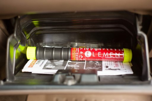

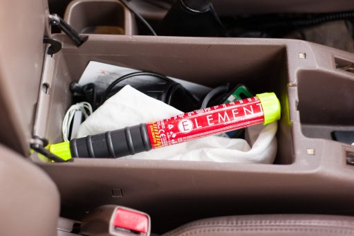

I have been a dealer of the Element Fire Extinguishers for a couple years and am a huge fan. This technology has been around for a long time and is especially popular overseas. No mess, no expiration, easy to stow and no need to refill. I keep mine in the glove box or center console.View attachment 134308View attachment 134309
i really really like this solution, incase of a roll over that your so messed up and cant get a fire extinguisher or something just incase.
