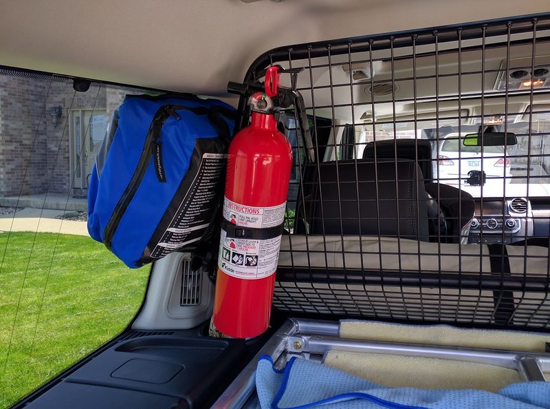

Great write up. I always carry a fire extinguisher in my JKU. I should probably get one for the GC as well just to have.

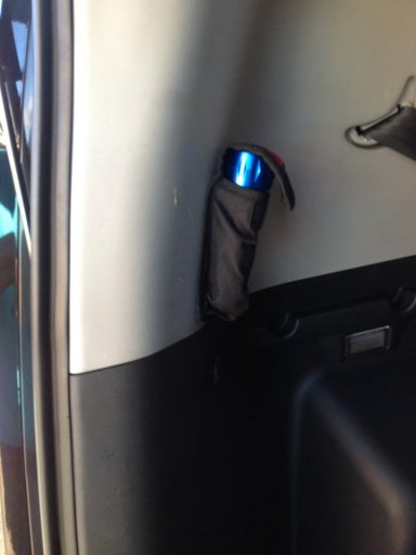

where do you mount yours. Im able to pick up a 10 lb general ABC for free. just wondering where to mount it safelyGreat write up. I always carry a fire extinguisher in my JKU. I should probably get one for the GC as well just to have.
I have a small automotive fire extinguisher mounted to my rear passenger side roll bar. I believe the fabric holder I use to keep it in place is from Rugged Ridge.where do you mount yours. Im able to pick up a 10 lb general ABC for free. just wondering where to mount it safely
I agree with having more that one unit and one being able to reach while you are inside.I worked for a Fire company for the last couple years, 5Lb ABC can be had for less than 40$, cheap insurance policy. put a 2.5lbs under the seat, and then a 5 or 10lb in the back, so i can start fighting the fire while my wife gets the big guns, i also recommend that you get one with a Hose/Nozzle, then you can pop the hood, stick it under, and pull the trigger, instead of having to open the hood all the way.
