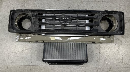

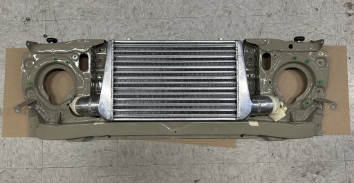

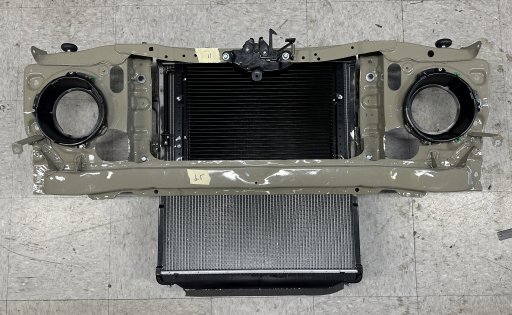

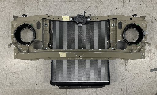

What a great build...totally professional...that goes for your documentation as well. Looking fwd to watchin' it all come together.Just got the Terrain Tamer radiator. The radiator mounts will me modified to mount on the narrow nose 70.

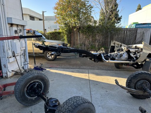

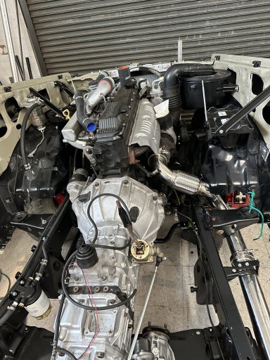

We were trying to figure out the 6 lugs conversion. ALL worked out on the rear axle except the flange of the rear axle shaft is 104mm in diameter, and the hole in the center the wheel is 101mm. It can all be assembled but the wheel will not mount on. It can all be machined, but at that point there are too many custom parts and I hate getting stuck somewhere and looking for a machine shop on top of a Toyota dealer... Decision to stay with 5 lugs.

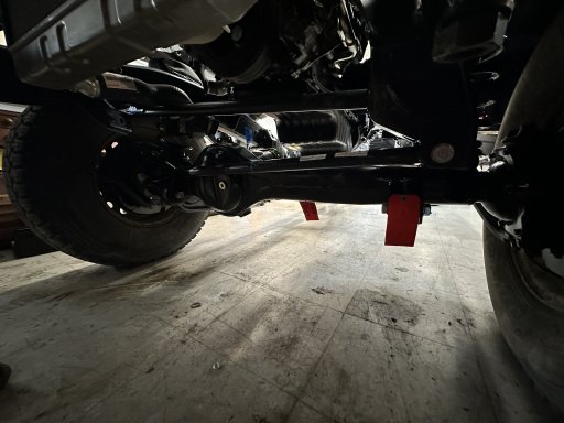

I decided to go with BP51 shocks.
View attachment 248284View attachment 248324
