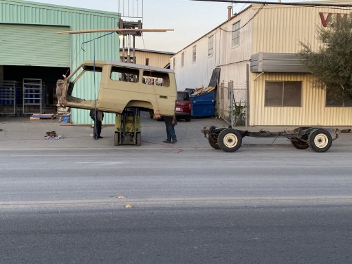

Spent the weekend in Death Valley with the 80. Coming back, it's like Christmas. Body is coming off the frame in a couple of weeks.

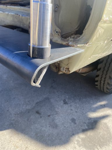

Today I worked on the rear bumper. Started to assemble and in no time we burned away all the day light. Amazing how quickly time goes by when you are having fun.

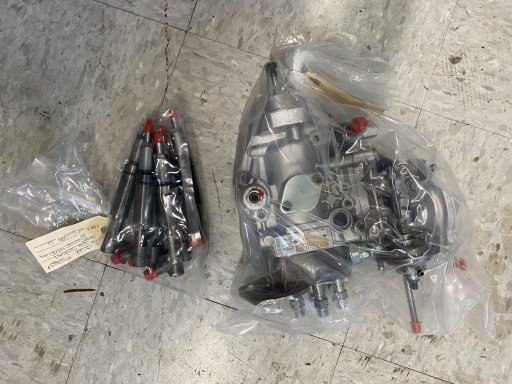

Made it to Flagstaff leaving at 4AM and getting there at 7PM. Kelly Saad from Landcruisergrills will do the body work. He will also create a metal grill for the troopy.
The IP and injectors came in from the shop in Portland. They look new. Keil and Mark did a magnificent job. I've been using this shop for a while. Their price are very reasonable and the work is professional.

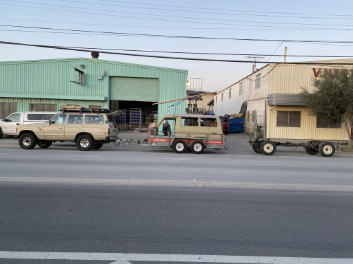

Juggling parts of one vehicle. FLYBOX, the diesel 60 has been working hard this week. Managed to tow the frame with a dolley back to our shop. Uhaul asked what vehicle I am towing. I said Prius, and it was too big. Then I tried Yaris and it worked. They even asked the color - WHITE!
I can start modifying the frame for the drivetrain. Once done I'll deal with the suspension coil swap.
Also today did a vehicle registration in Arizona. We own property there. California does not want our money I guess. They will not register this vehicle.

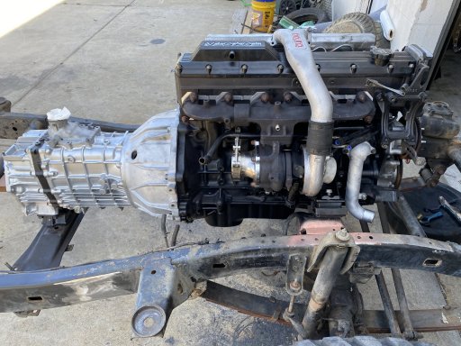

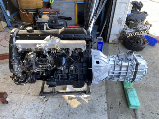

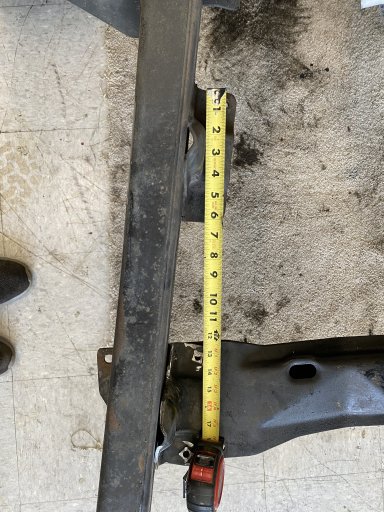

A bit of progress this weekend. Finished the engine except the flywheel. Installed the IP and injectors as well as the exhaust manifold.
For now mounted the tranny so the cross member on the frame can be placed. Removed the gussets on th outside of the frame (very carefully so they can be reused). The cross member has to be moved back a bit more then 13" but the frame widens toward the back. I would like to reuse it, so I'll weld 2 1/8" plates on the edges to widen it and drill 4 x 10 mm holes on each side to attach to the gussets at the new location. You never know, until you try it...

Ended up getting a 1/4" thick steel plate ($13.45). I guess price of steel tripled since last year... This will extend the cross member and allow me to use the gussets in the new location. Sand blaster is not working this week so I used the wire brush to clean the weld spots.
