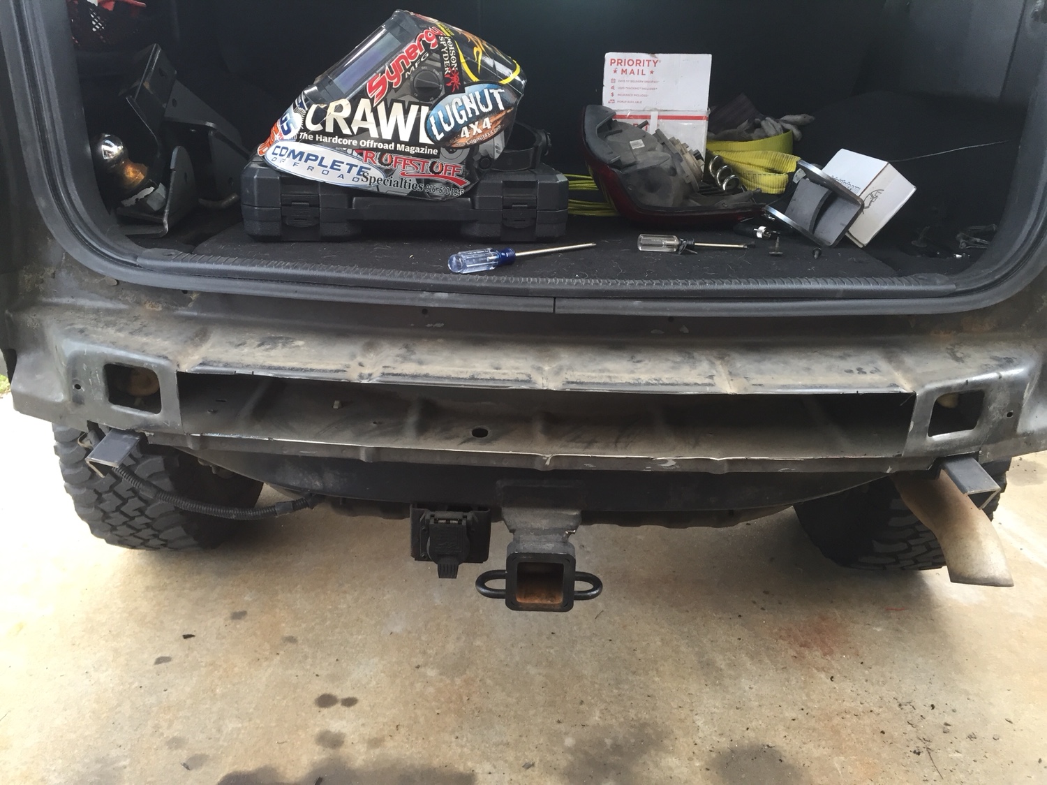

Going to make a build thread to document building my swing away tire carrier on my 03 Overland. I’m planning on cutting out a part of the rear crossmember to weld in doubled up 2x2x 3/16” square tube to strengthen it that area and weld through shackle mounts. These will stick through the stock bumper cover. The spindle will be on the passenger side with the latch on the driver side. The tire is going to be offset closer to the spindle for weight stress purposes and on the left I will make a cargo rack eventually for jerry cans, water or whatever else. I would like to have the spare tire angled to the rear window with enough room under the tire to install the license plate light and plate. I might have enough room under it with the tire vertical but won’t know for sure yet.

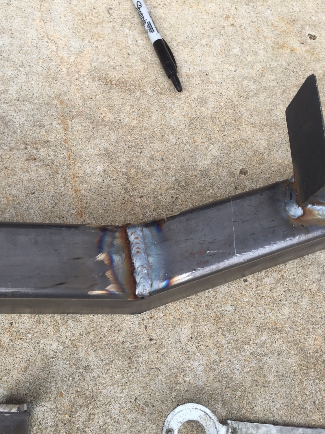

Worked on the tire carrier some this week. It’s been slow with the weather but so far so good. The angle is welded to the hitch mounts and the 2x4 will be welded to the angle and tacked to the crossmember. The bumper cover still fits over everything so that’s a big plus.

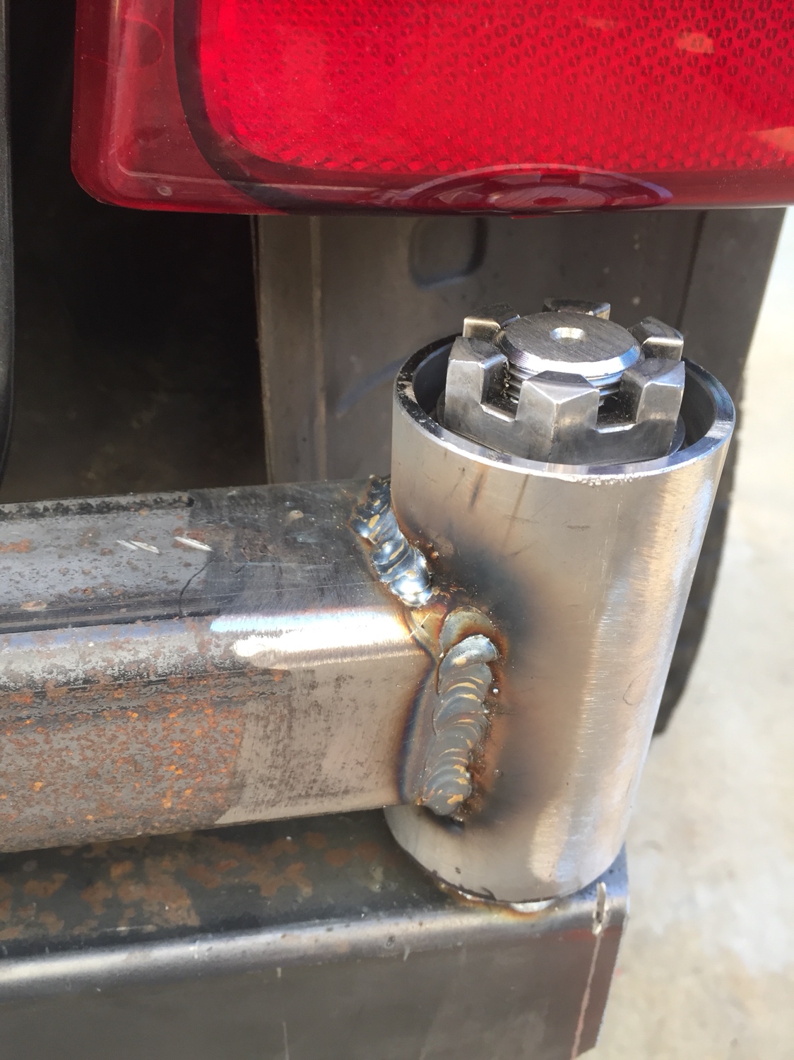

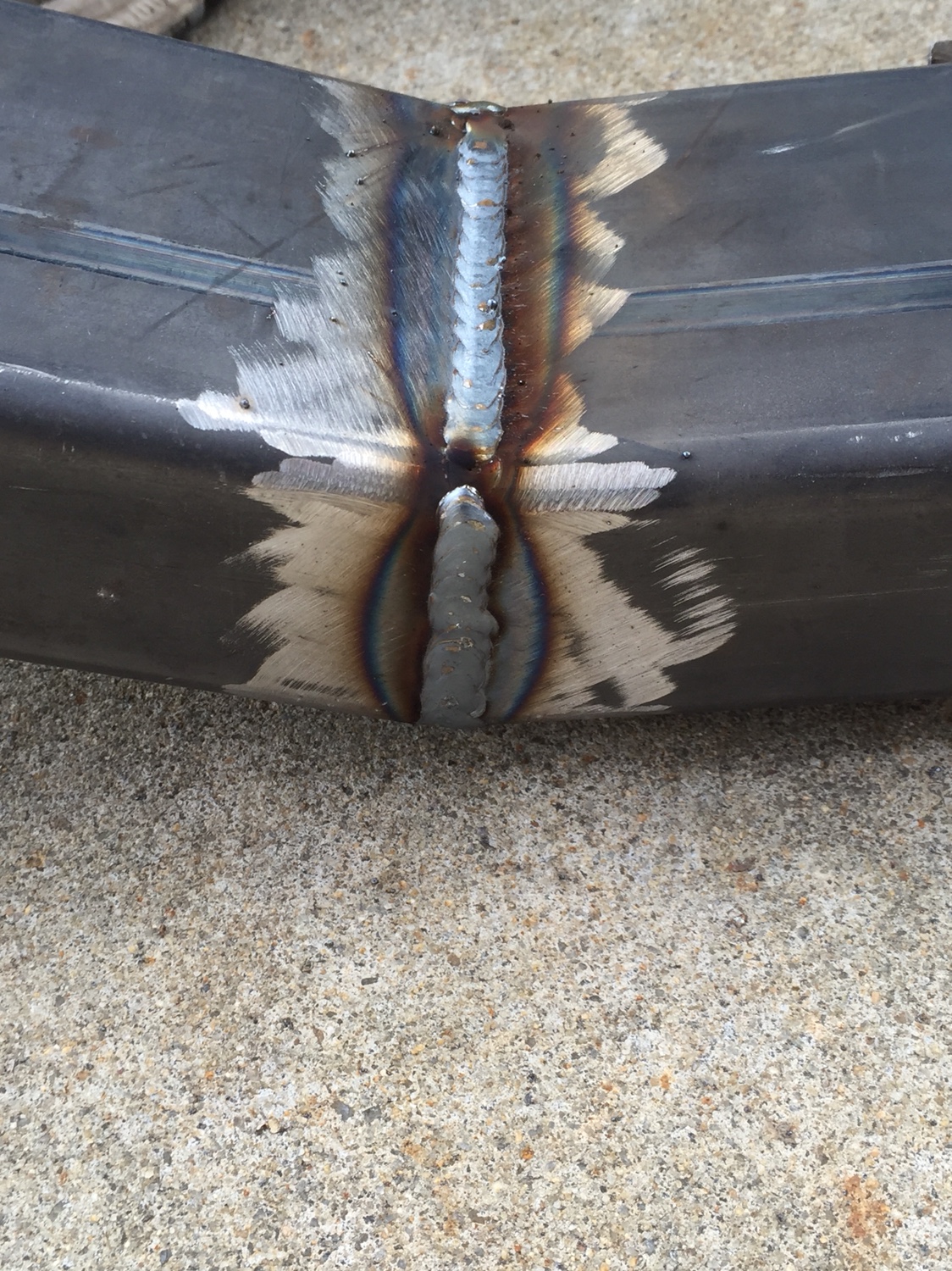

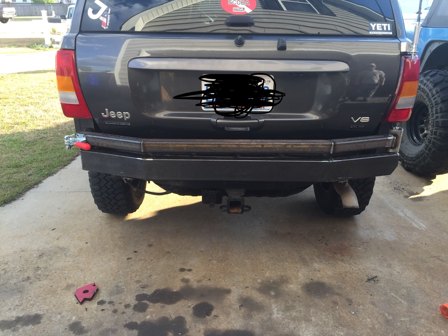

Update on the tire carrier. Burned in mostly everything. Test fit everything and the 2x4 clears. The spindle is welded in and the swing out arm follows the same lines as the 2x4.

Just one observation, try to locate the tire as close to the pivot as possible, in this way, the horizontal load on the support would be less. however, it would block you more the vision of the mirror, if you have any.

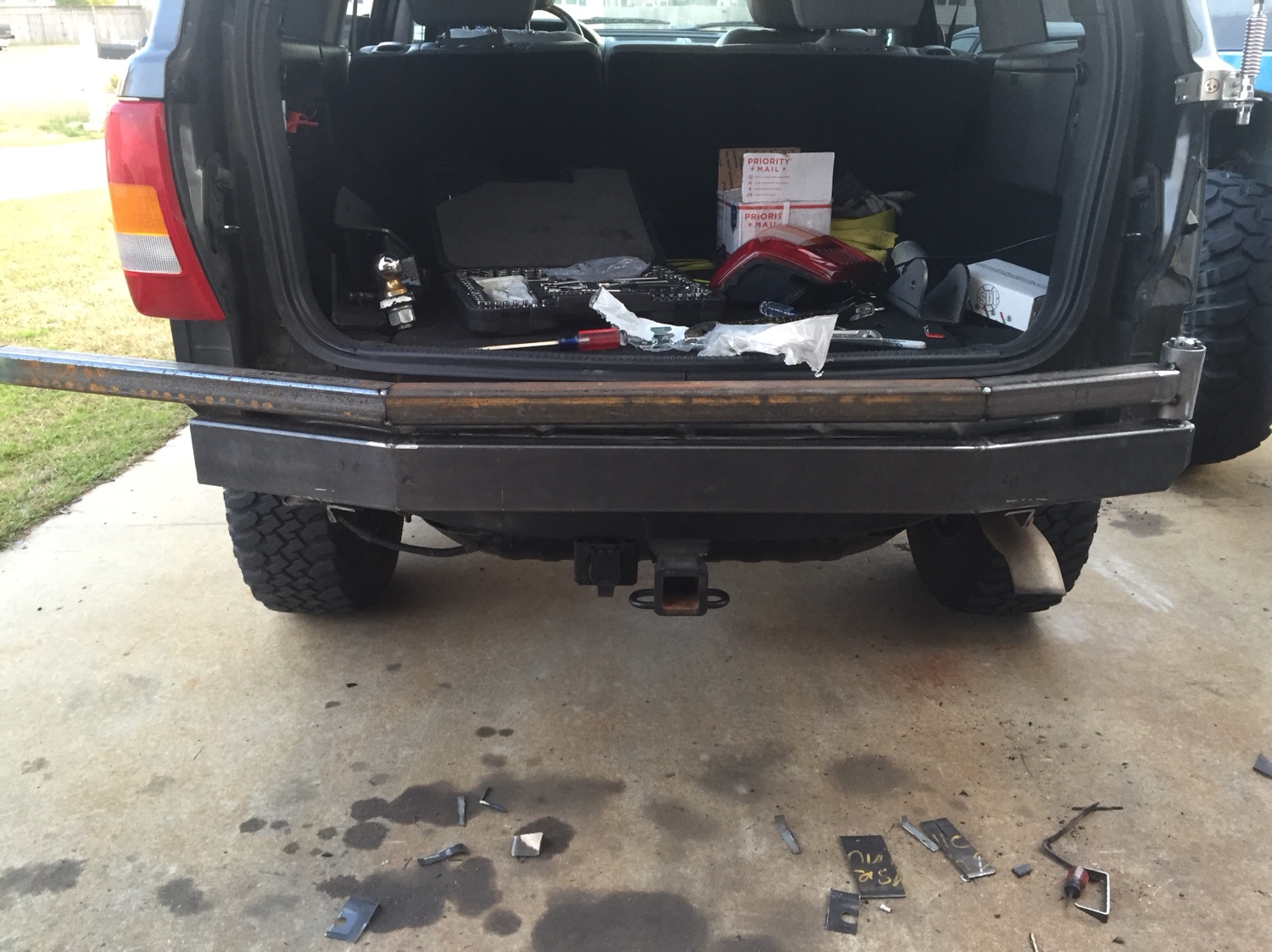

Today we fabbed up some brackets to mount up the isolator and latch and burned in everything. We also drilled the holes to mount the bumper carrier to the hitch. This allows the whole thing to be removable in 1,2 or 3 pieces. The swing arm, 2x4 and the hitch are all independent but tied together. Here are the pictures from today. Any questions please shoot.

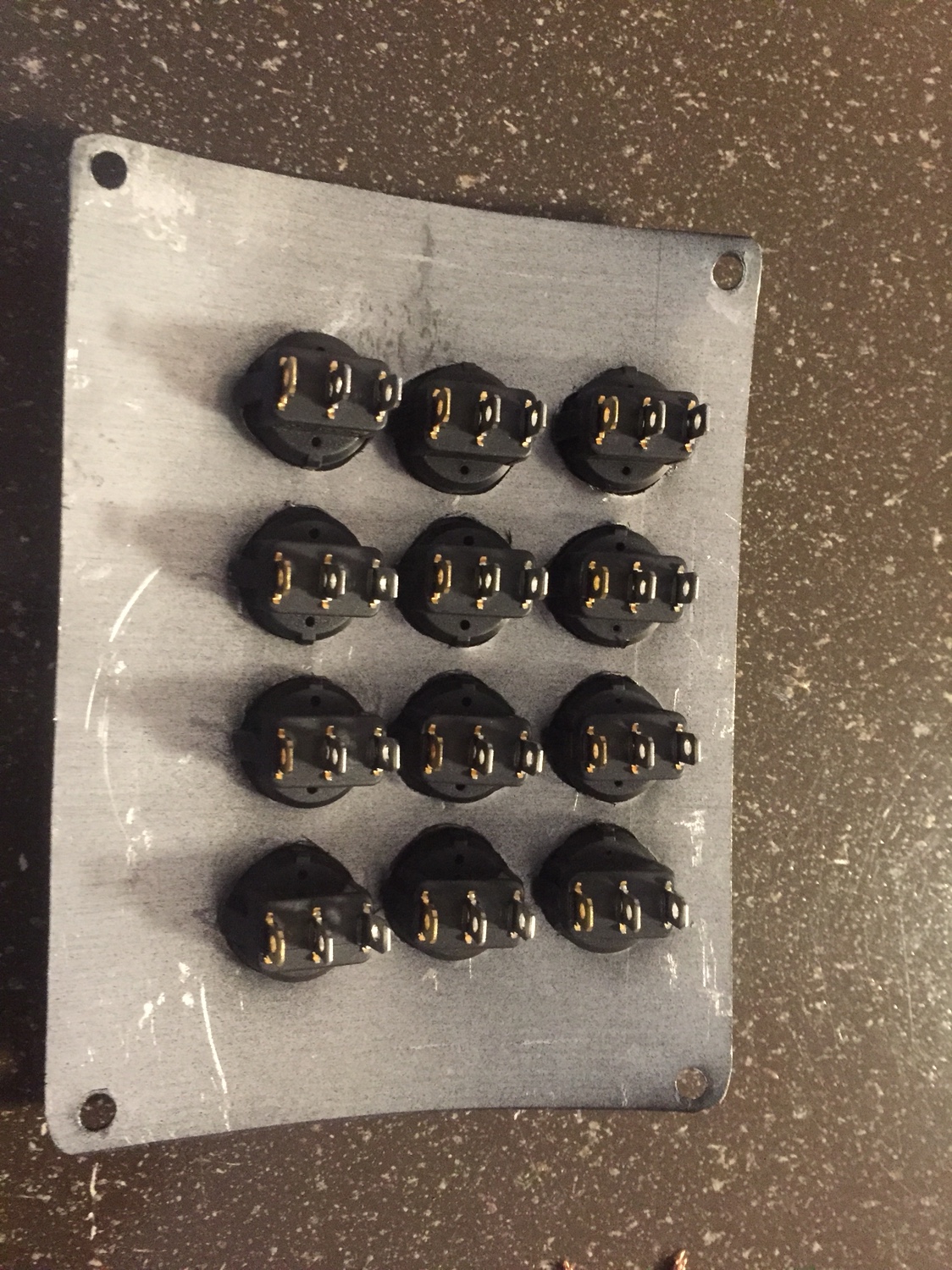

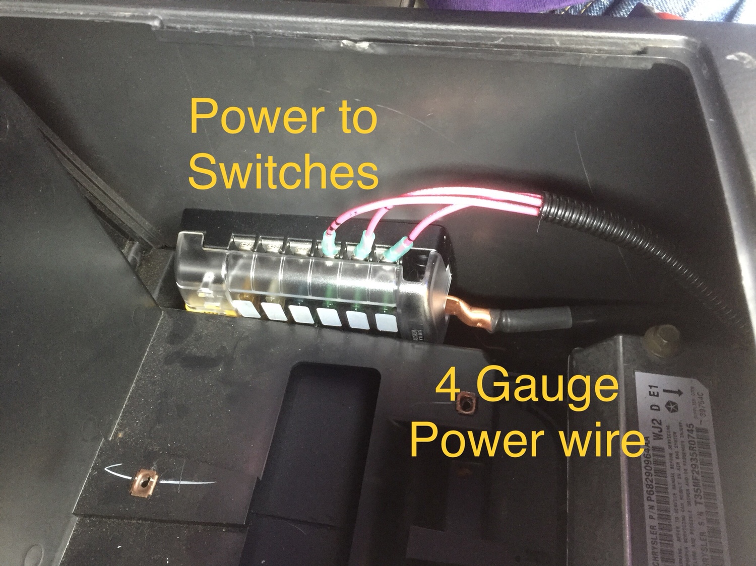

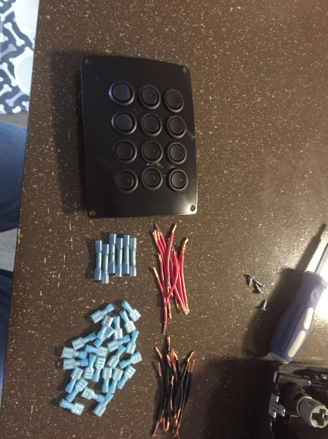

Lately I’ve been working on the tire carrier but the other day decided to improve me electronics/accessory wiring so I pulled all the wires that I ran initially and built a switch plate for the little useless cubby. The plate is just aluminum and I got the 12 switches on eBay. They are going to be be powered by a Blue Sea distribution block that I just got in last night.
Question for anyone with knowledge of electronics... the switches say 20A on the side. I have 3 rows of 4. Each row is piggy backed to the switch beside it. Does this mean for 4 switches they draw 80A?
tsteb112
1,212
Greenville
yup, 80A will be the max. Amp. Output for row.
But you can put a 60A Fuse, to keep it safe at 75%.
After talking to a few others they have said that the switches can handle 20A but don’t require 20A because they are just lighting the little LED indicator. If I’m running something that has more than 20A I’ll use a relay too
Of course, if you connect a aux fan or a compressor you will require at least 15A and you will need relays!
Even for the light, I used relays, just to be safe.

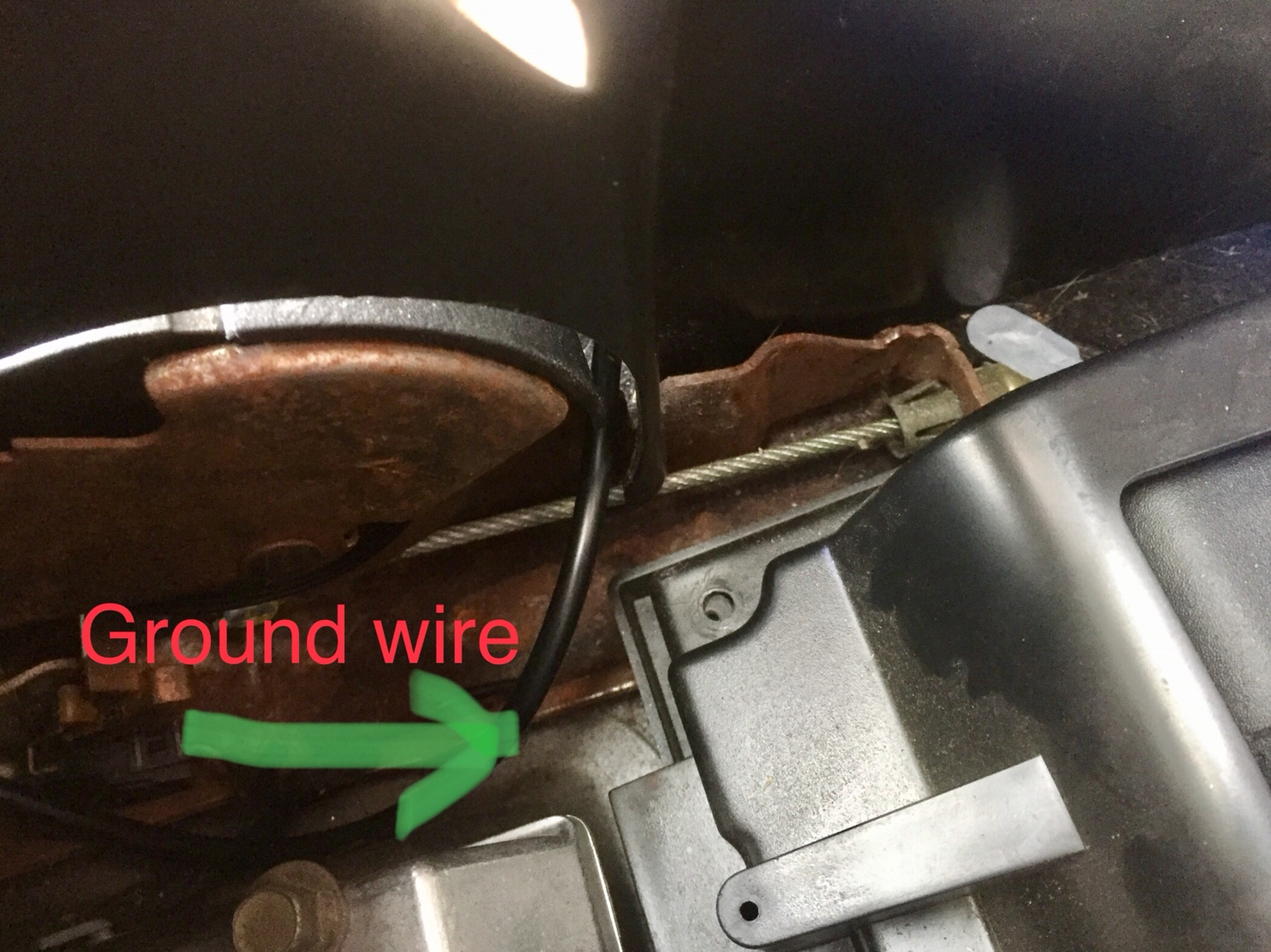

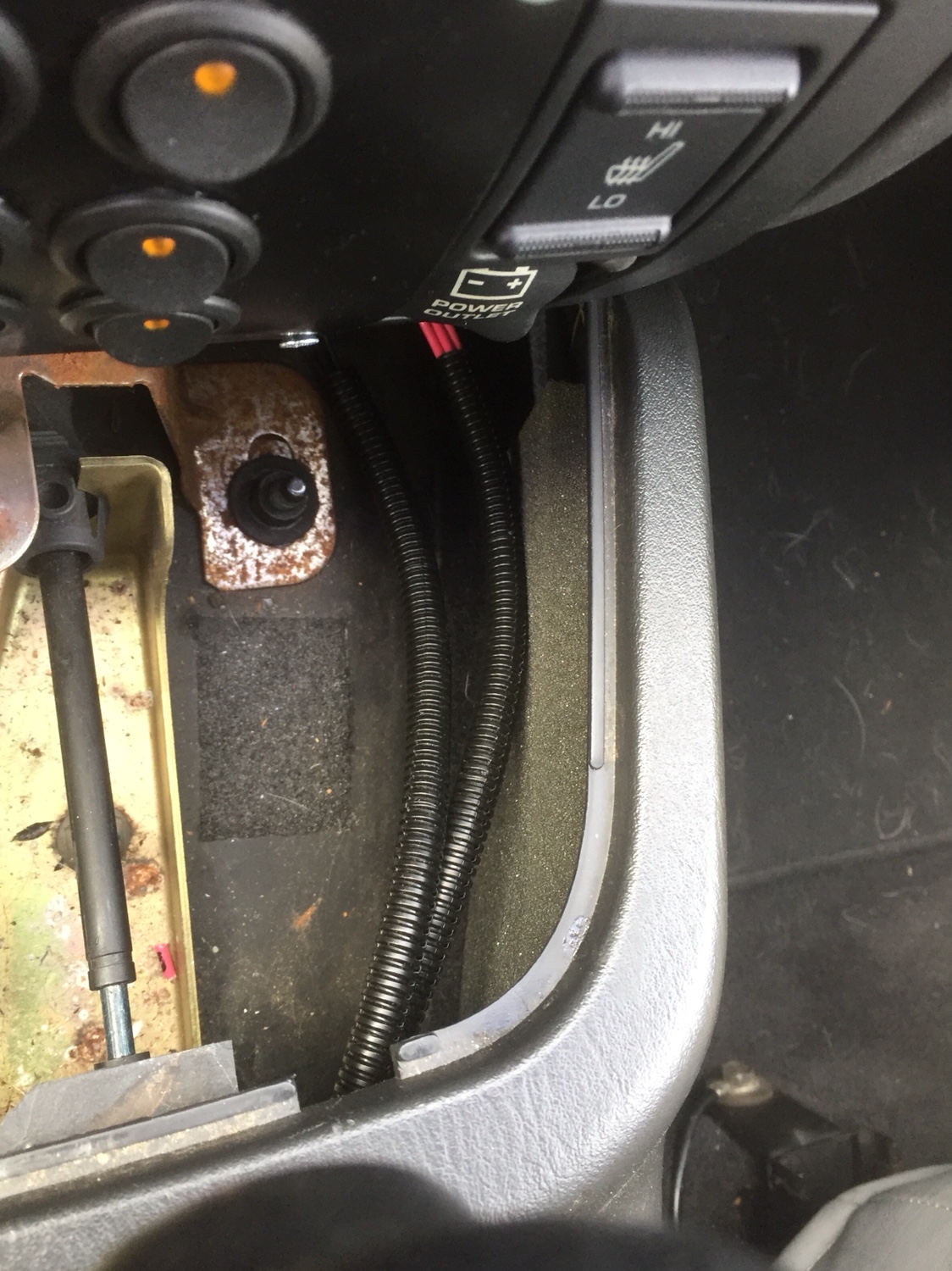

Worked on the tire carrier and wiring up the switch panel and fuse box yesterday. The box is going under the center console where there is an empty space. All wires run through the transmission tunnel. I just need to ground them and I’ll be good to go. I’ll post pictures when done.

Today I finished up the switch panel. The fuse box is under the center console. The power wire to the battery I ran through the grommet by the brake booster. All the wires are run through the transmission tunnel.
