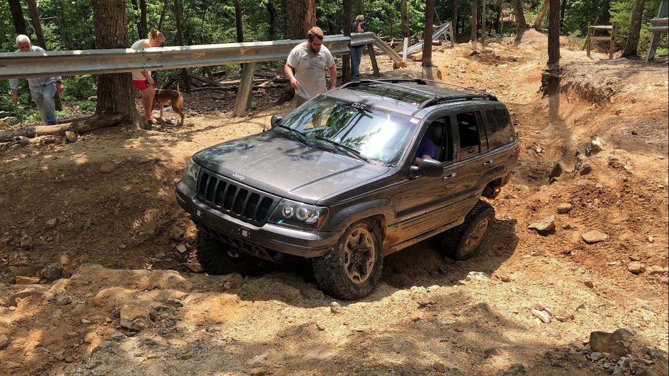

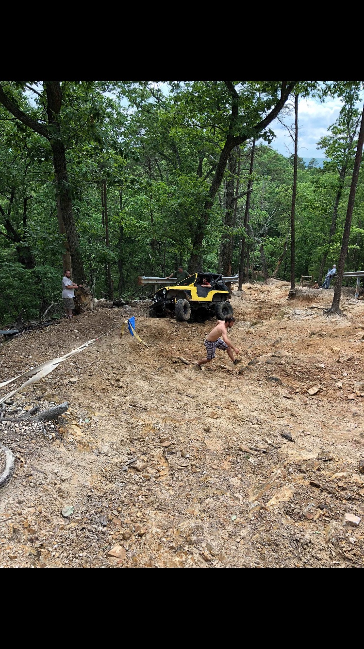

This last weekend went wheeling/camping to Uwharrie National Forest for the first time this year. The trails were definitely more washed out with more exposed rock than I ever remember in the last few years I’ve been going. Without further ado, here are some pics.
