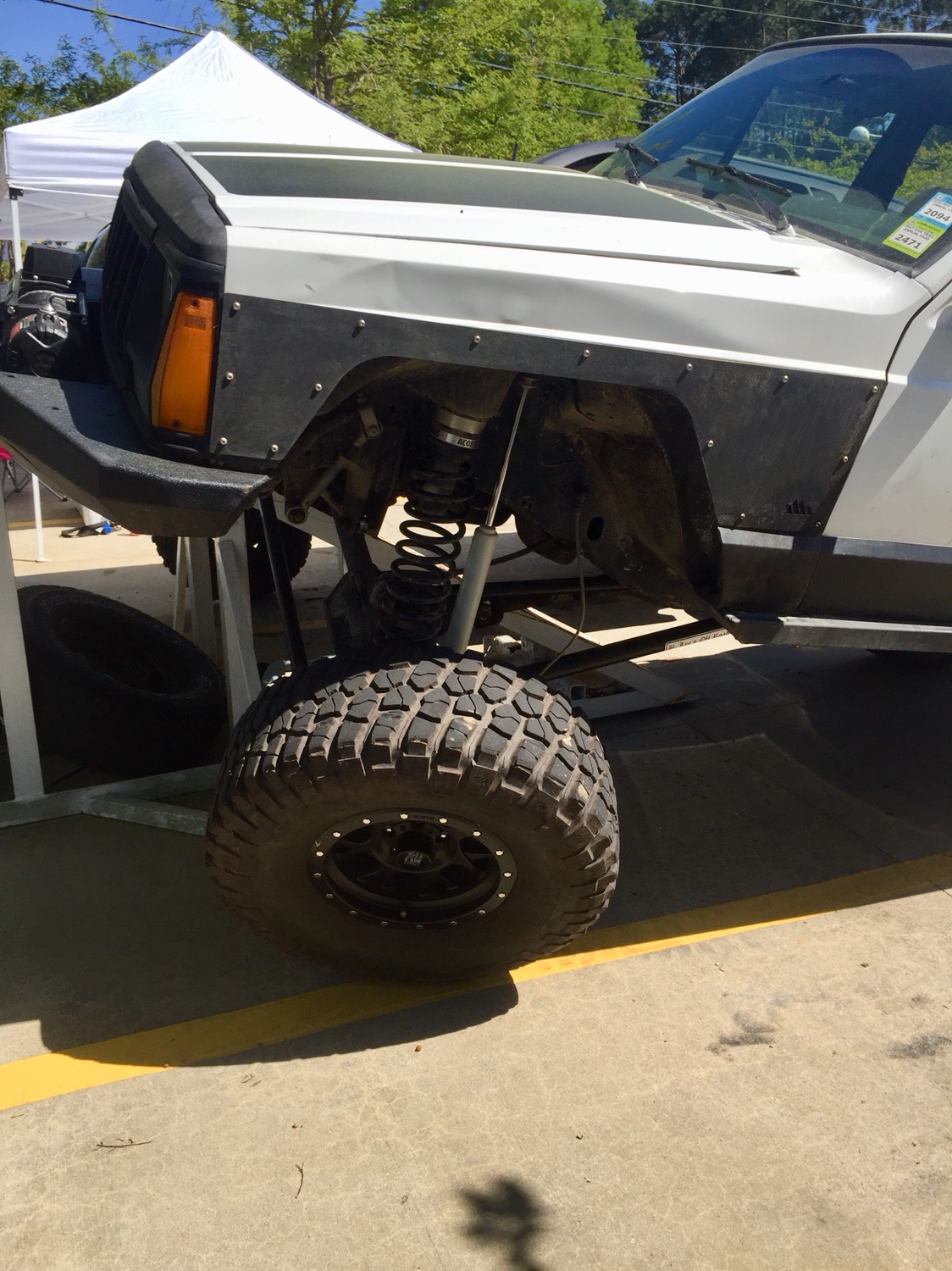

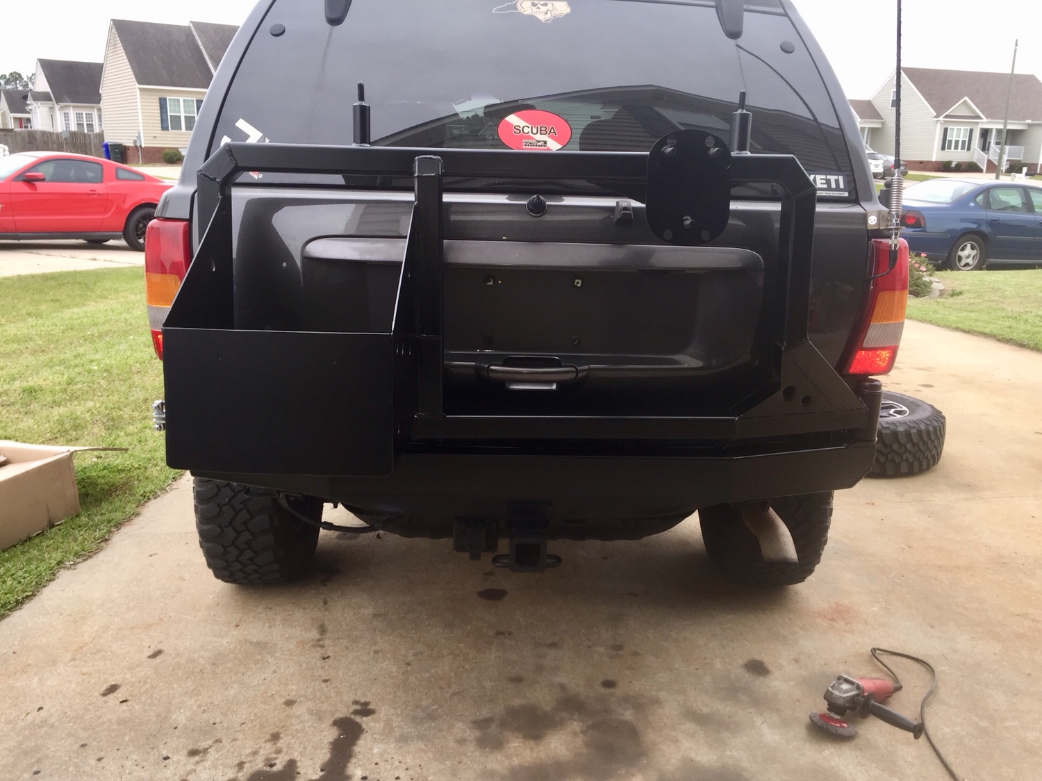

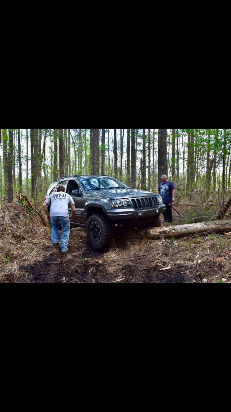

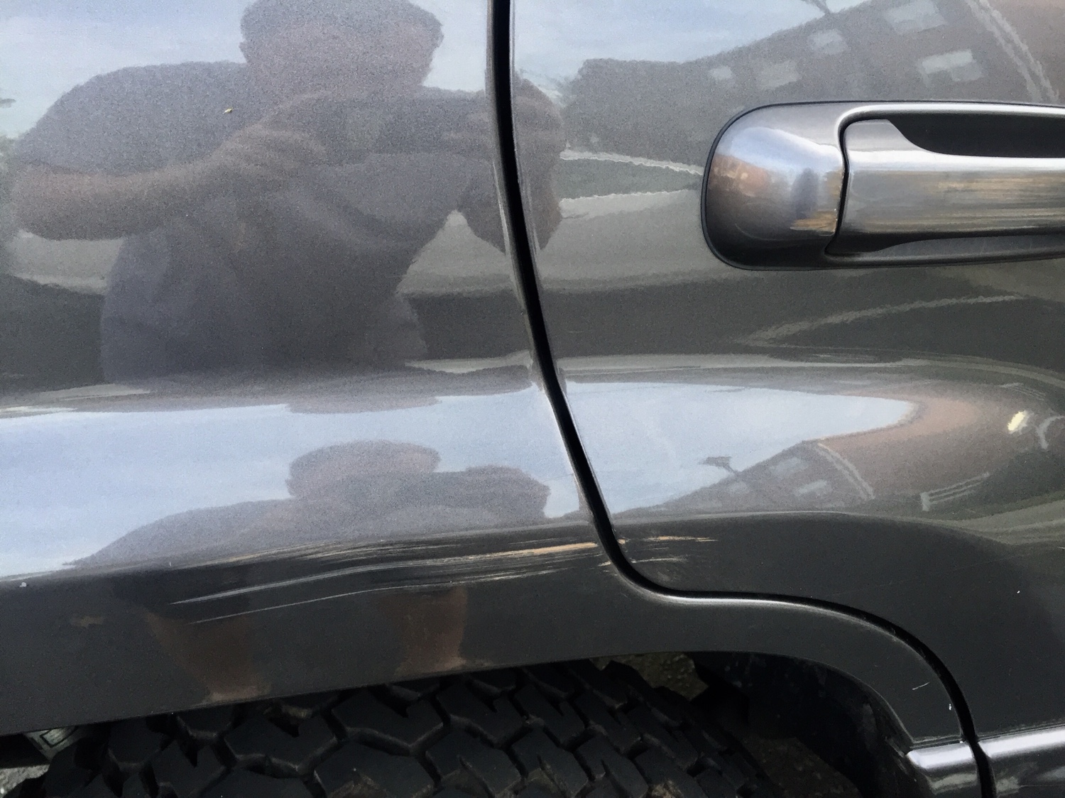

Went wheeling for the first time in months on a friends private property. We are currently making trails through woods on his property. Some of these were very tight for my long wheelbase wj and I made some contact with a tree that we later cut down. It should buff out though.

Nicely done! Honestly you could wrap the tube around the sides and not even need the original bumper. It looks good without it. I like the build. I have been debating the DIY bumper build and this gives me hope of a good outcome. Thanks for sharing!

Thanks for the comments. We are debating on making plates for the sides, just not right now. I have about $350 or so in material I think.

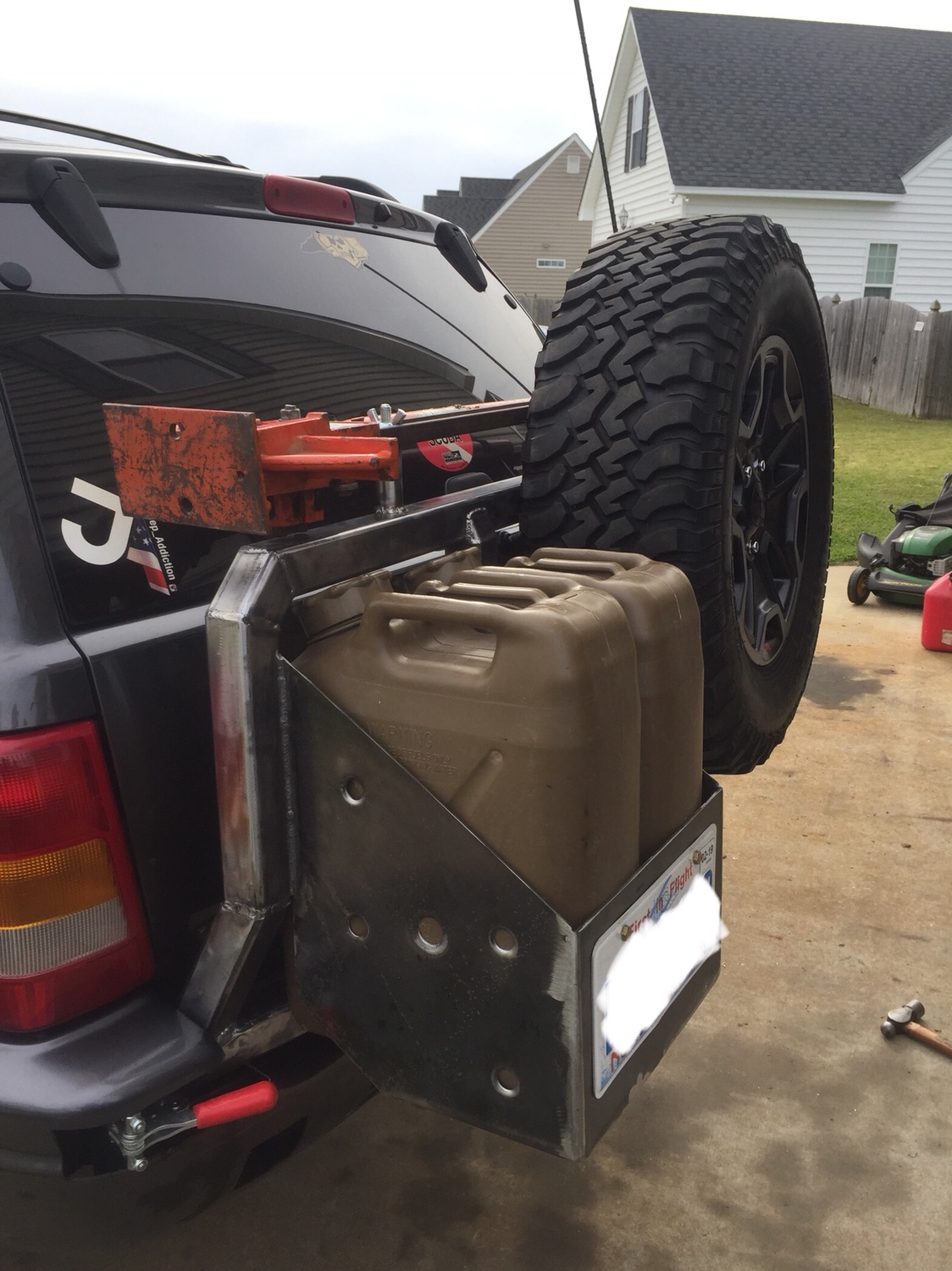

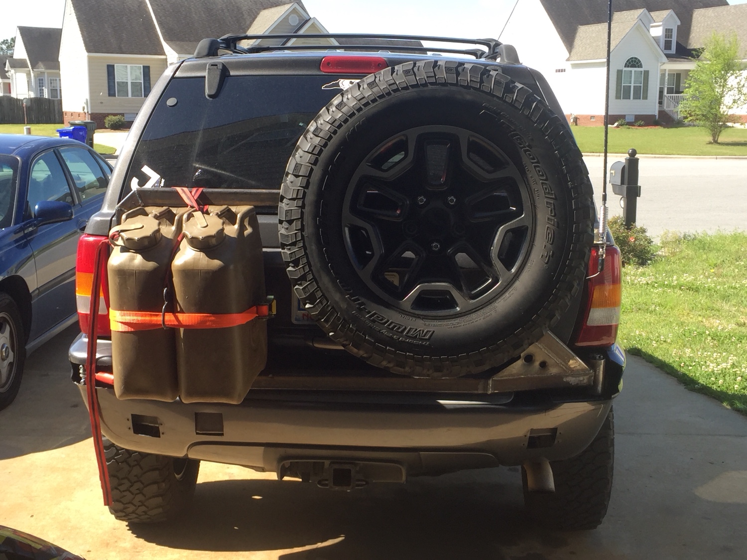

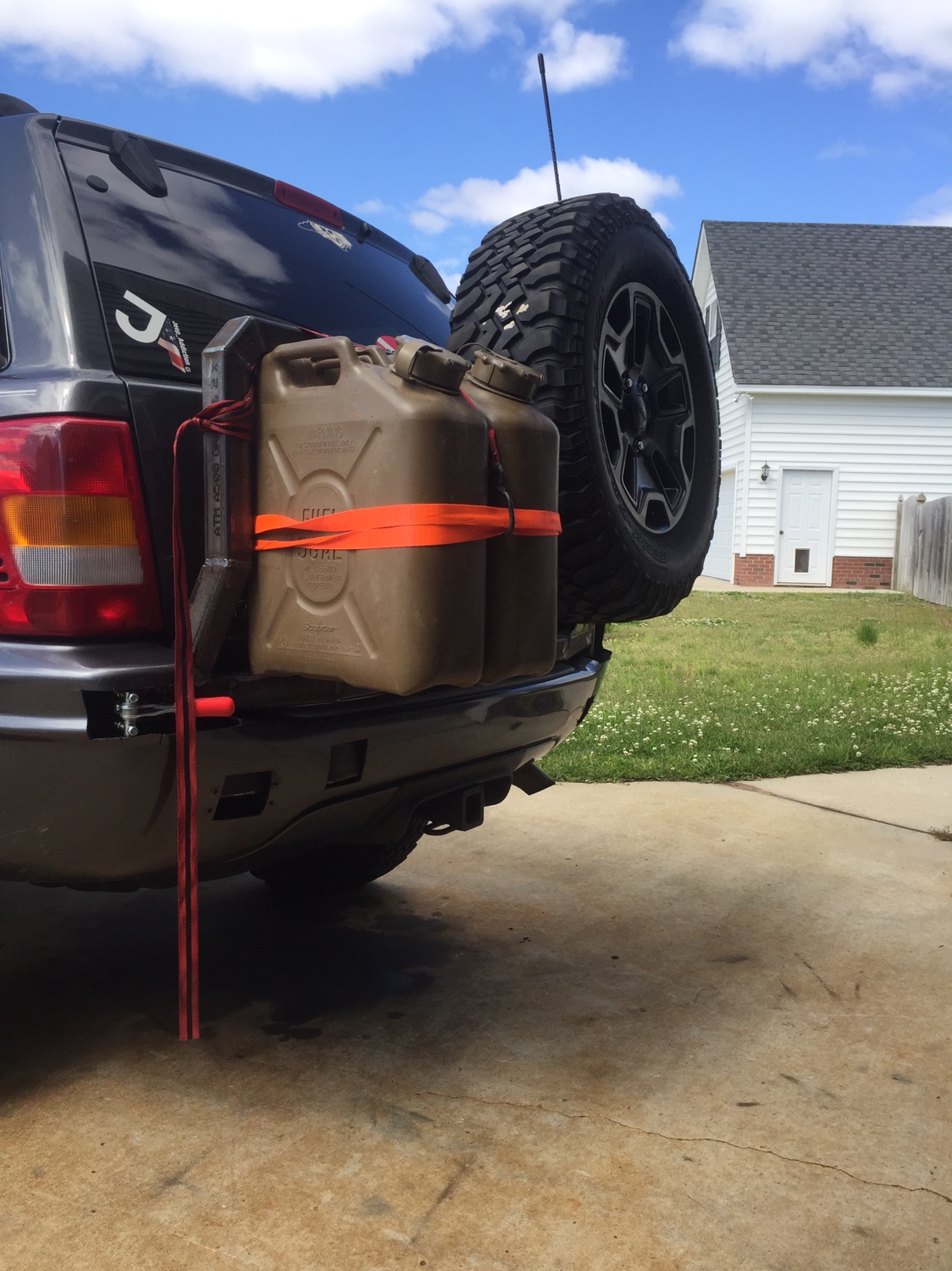

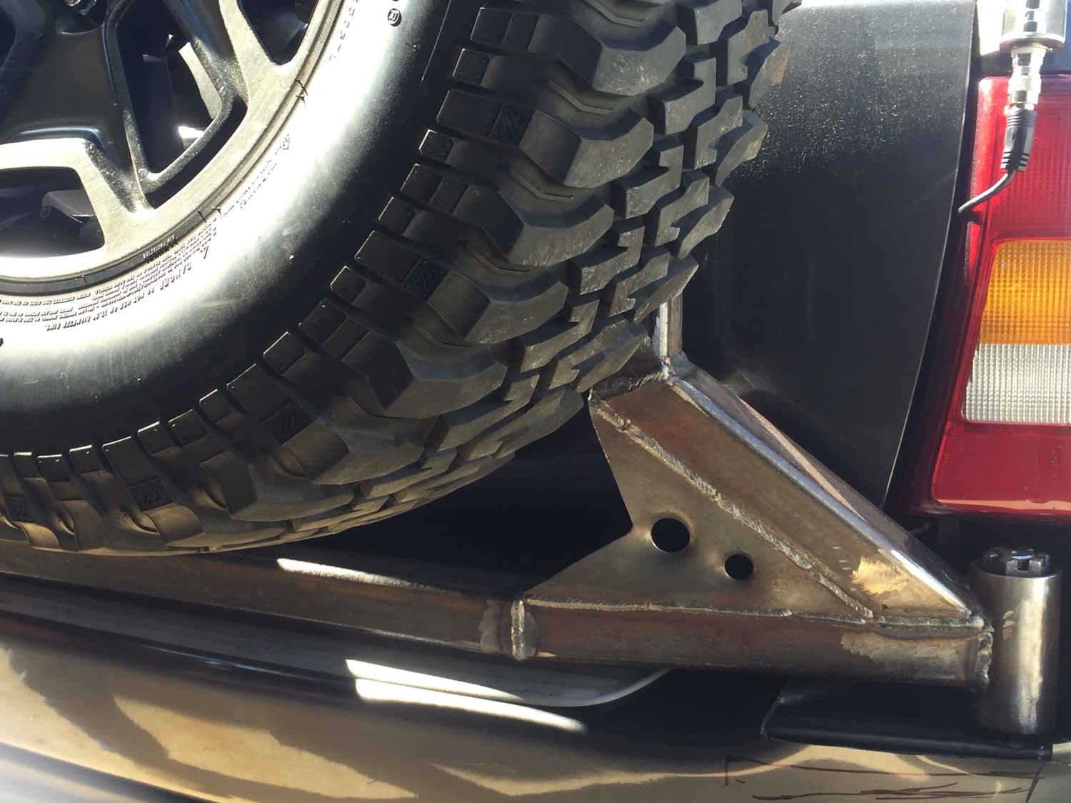

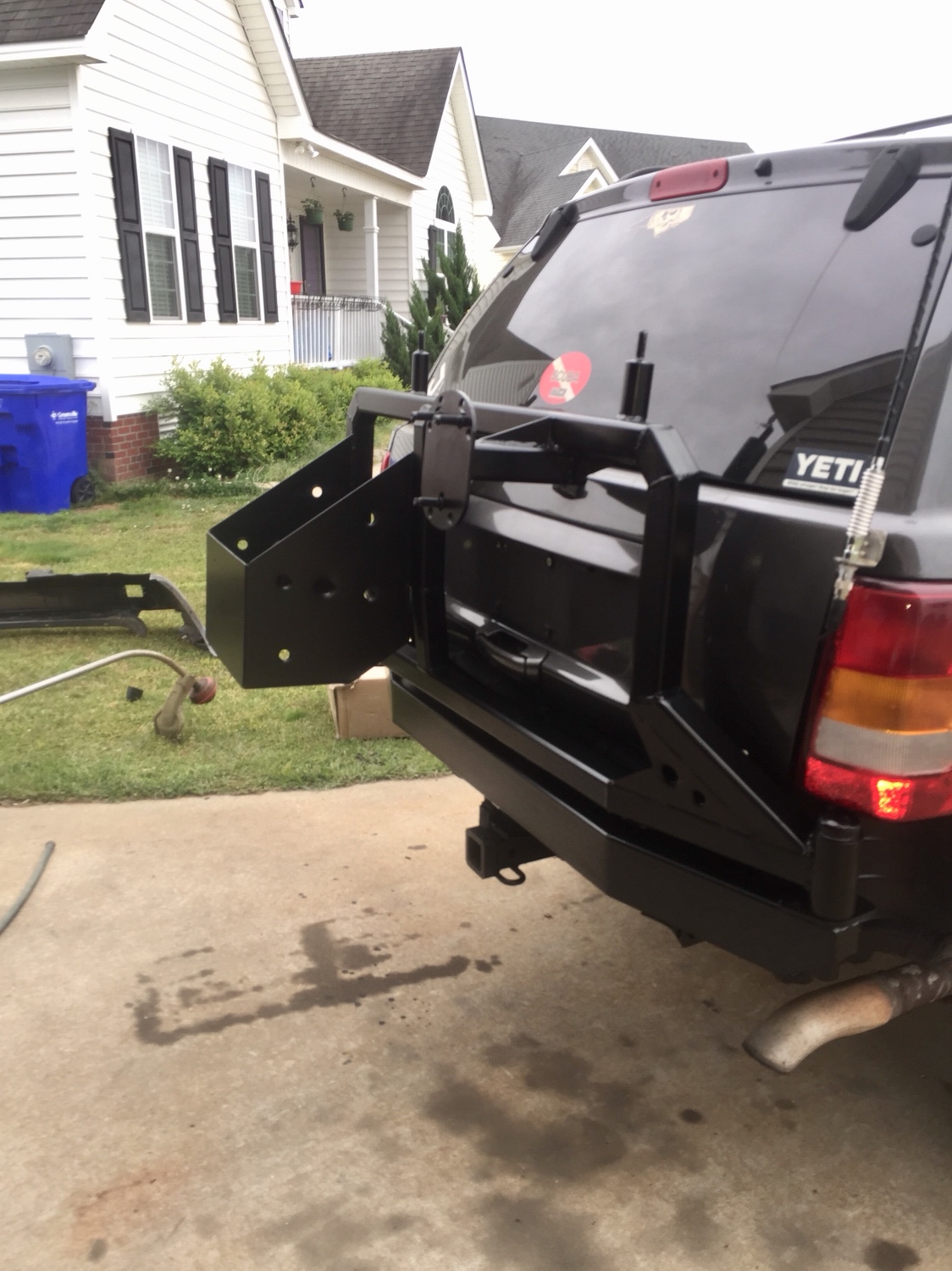

Alright it’s all done minus the highlift rack and paint. It bolts on the left and right sides under the taillights through nutserts. We used 5/16” bolts. 3 on the passenger side, 2 on the driver due to interference issues. The bottom are 9/16” bolts I believe and there are 4 that tie into the hitch. It doesn’t move at all. I’m ecstatic and can’t wait to clean it up and get it painted.

All done with the tire carrier. Built a hi lift mount to top it off. Did two coats of kryon fusion rattle can for right now. Going to let them cure, sand down and do s couple more coats this week.
One of the best setups I've ever seen!! Great work!
Sent from my SM-G935F using OB Talk mobile app
Reactions: Aussie571
Phildirt
That looks great. Would like to do something similar on my Suburban. I do like it better without the bumper cover on it though. Shows off that fabrication and looks more rugged.

Yeah that’s how I have it now. I might paint the sides black to have it flow better
