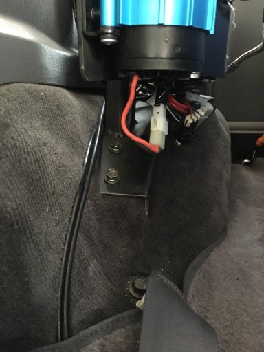

I’m running the ARB twin compressor also. We fabbed up a custom bracket and mounted it to the existing rear seat wheel-hump mounts so it bolts up tight. We were able to get it neatly tucked to the side so packing around the unit isn’t a problem. Easy access and inside the rig which keeps it clean and debris free. I use the compressor for airing up the tires as well as operating my ARB Air Lockers. I’m not planning to run air tools, although could be worth considering for long expeditions. Gotta find a place for a tank next! Running out of space to add stuff!!View attachment 64814View attachment 64815
