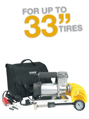

Steve - I still haven't ruled out CO2, but I did just pick up an VIAIR 300P for ~$128 on Amazon. It's duty cycle is 33%, but it only takes a few minutes to air up. It's no ARB, and it doesn't have a 100% duty cycle, but for the price it's hard to argue. I'll probably still retrofit my Rover's onboard EAS tank and compressor, but the portable VIAIR is pretty nice. As long as I keep in mind this is only for airing up tires and not running powertools as well, I should be fine with this over CO2.

Thanks, Peter. That's about half the price of the Vlair 450P that many folks rave about. And has a higher CFM rating at 0 PSI. Definitely one to keep in mind.

To bring this thread full circle, I ordered the Vlair 450P portable air compressor on Sunday. Despite Peter's 300P suggestion, which is a better buy and probably every bit as capable for how I will use the compressor, I opted for the 100% duty cycle model instead. Thanks for everyone's input!

Can't edit the previous post. Somewhere along the line I started typing Vlair, but it is Viair. The 450P came today. It is much larger than I was expecting! I was going to put it in the spare wheel, but that ain't gonna work. Rear footwell will probably be its storage space.
It looks to be very well made. I'm pleasantly surprised. I'll have to compare the inbuilt pressure gauge against my good one.

Steve - How's the gauge with your 450P?  I found the one on my 300P was not that accurate, but I have another gauge I use to check pressure.

I've only used it a couple times, and didn't do a good comparison. I just overfilled about 5 pounds, and then bled the pressure off with my hand-held gauge. I think the pressure indicated by the Viair gauge was a few pounds higher than that indicated on my gauge.
I'm using the Longacre 52003 0-60 PSI gauge, which reads in 1/2 pond increments, and is accurate to 2%, so within less than a pound at 40 PSI. http://www.amazon.com/Longacre-Deluxe-Tire-Gauge-0-60/dp/B0055EFTWU
I run a 300P. I've noticed my gauge is off by about 5 lbs when the pump is running, but once shut off the gauge is 100% correct.

I run the ViAir 400P, it works great! I plan to install a tank and mount it so i have an On-board-air system.
