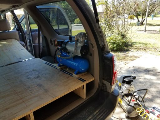

I have my Puma 12v compressor hard-mounted in my 4runner, but it is meant to be portable so you could leave loose and lying on its side. The compressor is mounted to the "wing" of my cargo box / sleeping platform, so it can hinge away from the wall to access the storage compartment in the wall.
I havent even put power to it yet, but the reviews on its performance are very favorable. I needed something 100/ duty cycle so I could air up my 33s as well as my wife's. I will be building a simple hose setup that will allow me to hook hoses to all 4 tires and then inflate or deflate them to a set PSI simultaneously. I expect inflation to take under 12 minutes for all 4 tires, but Ill time it and post pics and reviews when I get around to it.
The other Sean
2,271
Minneapolis
2292
I really want one of those. My main garage compressor is a Puma and it is a great unit and is really quiet. Space is the only concern. That is a big unit.
