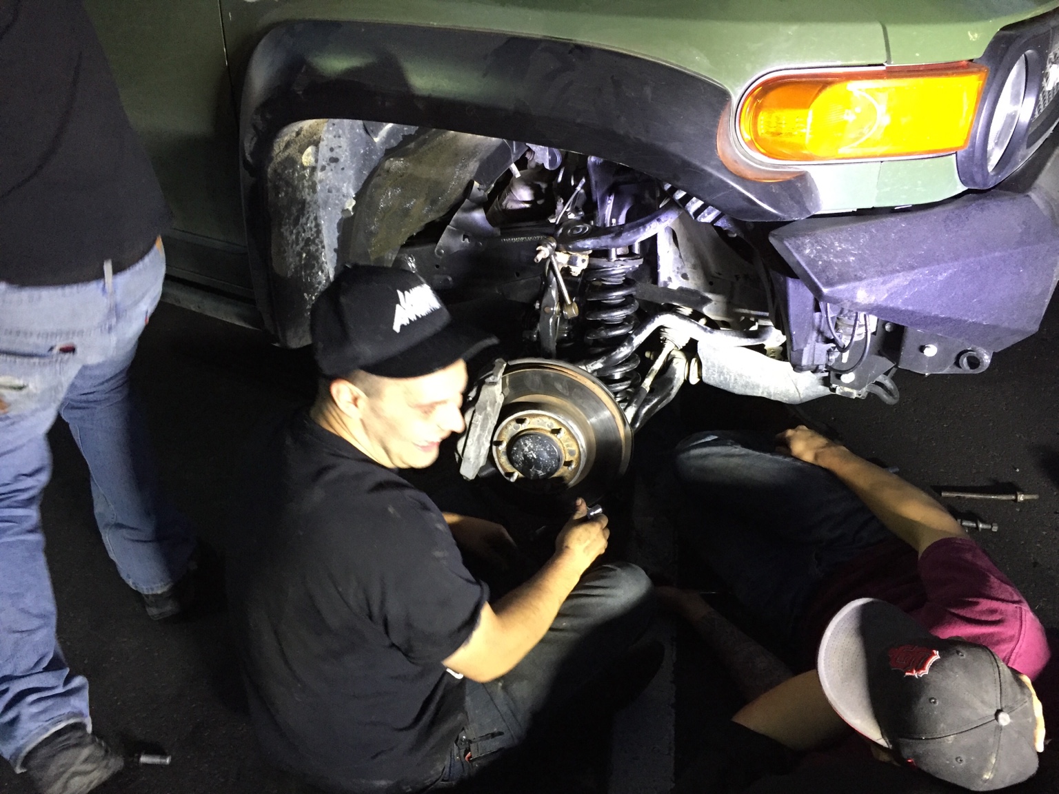

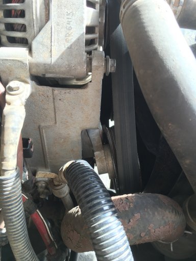

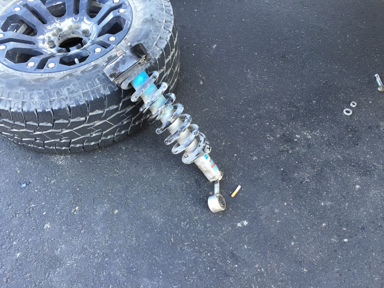

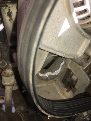

First stop, wash the dog. Just as I park, a squealing sound starts from the engine compartment. Weird. The dog is washed. I start the engine and the squeal is still there. Go out and check and notice the serp belt wobbling a bit. Turns out the tensioner pulley is out of alignment. I thought maybe the bolt securing it had loosened up, so I get the belt off. After less then half a turn of the bolt the tensioner falls off. In the darkness I see a ring of fresh metal staring back at me. Looking at the back of the tensioner I got to see what used to fill that freshly opened hole.
Another holiday weekend, another trip to the shop...IMG_7955.JPG IMG_7959.JPG IMG_7956.JPG
Another holiday weekend, another trip to the shop...View attachment 7474 View attachment 7475 View attachment 7476

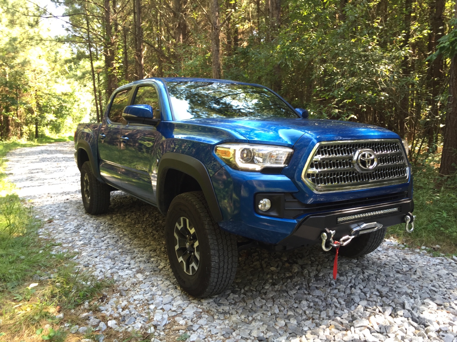

I installed OME 885 coils on the blue taco today, along with Bilstein 5100 shocks all around. Makes the truck sit nice and level now, even with the winch and bumper up front. Rides really nice too. Took it on a really rocky road and it seemed much smoother than before. I'm happy with it!

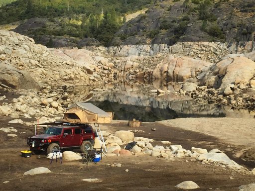

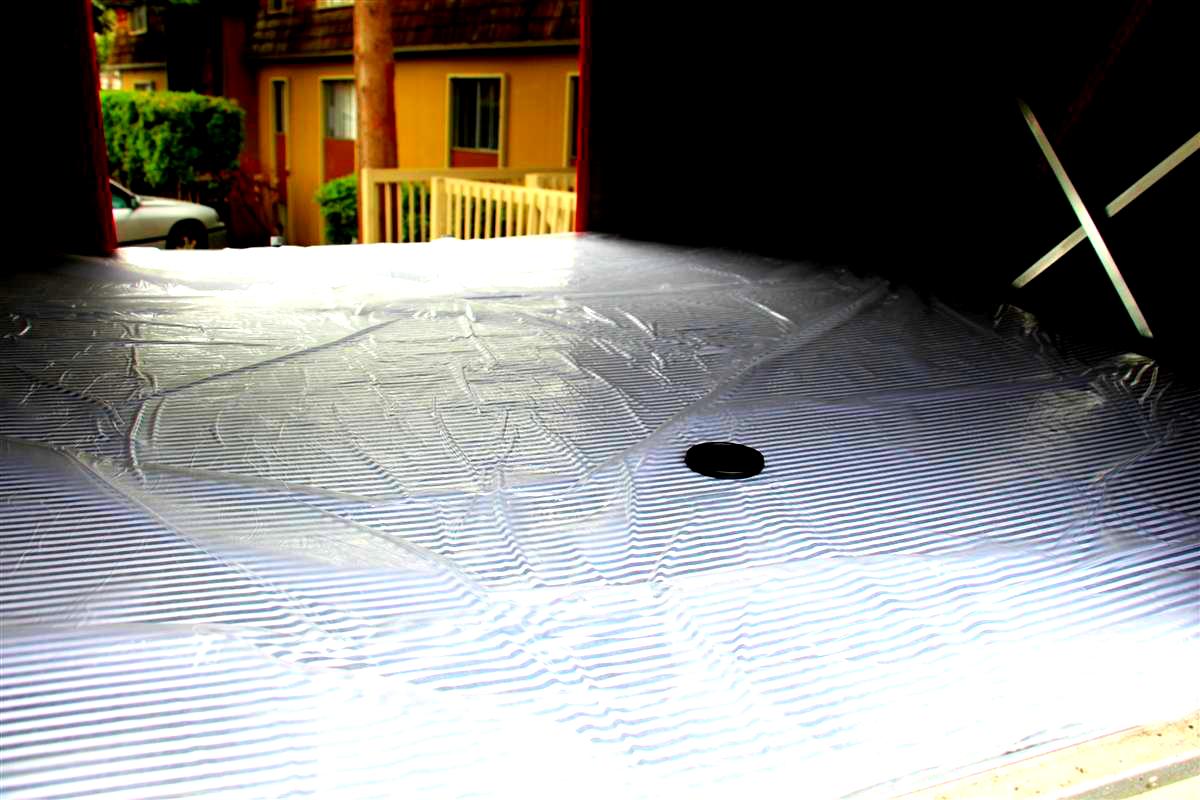

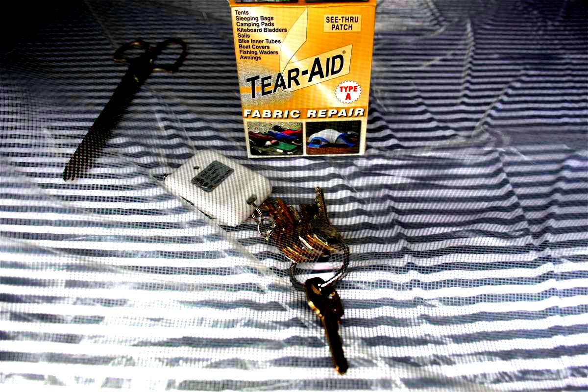

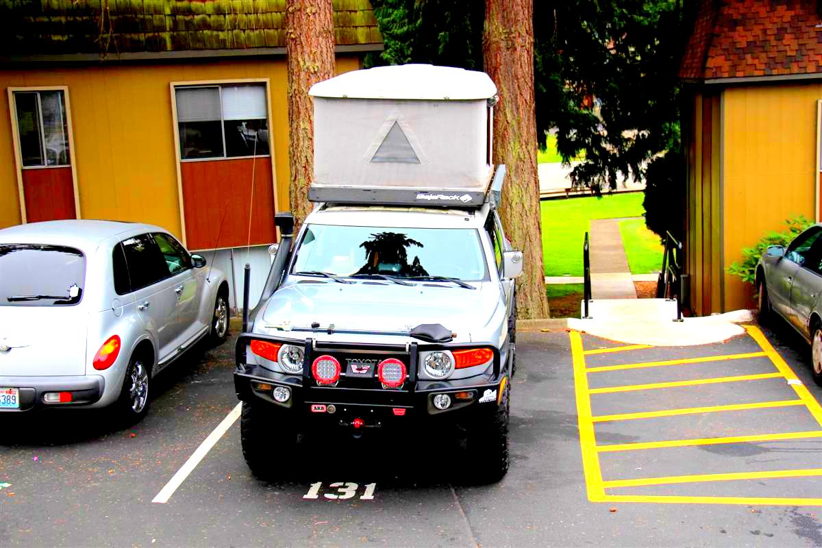

Opened up the roof top tent to wash the sheets, fluff the pillows, and shake out the down comforter.
Also have had a small 1.25" or so tear in the mosquito netting for the left side door.
It happened a few years ago when putting away the tent experimenting with leaving it and the canvas door zipped.
Always leave both the door and the netting unzipped.
Used a product called Tear-Aid type A, and it worked good.
Not totally transparent, but close enough.
Put a patch of it on both sides of the netting, and it is very sticky stuff on one side of it.
Hopefully this holds up well.
Tear-Aid Fabric Repair Kit Gold Type A
Wiped off the canvas too as there were a few dead spiders and cocoons for some type of insect.
Nothing on the inside of the tent, but they can get up in there from the slight gap where the lid comes down and build forts on the outside of the canvas.
Shot some Ortho bug killer around the perimeter of it, that may keep them at bay.
You can see the tear where I have the key sticking through the hole
Patches in place
Climbed up on my ladder for this pic
Still have the original plastic bag on the mattress from 2008, no need to really remove it
Reactions: WJ - Firefly

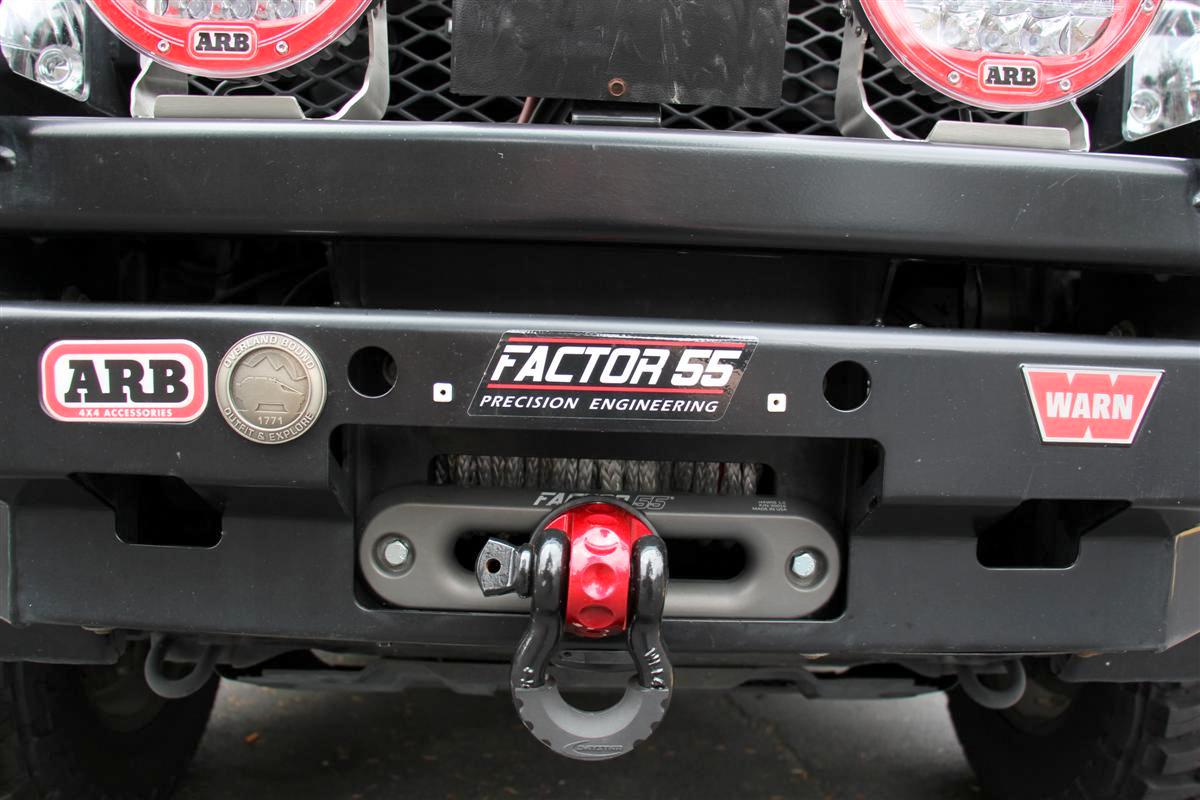

Added thirty more horsepower this morning with three stickers at ten horsepower each.
Found a good place for the Factor 55 one since I am running their hawse fairlead and the ProLink thimble
Put three round ones on the rear of the tent, need another round one for the left side to balance it out
I am not really into smothering the rig with a ton of stickers, but a few placed around does not look to bad IMO.

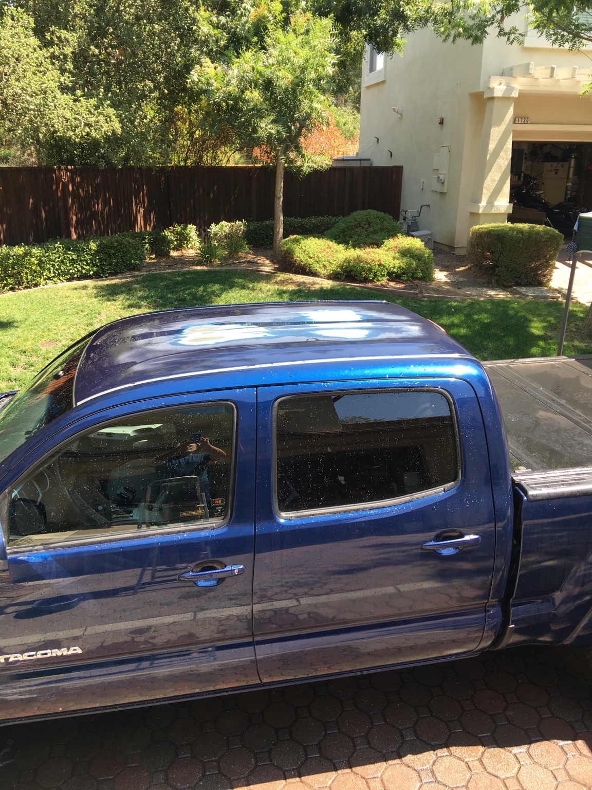

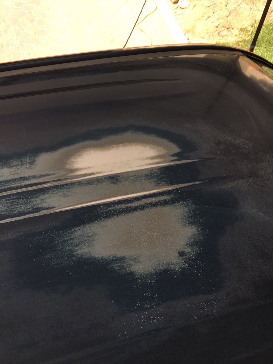

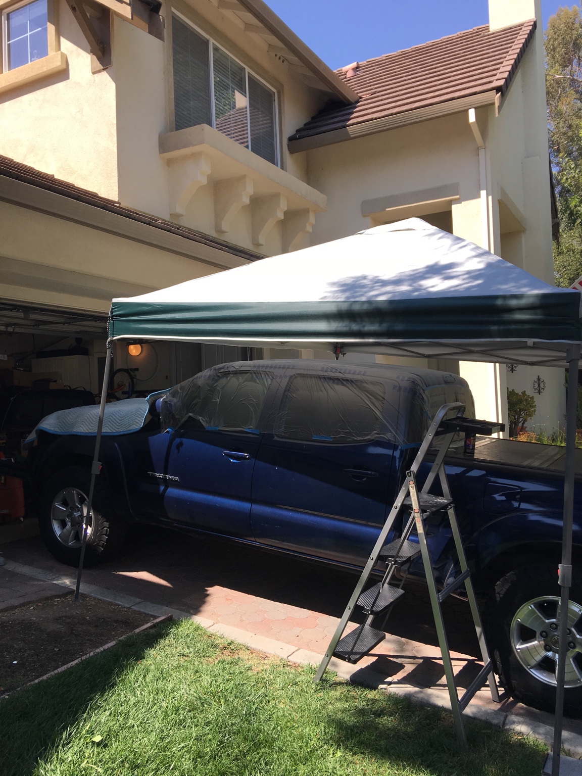

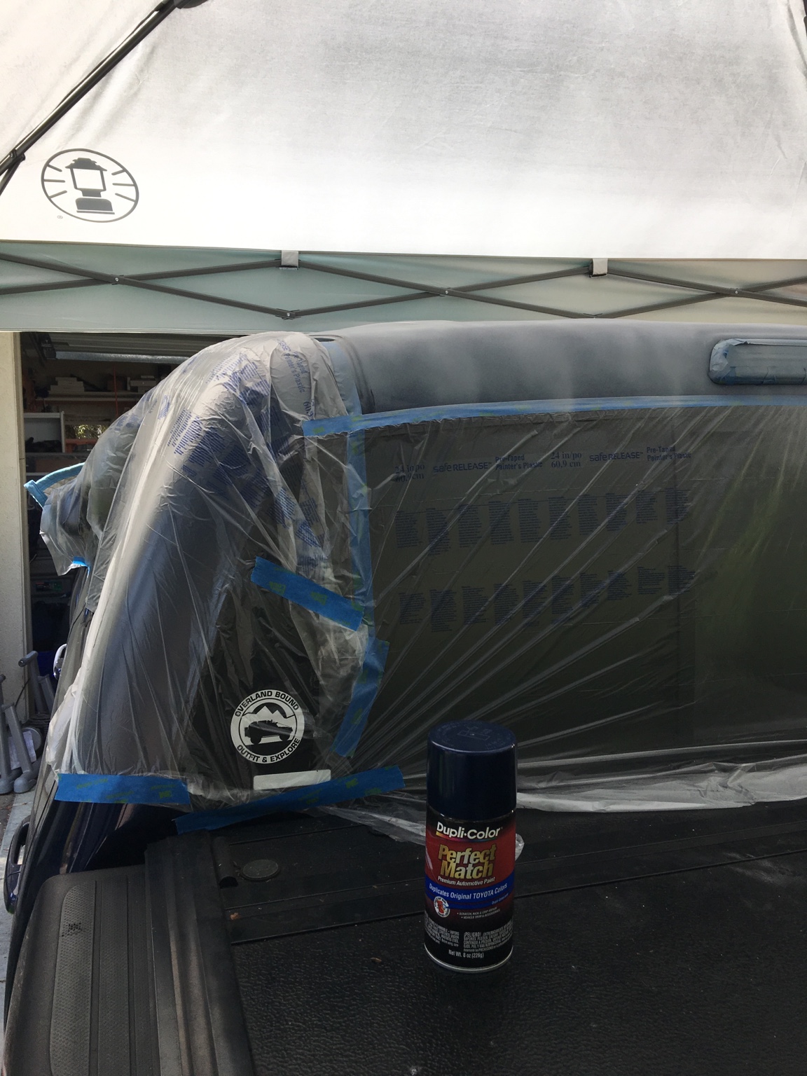

A few months ago my 2007 Tacoma started to develop some clear coat failure and rust spots on the roof. At the same time the fiberglass camper shell also started to have clear coat failure on the roof. My hunch is one of the chemicals in the car wash I use was actually a degreaser and it did a number in the roof.
Last weekend I sanded down all of the rust spots and put "Rust Fix" on them. This weekend I went over treated areas with some sand paper and then primed the entire roof. Finally, after a thorough cleaning I applied the first coat of Dupli-Color spray paint to the roof.
Next weekend I will clean it again, apply one more coat of paint and then apply some clear coat to it. Finally, I will polish it, wash it and call it good.
I am learning a lot about "low budget" rust repairs in the process. I sure hope it will turn out okay in the end.
