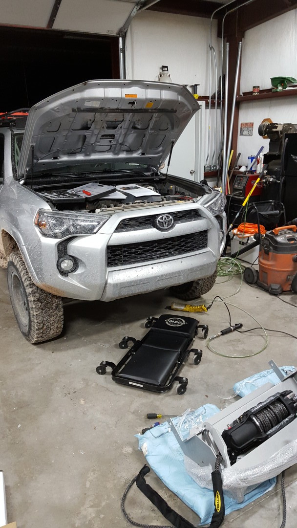

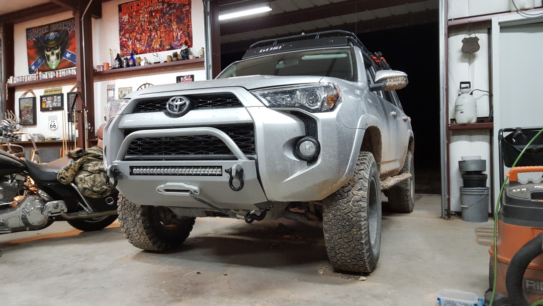

Installed HeftyFabworks front steel bumper with Superwinch Talon 12.5sr and Rigid D2 DOT fog lights.
This was the most complicated(read PITA) instal I ever did. The bumper is heavy around 225 add 70 lbs winch to it and it gets tricky.
Also I needed to relocate the solenoid for the winch and windshield washer reservoir.
Because I have the ARB compressor mounted in the back P/S I was unable to relocate the air pump therefore unable to instal expedition one windshield washer reservoir. I need to make a trip to @Bandi to see if we can mount the air pump under the compressor in order to be able to relocate the reservoir.
Man totally good looking 4funner. But A) take the flat link off for a bit and wrap electrical tape around the metal eyelet of the winch line and reattach. This prevent sun damage to the exposed line (I was asked to do the same by factor 55 directly with my flat link-E). And B) is it just me or does your bumper hoop blck a ton of your headlight. But still, good looking 4funner man.
