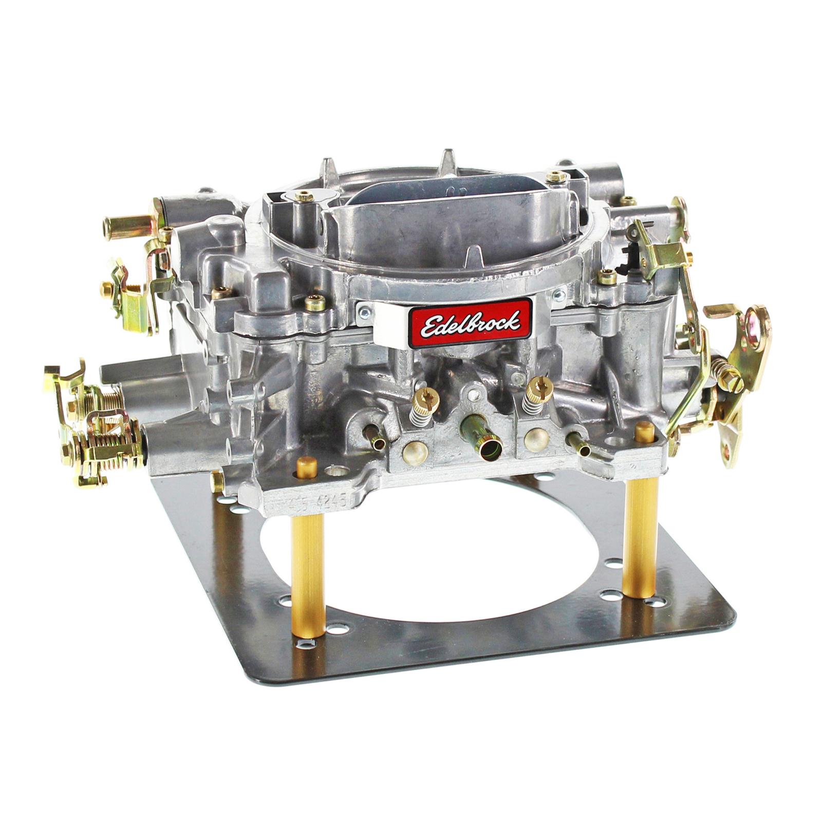

If you are new to carburetor tuning and fiddling, I would go with the Edelbrock Performer 1404 (Carter AFB). These carbs have been around for 50+ years, they are simple, no side hung bowls that want to leak, easy to tune, etc. Are there better "High Performance" carbs out there, yes, but this will give you all the performance that 300I6 has to offer. Best of all, Summit has them for under $400. I have used them and had great success. The 1404 of 500CFM and should be all the carb you need.
Edelbrocks are good to go. I always forget about them being raised by an old school hot rodder and being into small displacement import engines...

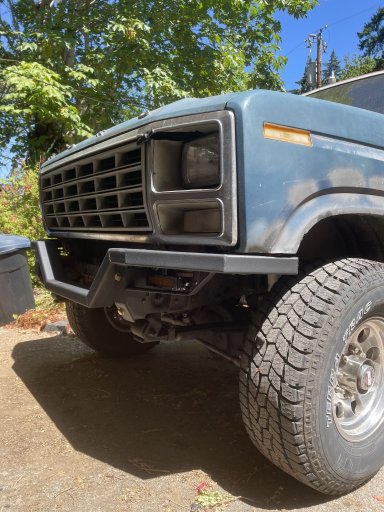

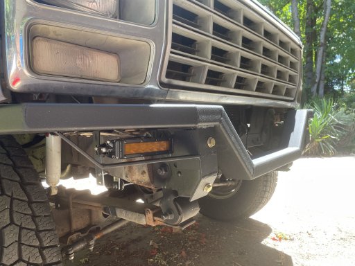

It's been a while but I finally got back to working on the truck! Wanted a new bumper but nothing on the after market sites had a lower profile bumper that I liked so I went the custom route and built one myself. My requirements were simple: low profile, room for a winch (hopefully coming soon), and decent fog lights. For a first time bumper build I am pleased with how it turned out!
stark-in-the-wild
646
Salmon Creek, WA, USA
Reed
Starkey
4848
Nice work. I love the simplicity. Just remember why you bought it!
If it was me I’d keep it as simple as possible (as I dive off the deep end )
Its a good point haha I will admit I have slightly modified my rules for it.
The drivetrain must remain stock. Only fixing things when they break. Outside of that though I am okay with it as long as I am learning something while doing it. Welding the bumper was a good lesson in welding thick metal and making it fit the truck with tight tolerances. Plus now I actually have lights that allow me to see in the dark haha. That being said I really do appreciate the "keep it simple" reminder because its so easy to get lost in the weeds with projects like this :sweatsmile: which I still am trying to avoid (though its a battle I'm losing)
