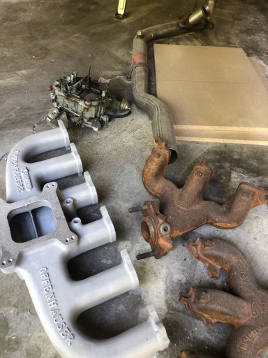

Well with my move having been completed, most of my time (and money) has gone to home renovations. However, behind my girlfriends back I have also been accumulating parts. I have purchased a 4 barrel intake, and I have a newer model exhaust (common modification for a 300 I-6 of this year. To top it off I found a free carb on craigslist. I haven't had the time to install it all yet though.
The parts :sunglasses: dusty with flooring saw dust.
Also, in GREAT news the state of Washington does NOT have smog like my previous home state. That means I can take off all the stupid smog stuff which just means more power and a smoother running engine.

So that carb looks like a Quadra Jet, they are great carbs but take a lot of experience to rebuild and tune. Most people throw them away because they dont understand them and dont want to devote the time to learning. Now on the down side, even if that carb came off of a small block its going to be too big for a 300-6 until you start doing some big internal mods. The 500 2bbl I was running on my 300 was too much carb, You would ideally be looking for an old 390 Holley 4bbl. You can probably make it work because Q-Jets are spread bore, but you will need to be easy on the pedal, once the secondaries open its going to be a lot of fuel...
Also if you need any help with that Q-Jet drop me a line, I was one of two guys people had rebuild them in my old 4x4 club.

Great info! Had no idea what it was but seeing the price of the 390 Holleys had me running to the used market haha those carbs were almost as much as the truck!
I have read online and the FordSix forum a million different recommendations for these engines from 390 all the way up to 750 with not much done to the engine. So for a free carb i figured i might as well give it a shot before I go spending money on a smaller one. I do fully expect it to be too much carb tho haha hoping I can make it work for a time.
I may need to take you up on the help though so I'll reach out if i start tearing it apart. Im going to attempt as is just to see how it does and if it works then ill go through the pains of a rebuild and if it doesn't...then ill make a game time decision :grimacing:

Yeah for sure man. I would highly recommend getting a manual for the Q-Jets, this is the book I used . Also before you start rebuilding it make sure you have some fuel safe epoxy on hand. Theres a few spots that were sealed from the factory and after 30-40 years the epoxy starts breaking down and causes leaks, also make sure you have a big clean area to start the tear down, theres lots of small parts in there.
Yeah figure organization and taking my time will be a big part of it. You think a 600 cfm holley would be better? or any other recommendations more "bang for your buck" style carb? the 390 is just too pricey for this project
What are the numbers on the Q-Jet? A vast majority of those guys are 750, so a 600 would be a bit better. The benefit of a Holley is they are nearly infinitely tunable. But Caddy, Buick, and Pontiac big blocks got 800s.
Go to a junk yard and pull off a stock carburetor off of a 1987-1990 f-150/250 with a 5.8L engine. They came stock with a Holly 600 DP just landed under the Motocraft name.
I completely forgot about the Motorcraft carbs. A 2100 2bbl would be the perfect carb for a 300. AMC Jeep V8s ran them as did obviously tons of Fords.

I need to edit my years on the carb... 1980-1987 F series and Bronco with the 5.8L used the motocraft holly carbs... the 351c had a 4bbl option, but not sure if it was Carter or Holly...
But yes, I would stick to a 2bl carb in the 550-750 cfm range for the I-6.

I had decent luck with a 500 Holley on my 300, but it had intake, headers, was bored out, had the BBC rocker mod and it was still a bit much. I really wanted to go to a Webber 38DGES. I also ran a Webber 32/36DGEV on my stock 74 300 and it wasn't quite enough. So I always figured around 400cfm would be the sweet spot.

If you are new to carburetor tuning and fiddling, I would go with the Edelbrock Performer 1404 (Carter AFB). These carbs have been around for 50+ years, they are simple, no side hung bowls that want to leak, easy to tune, etc. Are there better "High Performance" carbs out there, yes, but this will give you all the performance that 300I6 has to offer. Best of all, Summit has them for under $400. I have used them and had great success. The 1404 of 500CFM and should be all the carb you need.
