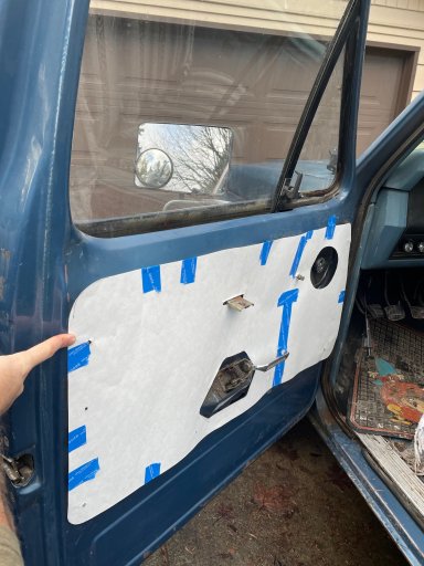

That being said I have 15-30 minutes here and there that I have been putting to a side project for the truck. It'll either be appreciated or hated when I am done with it but the way I see it anything is an upgrade on this thing. I never thought I'd attempt custom upholstery but here I am dipping my toe in the water to see how goes. Specifically I am making more low profile better looking (hopefully) door panels. I am doing this because in the 60's cars had exposed painted metal all over the interior (dash, door panels, etc.) and it's a look I really liked. When I removed the lower half of the plastic door panel I saw some stampings in the painted metal and just thought it added character leaving it that way. I also am not a fan of faded blue plastic all over the door.
First photo I am making a template on paper, which I then transferred onto wood I had laying around as a more permanent template.
Second Photo I am using the wood template to put the design on the final piece.
Third photo the two templates and the final 2 pieces for the both sides of the truck.
Currently I am waiting for the fabric and fabric glue. But I have some cushion for under the fabric cut to shape and some speaker guards for the big holes. Hopefully it will come out decent! If I had a sewing machine I could do part fabric and part leather but unfortunately I don't so 1 simple fabric it is. Looking forward to showing the final product...if I don't show it in early January then it all went wrong and I stuck with the plastic door panels and decided to love them. This little project creates two problems though. 1) the window seal on the inside was attached to the plastic door panel. So I need to find a way with metal to make a 0.5" bracket to hold the window in place with the window seal. I think i have this figured out but we shall see. 2) I need to make an arm rest...maybe out of metal and wood? 3) The wood isn't water proof. So I either find a way of water proofing it on the back or hope the new seals are good and don't stress about it.
