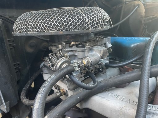

I finally got the carburetor I rebuilt on the truck! It's a 4 barrel Holley Economaster 400cfm. The truck runs and in 2nd gear feels great. It coughs a bit under heavy acceleration and initially every time I shift gears. After getting a quote for $500-$1000 to tune a carb...I decided I will be learning how to do it myself. I was already going to but sometimes I like to know the prices of the skills I am learning. I also took a peak at my distributor cap and rotor which were shot. So I swapped those out too.

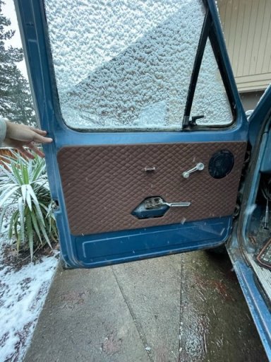

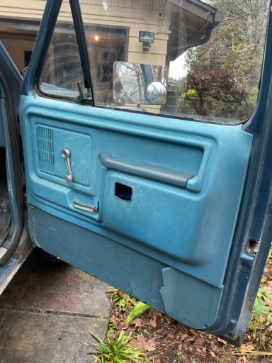

Also, I did the easiest job I have ever done. I replaced the rubber around the doors and windows which makes it a new truck as far as I am concerned. The rubber cost me $130 and the install took less than an hour. Best thing I have done to the truck so far. NO MORE RATTLES!!! It feels and sounds solid. Swapping the rubber on my mustang was a b**** with the adhesive and holding it and moving on but in 1980 (maybe sooner) Ford made it as simple as pushing it in place. The hardest part of this install was removing what was left of the hardened seals that were already there.

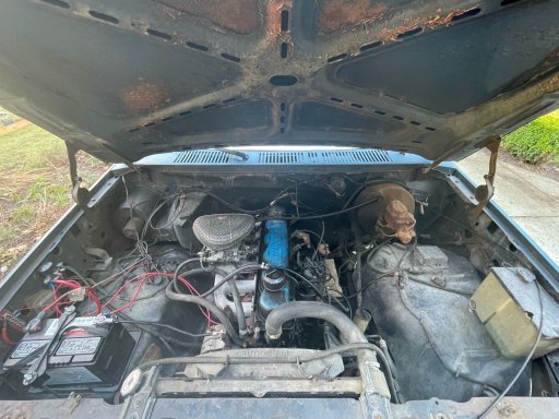

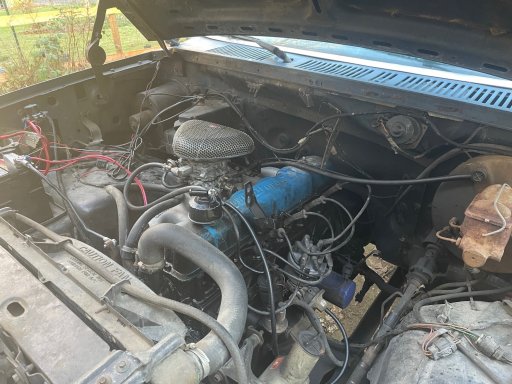

Some photos of the engine bay (so much room for goodies; Turbo 250?):
