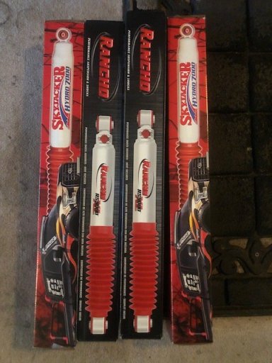

Finally have some parts coming in! Now I can make use of this quarantine and get ready for the summer. For now just some photos of the new bits and next week ill actually get around to installing them.
First Suspension! no more "20 year old sat in the woods of Washington" shocks. No lift here as I like the height of my truck as is and it should be fine for river crossings and most offroading routes. No plans of hitting the Rubicon anytime soon.
And of course the most important piece! :sunglasses:

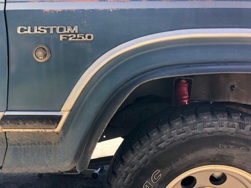

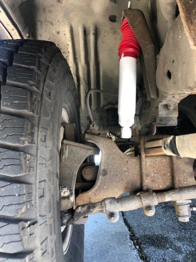

New shocks installed all around! Thankfully (despite being 30 years old) everything went pretty smoothly! Tomorrow its a boring job of me trying to fix the gasket that went bad in the steering box :sweat: power steering on a tank like this out on the trail is quite nice so need to get it working again.

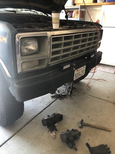

An Update...and need some opinions!
I swapped the super old steering box because it was leaking out of the upper and lower seal. Nothing special just got a rebuilt OEM replacement for like $90.
THE ISSUE (and this was also a thing with the old steering box):
The wheel is turned left when going straight. The pitman arm is on correct and straight. The steering column is connected to the steering box and aligned correctly. Lastly, the steering wheel is connected and only fits one way. Can this be alignment and both wheels are off at the same exact spot?

It is a simple adjustment of the tie rod. There is turnbuckle on it. Loosen the clamps and turn it to shorten the rod.
Reactions: stark-in-the-wild
TexasGMG
646
Hell
Fuck
Off
If I remember correctly, the steering shaft was splined so you could pull the steering wheel and adjust it on the shaft. If yours isn't like this you might have to pull and adjust the steering arm
