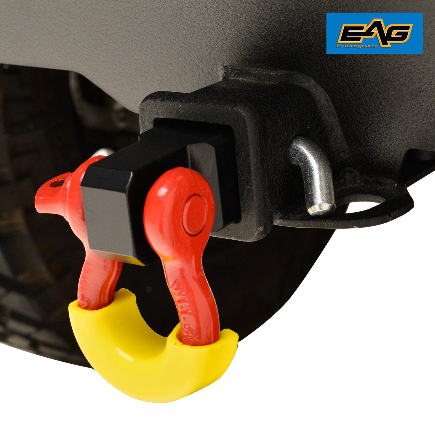

Rear Tow Package Shackle
I just put one on order. Reason being is that the rear is missing this Very important piece of recovery gear.
The front already has two high quality tow hooks that are actually bolted directly to the frame (Some other brands tend to have wielded on hooks that tend to tear off of the frame at some point). They are good to go and will totally work for when being recovered.
However, I never plan to use the front hooks when recovering someone else. Using reverse gear to recover someone else is a great way to destroy diffs, transfer cases, etc. Since the gearsets inside of those gearboxes have their teeth oriented in a certain direction to maximize strength when going forward. This just happens to weaken those same gears when going in reverse.
Having a shackle hanging out of my rear tow package will both aid in the recovery of myself or other vehicles... and act as a protective "stinger" hanging out of the tow package on my truck. Which is already the lowest part of the rear bumper. These are highly functional... and affordable too!
This is a link to the one I just put on order. The protective cover on the D-ring is actually black instead of yellow though.

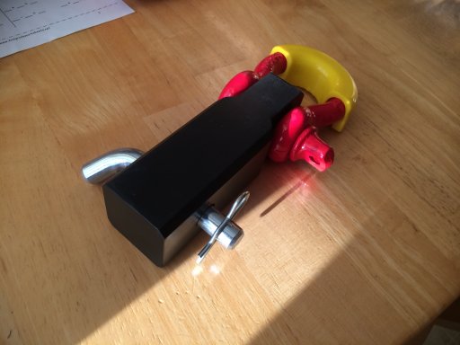

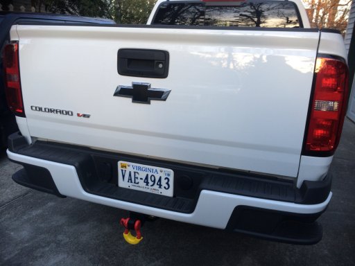

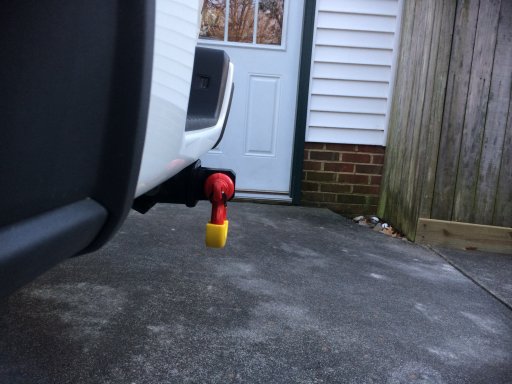

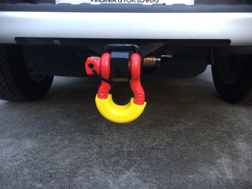

New EAG 2" Hitch Shackle has arrived and is installed.
I put a coating of Fluid Film between all moving parts and stuck her on. Hand tightened the shackle and then backed it off 1/4 turn before throwing on a test ziptie. That should both keep it from vibrating out when on long rough trails... and keep it from seizing up after hard use. I don't want those two pieces to fly through someone's windshield @70mph while they are also going and additional 70mph in the opposite direction!
She is much more flush than I had hoped. That is great! I hate hitting my shin on the tow ball when I have it installed.
I will likely remove it in a week or two after the fluid film layer thickens up. Then throw it under the back seat. I will just install before each trip. I can now comfortably drive on the beach without worry so long as I remember the shovel and a long board or two.
I don’t really like the yellow cover.
This thing is HD!!! Made from a solid piece... I hear some are hollow inside. Should take years of beatings out on the trail.
