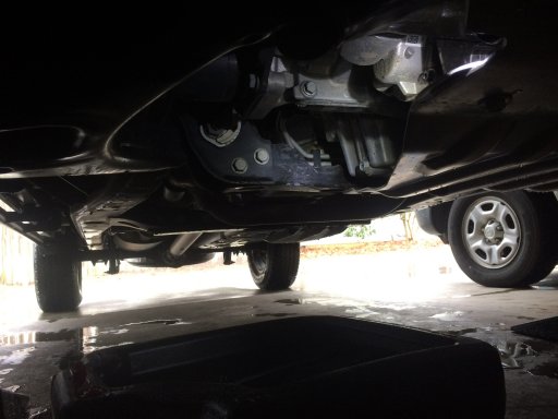

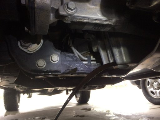

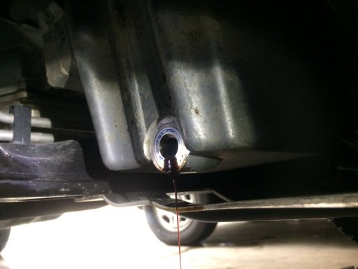

I just did the first oil change since installing the OEM skids. Verdict... oil changes are just as easy as before. Awesome
Oil filter is up on the side of the engine and reached through the engine bay. No factor.
Drain bolt is still super open and easy to get to. I did discover that the skids act as a great flashlight holder. That is what is lighting the thing up in the pics below. Should make oil changes on the road a lot easier. lol
The oil does not drip on the plate... however... it also did at some point (just a little). I left it draining for a good 15 to 20mins. Maybe some wind blew the oil back onto the pan at some point idk. Either way.... it was not enough to run out the other drain hole further back. I was able to easily reach up from both sides and wipe it out easily.

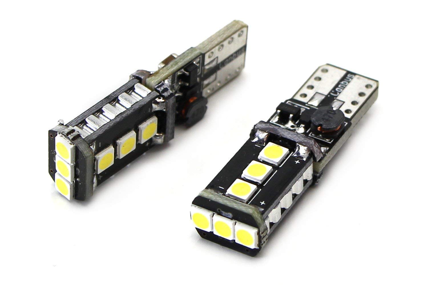

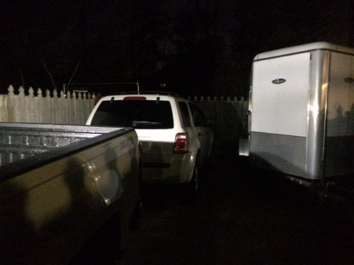

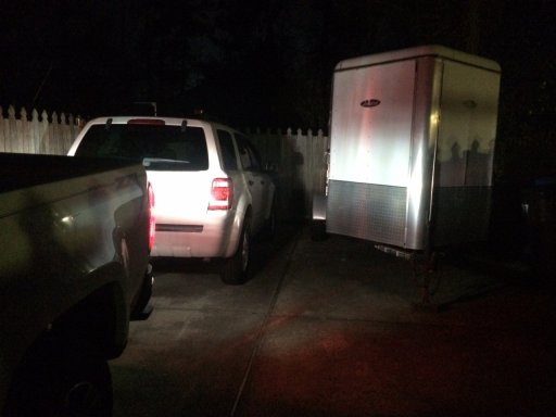

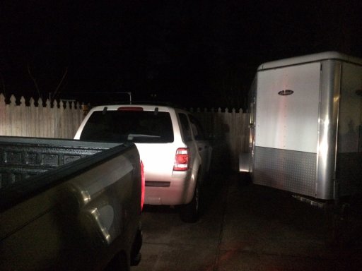

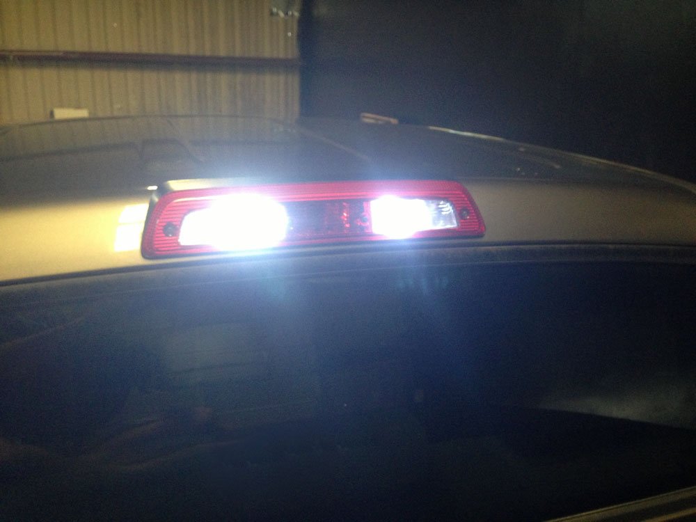

I just installed some LED reverse and bed lights onto my truck. They were $8.79 per pair from Amazon.
Saw them on a Chevy Colorado YouTube channel. They make the bed lights much brighter and the reverse lights a little brighter (and more modern). I can hit the door unlock button @ night with my key fob and light up camp with them. I may come back later and wire in a switch as well. Or I can just use the bed lights as well.
WAIT!!! I just came up with something both Simple and Brilliant!!! I can just use the bed light switch and wire in the reverse lights to that! Just a best use of factory buttons! Man oh man am I good. lol (Easier said than done!)
There are some up to $200 options out there that are like little spot lights. Not for me and my needs. This will work just perfect for me!
EDIT: I know wiring and I put some more thought into it. I would have to wire it to power a relay to keep the systems separated. It would totally work though.
