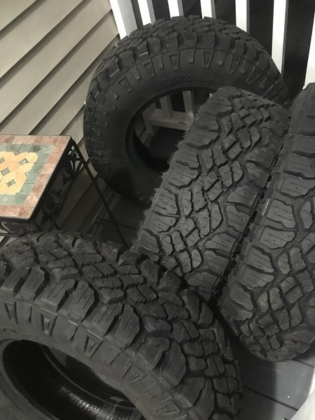

Love your build! Currently dabbling in the same with my pilot. You say youre running 245/75/16 tires, are they LT or P rated? Are there any problems with fitment? I'm gonna order a set of Falken Wildpeak AT3W's for my 2004 Pilot and i'm unsure of if I should upsize or maintain the stock size.
I am running LT245/75R16 108/104Q C Goodyear Duratracs. I chose this tire because they where the lightest most aggressive tire I could find. They weight 40 lbs while most other aggressive tires are E rated and about 50 lbs.
