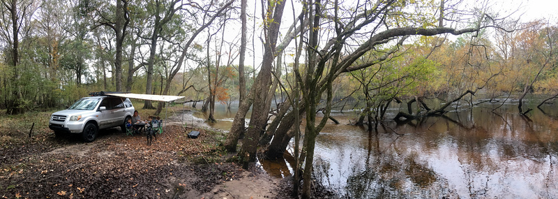

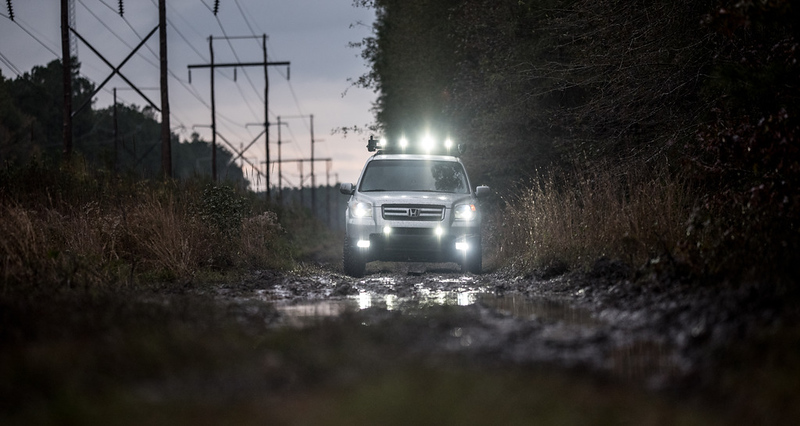

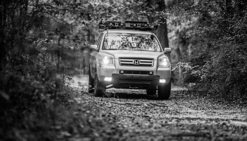

2007 Honda Pilot Off Road Build
2007 Honda Pilot Upgrades
• Led Headlights and fog lights
• Weather Tech floor mats
• Transmission Cooler
• 2 in front lift
• Front cam bolts
• 1.5 in rear lift
• Adjustable rear camber control arms
•Rear swaybar delete
• Front skid plate
• Firestone W237604135 Coil-Rite Kit
• Smittybilt Defender one-piece roof basket
• Pro Comp Explorer Spot Beams x8
• Tentproinc 8x9.5 awning
• Hi-LIft Jack
• 4-Ton Dual Gear Power Puller
• Shackle hitch receiver
• Front Shackle mod
• Plano Gun Guard All Weather 36" Box
• 5 camping chairs held in gun box in roof basket
• Folding table stored on top of traction pads in roof basket
• 4x X-Bull traction mats
• 4x Goodyear Duratrac 245-75-r16
• Full size spare wheel 245-75-r16
• Jumper cables under driver seat
• Toolbox under passenger seat
• Modified trunk area to hold recovery gear
o Viair 88P Air Compressor
o Tire patch kit
o Shovel
o Axe
o 2.5lb sledge hammer
o DIY Hi-Lift Recovery Kit
o Hi-Lift Jack Mate
o 20’ x 2” Pro Grip recovery straps X2
o 50’ Synthetic Winch Line
o EZ Tire Deflator
o 2x wheel chocks
o Tools/ spare parts
o First Aid Kit
o Wd-40
Future projects
• DIY rear dif skid plate
•Front swaybar disconnect
• Receiver mounted winch setup
• 2” rear lift
• Snorkel
