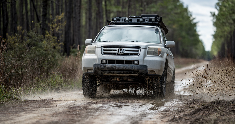

It's nice to see one of these offroad, I work at a Honda dealership and almost none of the customers use them for anything other than commuting.
Thanks,

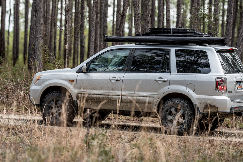

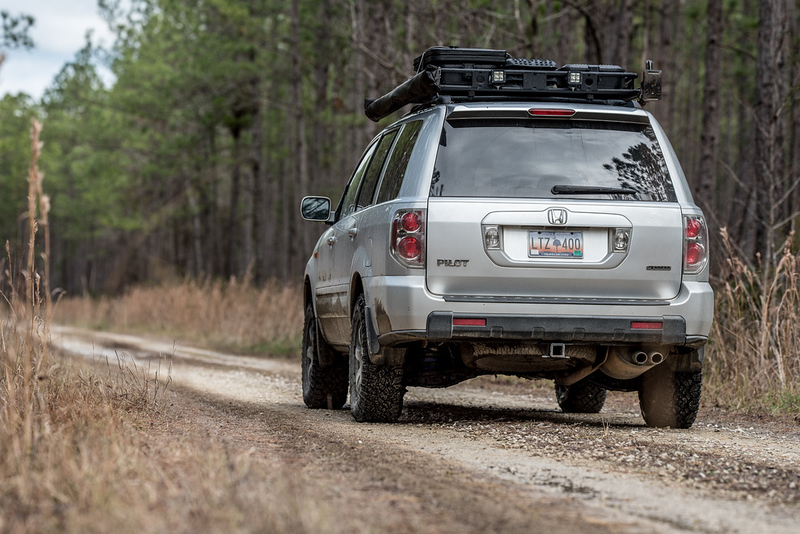

I find that the Pilot is a very unique vehicle. It has been incredibly reliable, seats 8 people, has decent clearance (with a 2” lift), has active awd (there when you need it), but can still lock the rear axles in a pinch (3wd? LOL). It is not too big or too small and in my opinion still looks good in 2019.

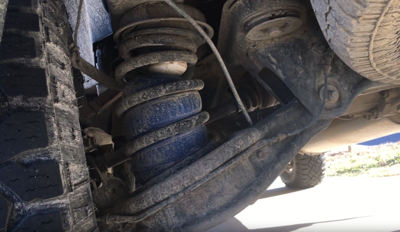

I’m very interested in your sway bar findings.
2 questions:
-what do the air springs do for you?
-what are the pros/cons of disconnecting front sway bar vs rear sway bar?
Reactions: b0wfin
b0wfin
2 questions:
The air springs allow you to adjust the ride height in the rear (useful for people hauling or towing). In my experience they also add stability and stiffness while not making the ride uncomfortable (air suspension). Despite having a lifetime warranty they can be a chore to keep full of air. The macro fittings can be a little finicky and leak slowly from time to time. I originally rigged them up on separate air lines, but found it better to join them together with a y fitting on one supply line. This keeps the pressure the same on both sides at all times. This is especially important in the event of a blowout (I have never had one). My Firestone W237604135 Coil-Rite Kit has been incredibly durable and does not show any noticeable wear from over 2 years of use. If/when I buy another 2006-2008 Pilot I will be adding this kit again.

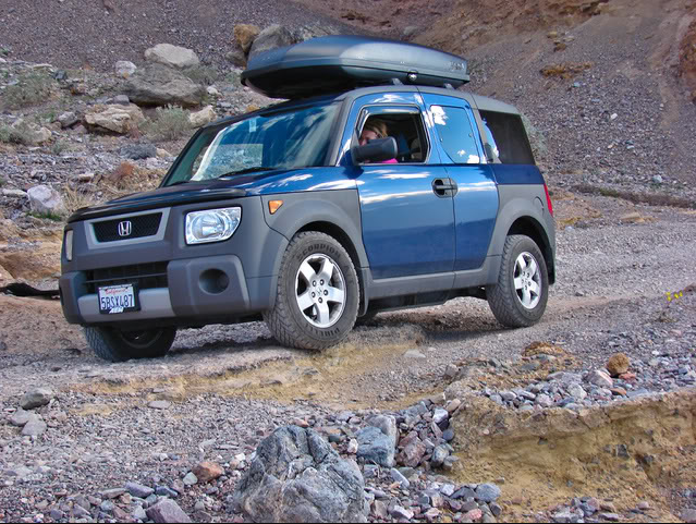

Contrary to popular belief, some hondas are magical offroad.
I really love this element.
I think the honda guys need more love.
The first pic is photoshop, but the Element is actually based on the CR-V platform and uses an identical RT4wd system. They are pretty cool vehicles and decent off road, but their undercarriage geometry isn't as good. Having said that, I've seen some pretty sick looking lifted Elements and they have some very practical features.
I agree us Honda guys need more love! :D lol But then again, part of the fun is hearing some dude say "you can't wheel that thing" and then proving him wrong.
