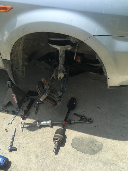

Whoa, b0wfin, sorry to hear of your axle woes. Yikes. Glad everyone came away okay, and that the Pilot is off the road again! (Only forum where being not "on the road again" is a good thing. :tongueout:)

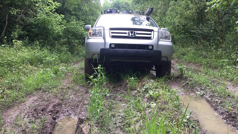

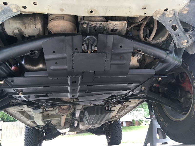

My Franken-skid has held up great so far! I expanded the front ramp this week.
Are the F250 skids heavier duty than other stock skids? Have you come down on them at all?
The type of wheeling I do doesn't require crazy 1/4" steel so I figure modifying another truck's beefy stock skids would be a lower cost option.
b0wfin
I used the f-250 skid because I found it cheap. I don't have experience with very many stock skids, but it is definitely beefier than a lot of DIY skid plates I have seen. I can lift my vehicle off the center of the plate as I currently have it with welds and all.
