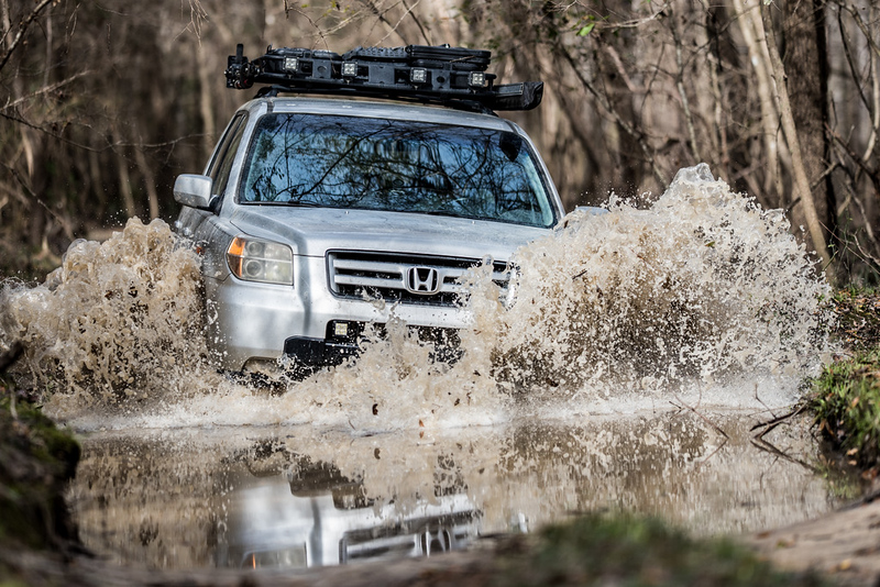

As for snorkels, as far as the rake angle and length goes, I would bet that a snorkel made for an 80 series landcruiser would fit, assuming the air box is on the same side (I'm not familiar with the Pilot's engine layout). They are known to fit the RD1 CRV and the lines are very similar, as previously mentioned. Probably much cheaper than trying to make one.
b0wfin

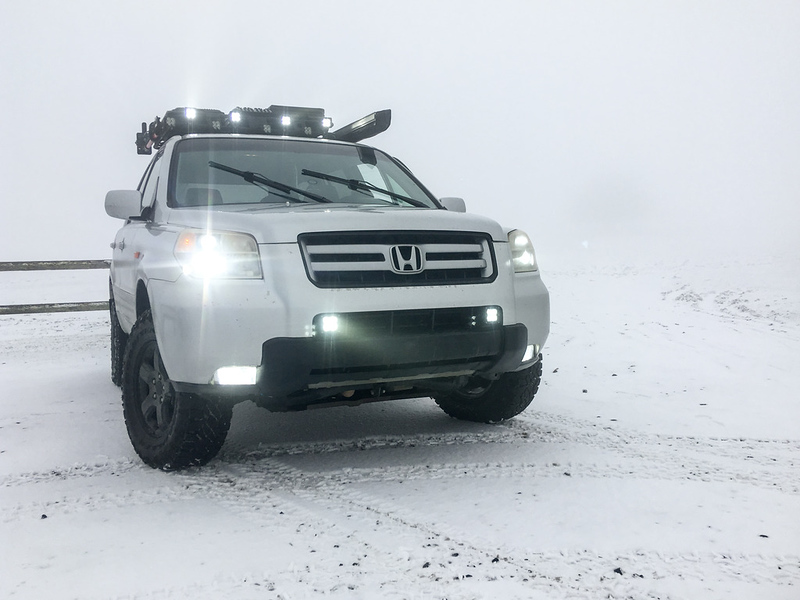

I am looking at various options for adding a snorkel. At this point I am most interested in the cold air intake aspect of the mod. I don't plan to take my pilot in crazy deep water. A while back I did research and verify that the rear diff has breather tubes run into the cabin.
1,685
Bellingham
I thought about disconnecting my front sway bar. As for the snorkel you may be able to retrofit one off a Jeep Cherokee. That’s what I did and was able to shape it into position with a heat gun. I did actually gain a few MPG’s too with it. Same as you, my Outlander has never been in deep water. It was more for fresher air factor. [emoji106] I picked mine up off amazon for about 80$

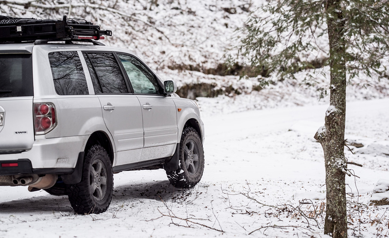

My 2007 Pilot has Honda’s VTM-4 system in it. Like SH-AWD It has the benefit of being awd while still allowing you to lock the rear axles. It is always on and there when you need it (rain, snow, gravel, etc). If you look at my pictures you can see the 4WD badge. I have been very impressed with the system!

The Pilot is a pretty unique vehicle for sure. Watch out for rust in the rear where the subframe attaches to the body. My Pilot still runs great with over 230,000 miles.

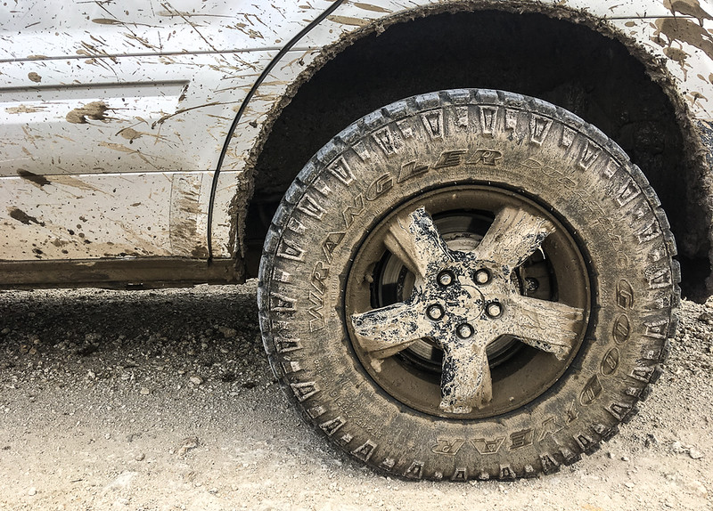

I heard in one of your videos that you're thinking of running 235/85R16 tires. That's what I'm running and, be advised, pending on brand, they rub under compression. When it comes to flex, 245/75s may be the sweet spot.

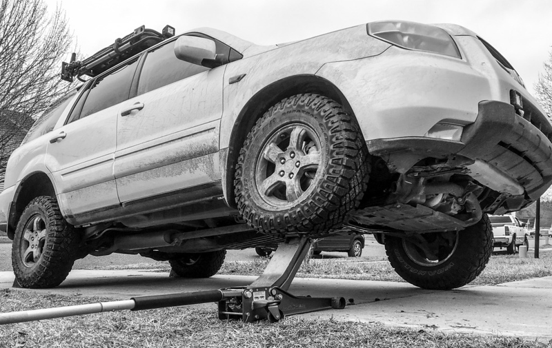

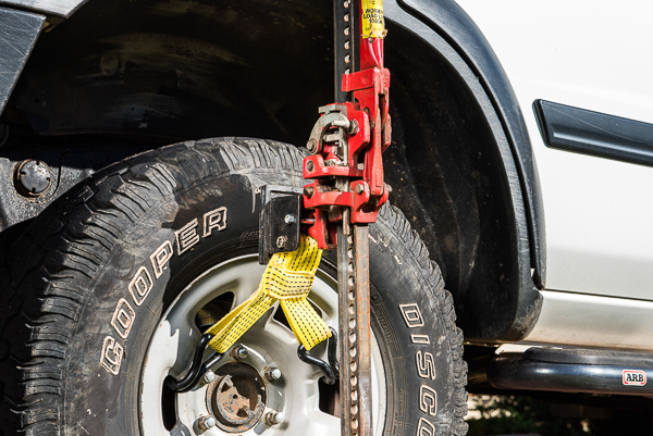

Question for you as regards Hi-Lift jack usage: Have you found any good lift points on your Pilot for your Hi-Lift?! As you probably well know, with the 2" lift and larger tires, the OEM jack is no good. And while I haven't done an exhaustive investigation, I can't find a good lift point to use with my Hi-Lift. How are you doing it?

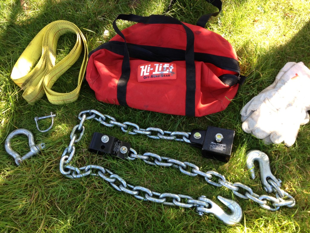

Thanks for following! With a lot of fiddling I have finally stopped my airbags from leaking. I think cleaning the macro fittings is what did the trick for me. I agree that 245-75's seam to be the right size. I replaced my front lower control arms and now even the 245's rub full lock in reverse (not too bad). The Hi-Lift is a very versatile tool. I have the wheel adapters that allow your to lift from the wheel as well as the chain adapter that allows you to use the Hi-Lift as a winch. It is great for a variety of lifting, pulling, and crushing needs. I am able to use the stock jack by placing two 4x4 squares under it.

Good Hi -Lift kit...I have the same one...except for the wheel strap. I think I'll pay [insert well-known online retailer here] a visit. :smiley: I've seen and used the wheel straps before, and they're good for getting that tire/side of the vehicle in the air, but not much use for changing an actual tire. :grimacing: I was hoping you came up an ingenious method to get the Hi-Lift "tooth" under the pinch welds.
I'll have to find a spot in the "trunk" for a couple of pieces of 4x4 post...nuts.

I have been looking for a folding off-road capable jack stand that could be used with the Hi-Lift. I might have to fabricate one...
