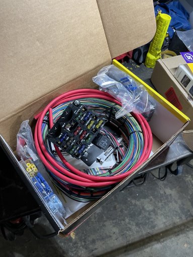

So there is literally a garage extension cord that has been worked into the wiring on the ol' International. I will get a pic in the morning.
This discovery motivated me to get a new wiring harness.

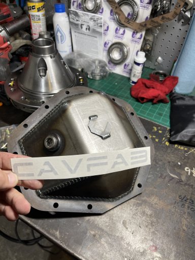

So, yes, I am buying stickers! Still less than a truck payment!
Here is the newest sticker.

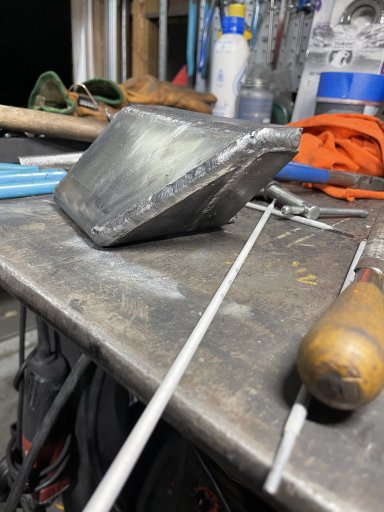

I shifted gears to modifying the leaf spring outriggers I got from barns4wd . The problem was that I needed just 1 more inch (that's what she said). :tearsofjoy:

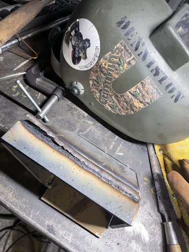

Ran out of wire for the MIG so I switched over to 7018 stick....It's been a while, but I still got it!
It's always a good sign when the slag does this...
That’s some amazing welding buddy. Can’t wait to see it on the road.

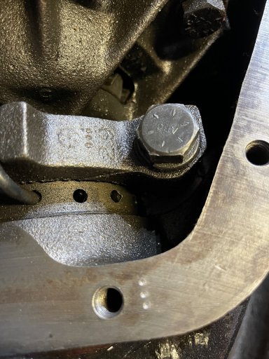

Started by marking the carrier bearing caps with a center punch.

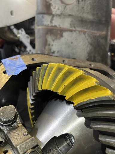

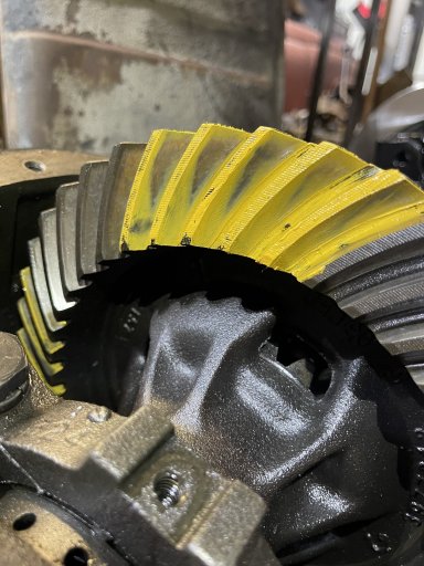

Then I performed an as found pattern check.

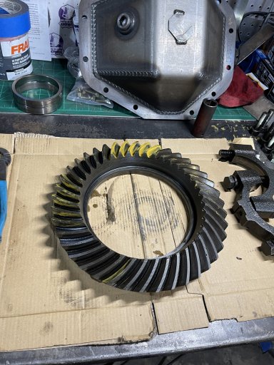

Factory open carrier on the bench ready to remove the ring gear.
Ring gear off,

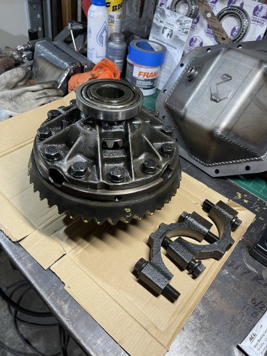

Now to start reassembly......

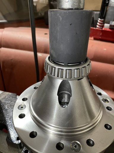

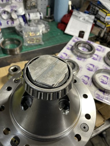

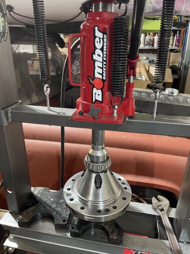

Pressing on the new bearings. I was about 3/32" short of getting these on when the socket I was using mad contact with the carrier. Who would have guessed that the hub nut socket was the perfect diameter to finish the job.
So to press the second bearing on I needed to make some spacers so that I was not pressing against the cage of the first bearing.

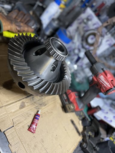

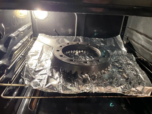

Threw the ring gear in the oven at 225 degrees for about 30 minutes and it slipped right on the carrier.
And ready go back in.

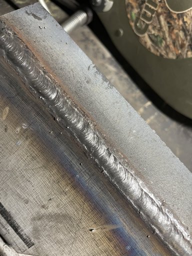

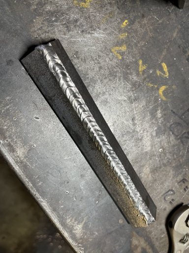

I have been running flux core for years. Ran out of wire the other day, so I took the opportunity to buy a CO2 bottle and solid wire. What a difference.
Here is the first go with no changes from the flux core settings.
