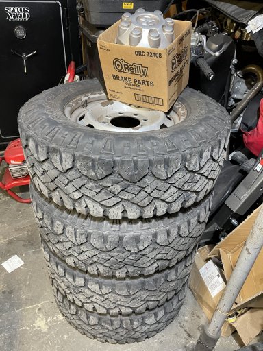

I am still waiting on parts to come back from powder coating.
In the meantime, I found a good deal on a set of factory steel wheels and tires with the 8x6.5 bolt pattern that is needed for the new axles. The wheels are 17" which is perfect for the 37's that will be installed.
Plan to have the tires removed and the wheels blasted. I will then sell the tires, and spray paint the wheels. I should be able to get my $200 back from the rubber sale.

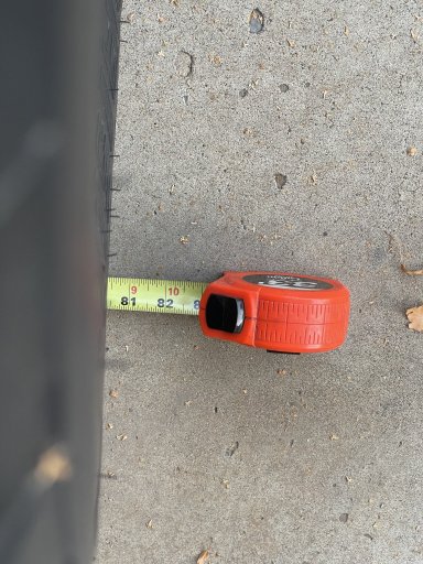

So the tires on the Travelall are 33x12.50r15's. Now imagine with me.....37's! Ooooh....Ahhhh!
Will need to order spacers...Thinking 3/4" should do it. Don't want to be too wide. I like the tucked look better.
This is the current width...
The current 12.50s' stick out this far...not great on a decent paint job! Or for the dog that likes to hang his head out the window as your sailing down those gravel roads!
This is the width of the replacement axle and wheels before spacers and 37x12.50s

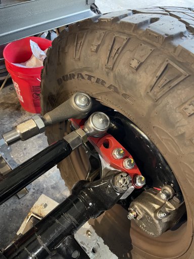

Got a set of 1/2" spacers for the front wheels. No more rub but the wheel studs are short now. Not gunna worry about it right now. Once the axles are under the rig and the 37's are mounted I will either get different wheels (different offset), or different spacers.
