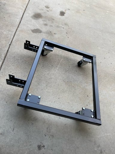

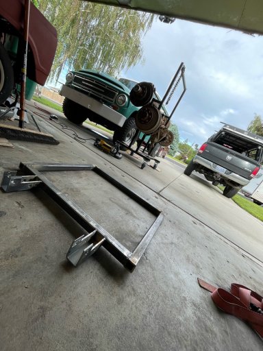

Started out buy running down to the Metal Supply yard, NOT the local home store! The metal supply will ALWAYS beat the home center prices, by A LOT!
Picked up 20' of 1 1/2" x .250" wall square tube for $230.00.
Started measuring out the dimensions I would need for this 496 cu/in monster.
Then got to work...

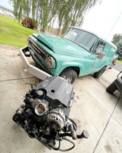

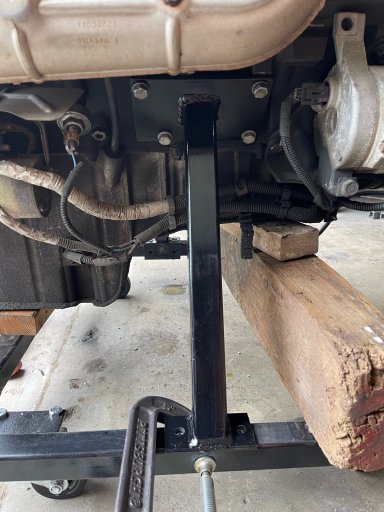

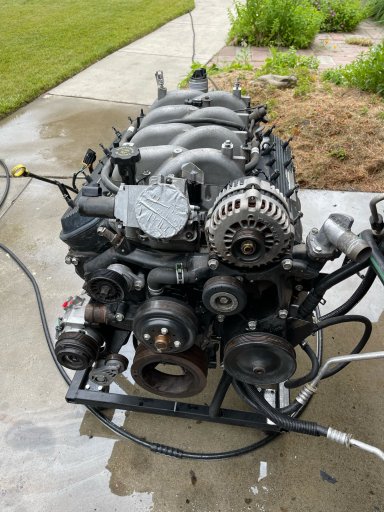

The last few days have been busy. I have still been making the effort to do SOMETHING each day.
Got the engine section of the cart completed. That allowed me to move the monster power plant safely out to the driveway. I then labeled all of the wiring harness connections and removed the wiring harness from the motor. Some connectors will be needed later when connecting the new harness.
Then I spent quite a bit of time scrubbing and pressure washing the engine.
Soon they will be united!

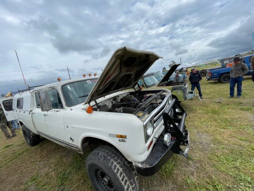

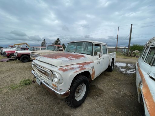

I end up making it to the Binder Bash. Was a bit of a mission finding the actual location. Went to 3 wrong places first then found a craigslist ad with the right location.
I really need me a Travelette, was cool to see a 5.9 cummins swapped one!

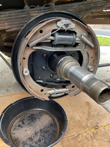

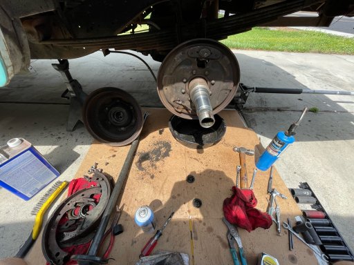

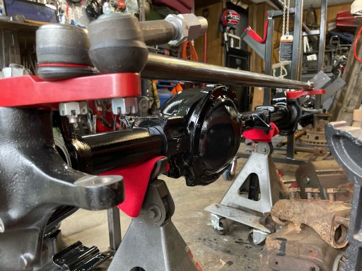

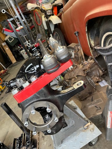

It’s going. I am building the axles right now.
Anybody who knows me, knows that I can’t not make something clean and new looking. Form must meet function!
