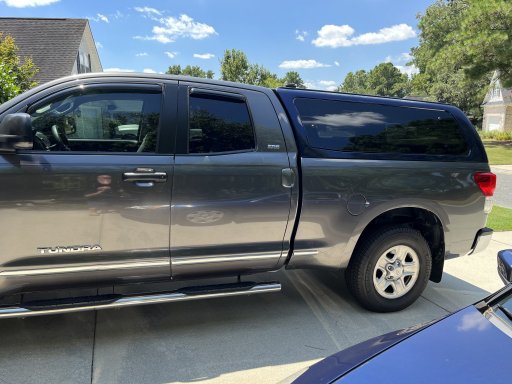

Added a camper shell. Found it used for a great deal, considering the unicorn-ness of these things. Came with a Thule rack and bars, carpeted interior, three plug 12V unit, screens and the actual key to the window....for $350!! Now, gotta wire it to my truck and replace the struts and some seals. But first, I need to decide whether to roll it with a liner or paint it to match. Probably gonna roll it. Definitely have to bribe some guys to help me move this behemoth around. Then, begin outfitting for some surf fishing/camping trips.Truck cap.jpeg

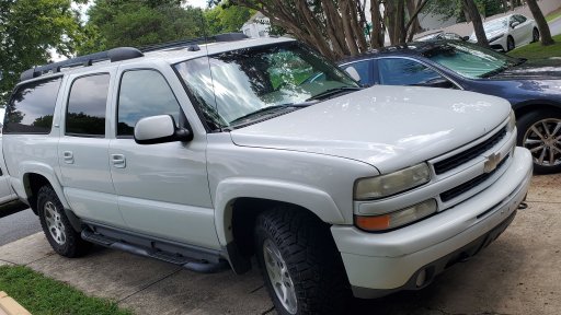

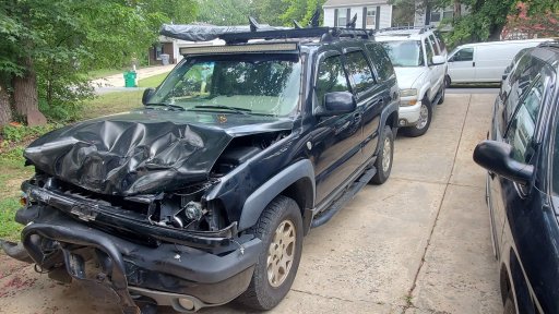

Got my transition to the new car going on. Sucks but it is what it is. Got the new roof rack going on and salvaged the bars from the Tahoe. Tahoe will live but in the mean time I am using what I have. Top rack is a must for me. Lights in progress and I have a new switch pod which I nave no idea where to mount it. I thought I had this all figured out but this a new learning curve. I just wish I could charge the insurance company for my labor just like the shops do.20230806_125226 (1).jpg20230820_173152 (1).jpg20230806_125334.jpg20230806_125226 (1).jpg20230820_173152 (1).jpg20230806_125334.jpg20230806_125334.jpg

Ok. The last post got repetitive pics so I will just describe. Installed new headlights, bull bar with light, needed a new washer bottle got that done working on electrical stuff and a lot more to do. Keep Ya'll posted! As you can see this is a very low budget build.
