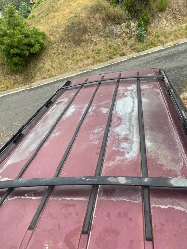

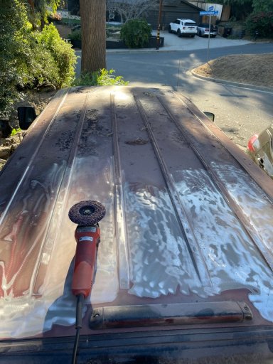

Got some work done on the roof. In case anyone is wondering, i am using the Mastercoat series products. After years of being a fabricator and artist and working at the university of california running numerous shops i got to experiment with many many products, these are the ones ive chosen to put on my own rig. Not associated with them, just my own preferences based on y experiences.
So here is some shots of the roof that had been neglected for too long… next will be the boxed section of the frame.

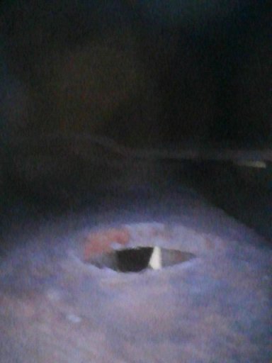

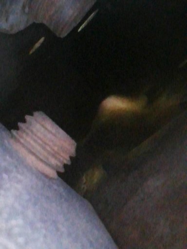

Some endoscope pics of the boxed section of the frame. Next step is to clean this out and protect it. It’s in better shape then i thought it would be TBH.

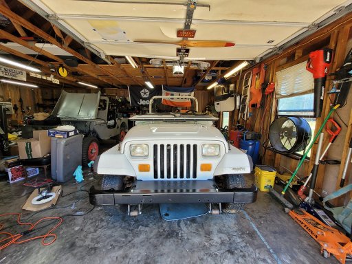

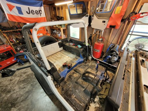

I started out today just doing some refinishing on the Jeep's exterior paint. This quickly morphed into deciding I'm going to repaint the inside of the tub the proper color it's supposed to be. Interior removed...again.
I went ahead and welded up some cracks in the floor pan around where the passenger seat mounts. I also removed all the seat belts, they need replaced, obvious UV damage and fraying.

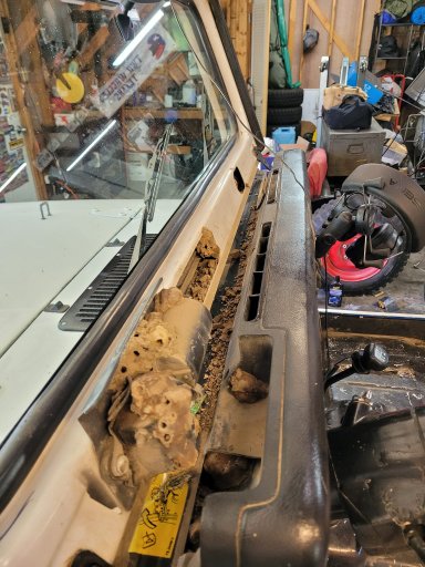

Folded the windshield to replace the cowl seal and found EVEN MORE dirt dauber nests. I'm pretty sure this thing is carrying its payload in dirt dauber nests. I also found 2 random scalpels......okie dokie.
On the plus side, I found no rust on the cowling and small bits on the windshield frame on the side exterior of the Jeep. So no big deal there.
Tonight after it cools off I'll go back out and do the driver's side as far as cleaning up the paint as best I can and prep the inside of the tub to be painted tomorrow morning first thing.
Side note. The YJ looks pretty good with the windshield folded down.

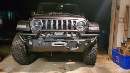

Well I'm at 42k on my Gladiator Mojave. So I got the fluids in the diffs and xfer case changed this past week. In the last 2-3 months I've added
  • Ace Engineering Rock Rails
  • Asfir Engine and Transfer Skids
  • Quadratec QRC Front Bumper and Badlands 12k Synthetic winch
  • Roofnest Condor XL
  • Rear Seat Delete (platform being built this week)
  • KC FlexEra-4 Lights
  • Moon Shade + Large Wall
** Picture has cabling that is not finished yet hanging down.
I think I'm now ready for our 2 week venture to CO/UT next month. Can't wait.
