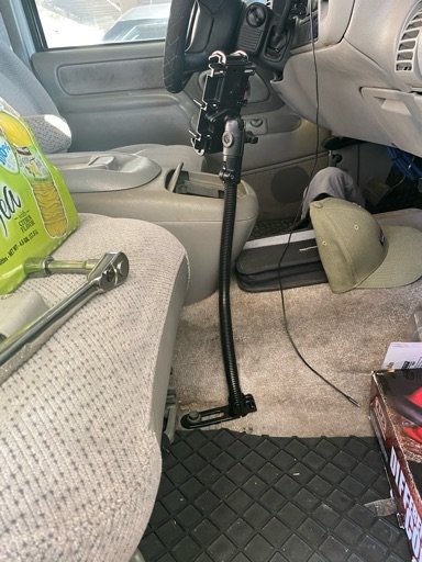

Don’t know if anyone of you have tried one of the seat rail Ram Mounts. But I’ve recently got one and so far it’s awesome. And super sturdy.

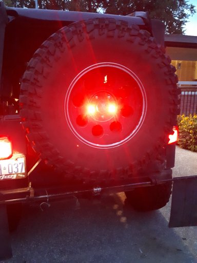

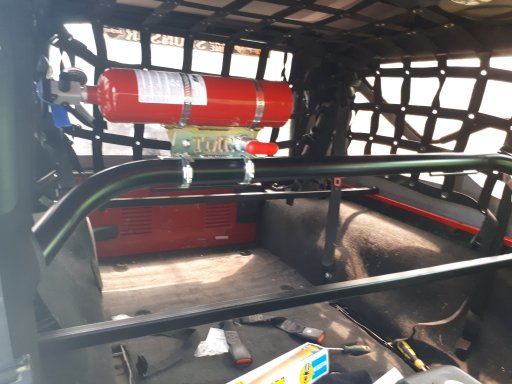

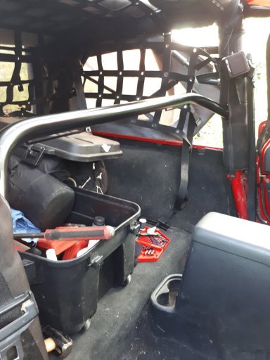

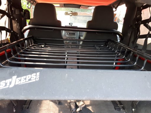

Installed a harness bar, mounted a fire extinguisher on a quick release, mounted a basket in the back for more mounting option, and wired up a third brake light finally.

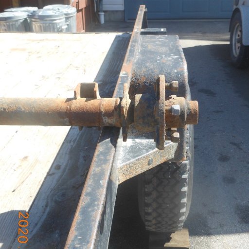

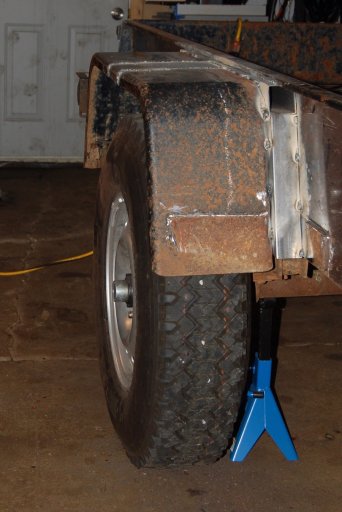

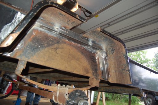

Today was finish the tire change over by remounting and lengthening the fenders. I bought a new Axle in March so I could run the same wheels and tires as my Jeep. The old tires were 205/75R15 trailer tires. The new, 7.50R16.
We cut the old fenders off, used some 2x2 tube to move the fender out, cut the fender in 2 and added a 5" filler.
Pretty much a perfect fit. Next job will be stripping and painting the whole trailer. Then slide in the OSB BOX and get outta town.
That 2x2 tube will be perfect for storing the awning poles.

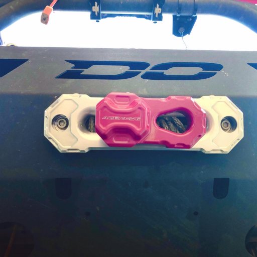

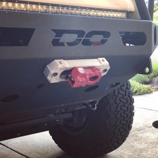

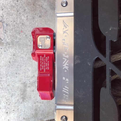

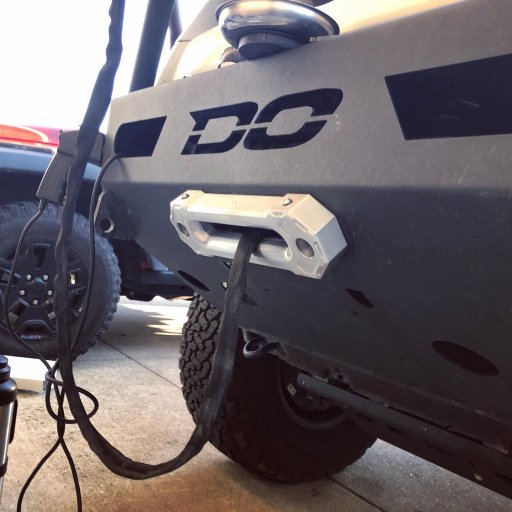

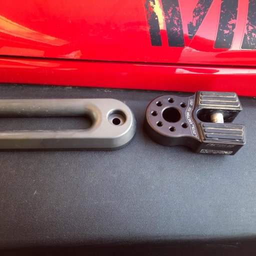

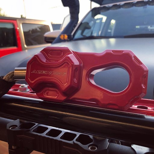

Out with the old and in with the new awesomeness. @Agency6 fair lead, with pre drilled spots for Go Pro mounts and they're brand new winch link. Actual name is forthcoming.
All Agency6 Llc products are manufactured here in Roseville, California. They're products extremely durable, very nice looking and reasonably priced. Check out they're full line of products at www.agency6.com.
