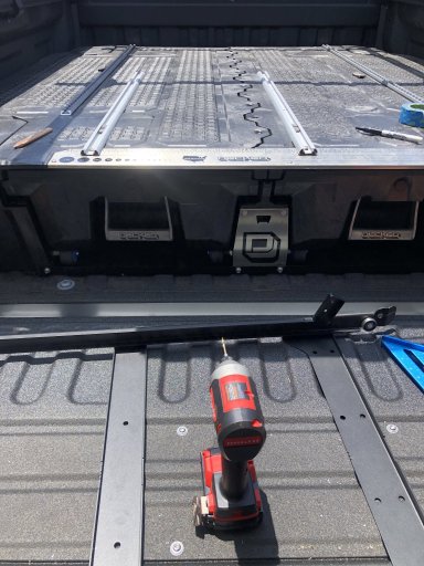

Purchased a used shell a couple months ago, had it painted to match the truck. Made a rack from 80/20 1020 1"x2" and 1"x1" with 2"x1/4" aluminum sides. Added an ARB awning to the zr2 this morning.
Now I don't need to carry a free standing awning In the back of the truck anymore. View attachment 163385

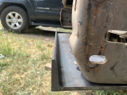

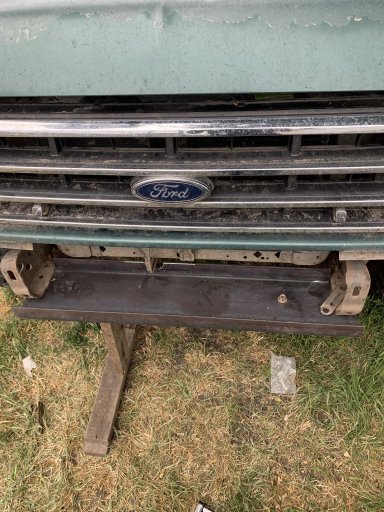

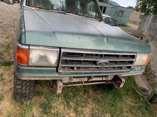

Thanks for the offer Jim. The HF winch tray won’t work for my application, it’s 40” between the frame rails of the Bronco and the HF Tray is 37”.
The tray isn’t that hard to build... and I bought the material to build it a long time ago... the hard part was getting someone to help me get the bumper off my old truck to remove the winch with. I would have been done hours a go, but sleep deprivation and not having more cut off wheels led me to quit after getting the bumper off.

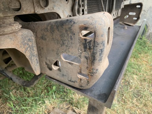

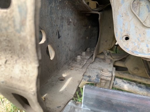

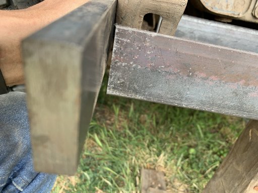

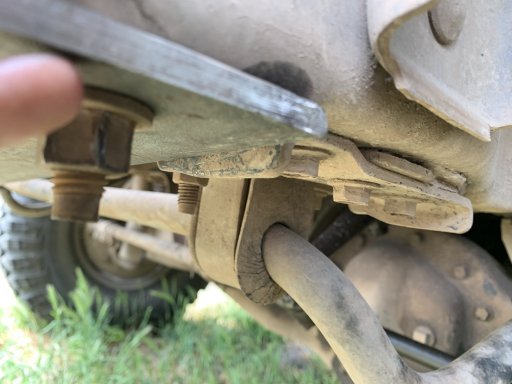

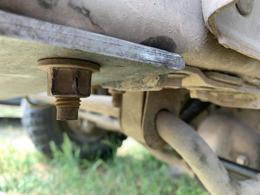

I looked into it hard for quite some time before deciding to fabricate my own tray. I can’t take credit for my winch mount, it’s a pretty well documented and strait forward fabrication project... only needs a grinder and a drill, a welder and a floor jack make it a little better... I’m thinking of borrowing a welder that my friend has loaned me in the past to weld up recovery points/more frame mounts. I’m not too fond of six (6) 1/2” bolts holding the winch plate to the frame... it actually looks like 4 unless I Relocate my front sway bar, which will then still need some 1/4” flat bar welded on to the plate to make the sway bar sit level... or some kind of spacer for the back 2 bolts.
Pictures to come of my dilemma in the morning.

I dont know what you have in mind for final attachment. I sure wouldn't move or alter the sway bar. Anxious to see how the stock bumper will remount if that is your plan.
The stock bumper will move out about 2”, but it didn’t fit snuggly to the frame to begin with.
The bar I’m holding in my hand attaches to the winch cradle allowing me to bolt the cradle through the sides of the frame as well as the bottom of the frame. I’m probably going to bolt it all together, then have my brother weld the critical pieces together.
