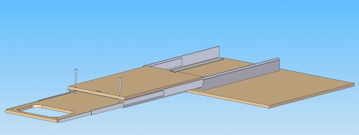

Final fridge slide design. Parts ordered! Plus, the awesome @Ryan Matthes made a custom fitted plywood base to mount his fridge/freezer and storage box on. And not only is sending a full-size template with cutting dimensions, but supplying the not so common long fasteners to bolt it down in the 4Runner!!! Thank you, sir!

Remember this? Well, I received the slides and aluminum angle. $360 worth. And I still needed to cut, drill, buy fasteners, and plywood.
So I returned it all and for $90 more, bought a TemboTusk Jumbo Front-Pull Slide. Jerry was short some bits, but they arrived today, and he's shipping it out yet today! Thanks so much Jerry!!!
Meanwhile, I've made progress on the baseplate that will bring the floor of my 4Runner's storage area up level with the folded second-row seat backs, The fridge slide will be bolted to the baseplate, and the baseplate bolted to the body using the OEM tie-down points. I'm not going to put any covering on it at this point, as we are leaving on another cross-country wander in ten days. I'll figure something out when we come back sometime late August.

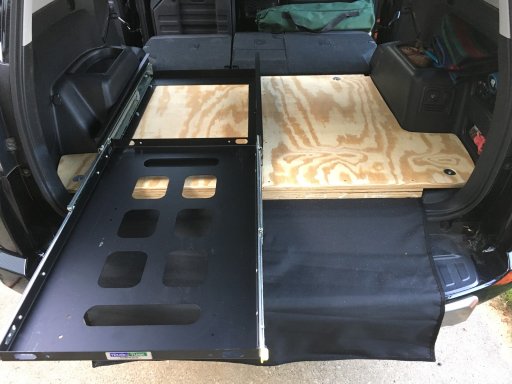

Today I received the Tembo Tusk Jumbo Front-Pull Fridge Slide from Jerry. He didn't even have all the parts until six days ago, and it arrived late this afternoon.
Once I knew the bolt pattern for the slide, I disassembled the platform that @Ryan Matthes sent me the plans for, installed tee nuts on the underside, and then finished installing and bolting down the platform and slide. I put in two sets of tee nuts; one as shown, right up against the edge of the folded back seats. And the second set with the slide just hanging over the rear edge of the platform. The latter is needed with the National Luna 90 Twin when I have the rear seats in their upright position.
View attachment 29425 View attachment 29426 View attachment 29427
Once we get back from our trip, I'll add a covering on the platform. Ryan used carpet, but I might go with a heavy rubber flooring so that things don't slide around.
This trip will certainly be telling as to whether the 90 Twin is too larger, and whether we have enough room for the rest of our stuff. It takes up fully half of the cargo area behind the seats!

Here's the Tembo Tusk Jumbo slide with the National Luna 90 Twin installed. I have it on 110V cooling down. It fits and works great, but takes up a lot of the 4Runner's cargo space!
We leave on our next cross-country trip in three days, so I'll post pictures somewhere other than our driveway soon!
