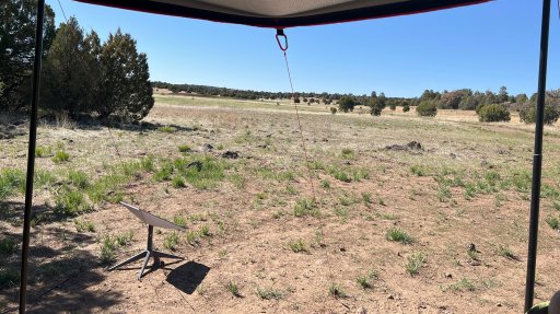

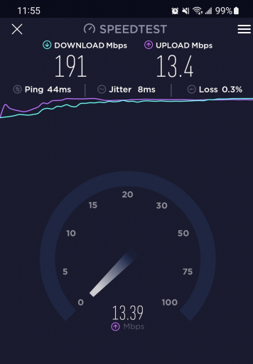

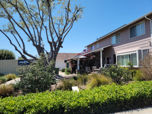

Good questions. Yes, plants and hardscape obstructions can quickly make reception untenable, although in my experience having a large olive tree and my two-story house somewhat close to the dish have not been factors.
Re inclement weather, Starlink says, "Starlink is proven to withstand extreme cold and heat, hail, sleet, heavy rain, and gale force winds – and it can even melt snow. "
Here are pics of where I am currently testing (Dishy is that little white rectangle at the bottom) and the speed.....

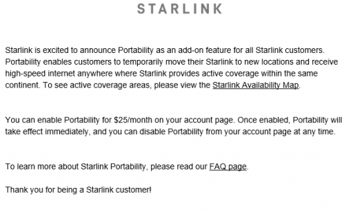

Something to keep in mind is that, currently, Starlink is not really a viable option for overlanding/mobile use outside of the Starlink zone you're in. By default, roaming is disabled which means as soon as you leave your zone you have no service regardless of the fact that there is signal. You probably know this already as it's also talked about in the link provided in the original post, but wanted to make sure and mention it so people know what to expect. I do tech work from home and would love to have decent internet out in the middle of nowhere since I can work anywhere that has reliable internet, so this is definitely something I'm interested in and will be watching this thread to see how it goes. Once roaming/portability is working well then that will really open up not only travel options but also where we can live.
Howdy Drax,
Just a heads up. The system works very very well even when you are far far away from your service address. Our service address is in South Dakota and we are currently in central Arizona. We had the same concerns prior to purchase but after a long conversation with Kelly OB#2032, We ordered ours with confidence. We have not been disappointed. As it was explained to me, if you aren’t in your service area you don’t have priority so if your trying to us it in a congested area, you may have slow or no service. As we tend to avoid congested areas like the plague, I don’t think that will be an issue.
Reactions: ProtonDecay

Howdy Drax,
Just a heads up. The system works very very well even when you are far far away from your service address. Our service address is in South Dakota and we are currently in central Arizona. We had the same concerns prior to purchase but after a long conversation with Kelly OB#2032, We orders ours with confidence. We have not been disappointed. As it was explained to me, if you aren’t in your service area you don’t have priority so if your trying to us it in a contested area, you may have slow or no service. As we tend to avoid congested areas like the plague, I don’t think that will be an issue.
That's awesome to hear! I'm glad Starlink isn't keeping roaming disabled currently, that was the biggest issue we were worried about and it sounds like it's not an issue anymore. Hopefully it stays that way!
