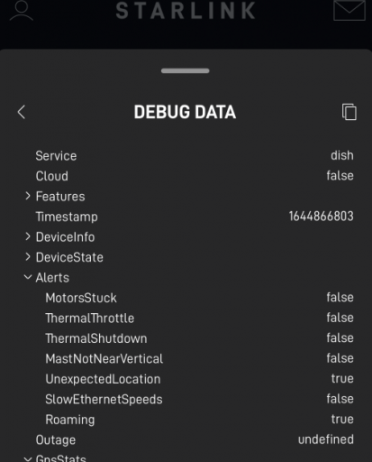

And here's a snapshot of my debug data showing Roaming = true.
So, fingers crossed that this will be true for most, if not all, new users going forward. Can hardly wait to test it out someplace other than my front yard, but I want to get the overlan build done first.
