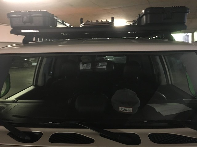

I'm running two medium Plano storage boxes , used to have an aluminium case but much prefer the plastic option now , they work well seal good and don't draw unwanted attention which I felt a shiny ally box did

I run a pair of plano "tactical all weather rifle cases" on my rack full time via bolts with a dab of silicone to get the stuff I desire to have with me all the time out of my rear storage area and keep it all available without unpacking even when the rear area is loaded full. One case houses my hammock, chair, small table, bedding, and a spare set of clothes. The other case contains my recovery rope, tree strap, soft shackles, jumper cables, and air compressor. When I toss other things up there temporarily they are usually in pelican cases or are jerry cans.
Key to the use of the plano cases all the time is that they keep me under the height restriction to get into my work parking garage!
How’s the wind noise with both of them babies mounted?
