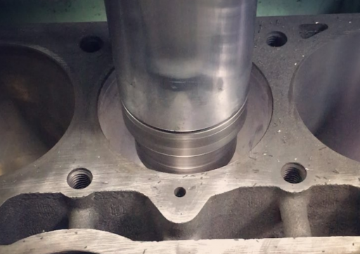

Geddes Racing Engines Jade's engine block up in the boring bar this morning cleaning her up nice! Federal-Mogul Motorparts is supplying all the replacement engine components & helping the rebuild! This is nuts! Jade is a lucky gal & I am truly blessed. She may have her quirks & flaws but who doesn't! I sure do! We'll keep her on the road forever! Hang in there Jade!
Engine block in the boring bar.PNG Engine block in the boring bar (1).PNG Engine block in the boring bar (2).PNG

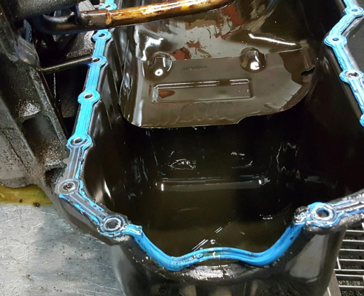

We found that the #massive oil leak was due to the oil pan gasket being pushed in (pic below). The knock was due to a bent rod which was caused by a previous head gasket failure that allowed coolant into the cylinder. You can see the uneven wear on the piston skirt from the bent rod (pics above).

Seem to remember that there should be cross-hatching at this point in those cylinder bores?
Or is this after boring / before honing?
