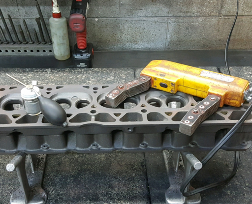

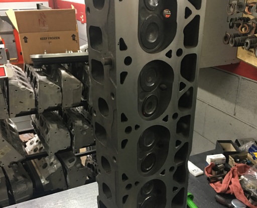

Update from @geddesracingengines - rebuilding the cylinder head for Jade's engine rebuild project. The @fmmotorparts and @felprogaskets parts were a great fit for this application. Cylinder head was cleaned and magnafluxed, installed bronze valve guide liners, multi-angle valve job on the intake, radius valve job on the exhaust, resurfaced with cbn and assembled with new parts from @fmmotorparts
Rebuilding Jade's Cylinder Head.PNG Rebuilding Jade's Cylinder Head (1).PNG Rebuilding Jade's Cylinder Head (2).PNG Rebuilding Jade's Cylinder Head (3).PNG Rebuilding Jade's Cylinder Head (4).PNG Rebuilding Jade's Cylinder Head (5).PNG Rebuilding Jade's Cylinder Head (6).PNG Rebuilding Jade's Cylinder Head (7).PNG
