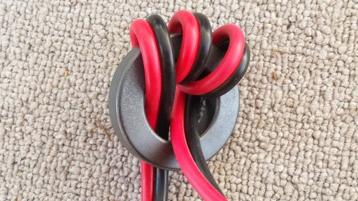

If one or more of these steps improve the situation but don't resolve the problem, you can try switching to toroid cores (see the pic) - more passes through the torus will provide more suppression. (The bead essentially permits one pass through the torus) Use a wire tie to support the weight of the core to protect the wiring from vibration.

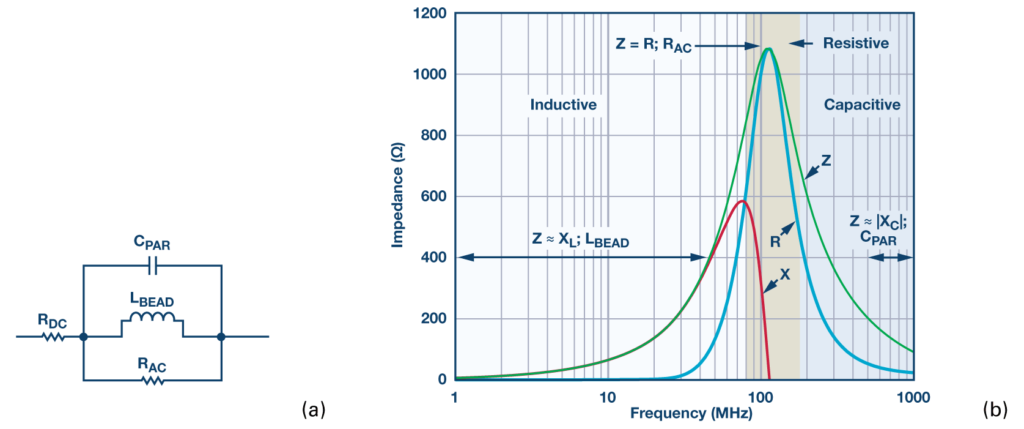

WARNING!!! Technical crap ahead
All ferrite chokes are not the same. The material and shape determines the frequency range. Some chokes are for very high frequency or very low frequency. As it turns out, the noise caused by the choppers is broad band. In other words it ranges from low to high frequency. If you remember from your electronics training.... chopping generates a square wave and a square wave is the sum of all the odd harmonics, some of which will fall in the frequency bands of interest. The key is to get rid of the square wave as close to the chopper as possible. This is done with a cap(s) across the power at the lights. As I discussed in previous posts, use higher quality ceramic caps and caps of a broad range of values. Caps have an intrinsic resonant frequency where the filtering is better/worse. This is due to the cap material and the parasitic inductances in the packaging. That is why you use multiple values.

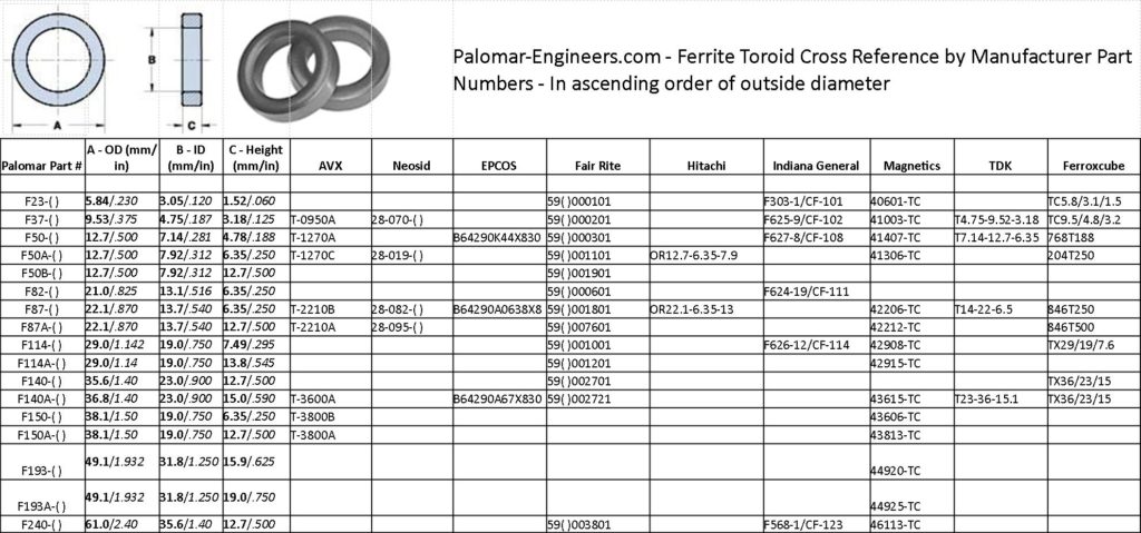

A very good point on the ferrite chokes. If someone needs more detail on selection and use, the tutorial pages at Palomar Engineers are helpful:
Palomar Engineers is very responsive and helpful, but you might also check the comments on ferrite cores from Amazon. Some like this one at Amazon have comments noting that they solved an LED headlight problem (just an observation, not an endorsement).
Old_Man's description of problem harmonics coming off a square wave generator is spot on. If I understand his suggestion correctly, it's a variation on a multistage DC L-Filter or DC Pi-Filter for EMI where the ferrite bead provides the inductance. There are a lot of variations available for purchase if someone didn't want to build one. You could start looking for "DC noise filters" on Gigaparts.com or Ham Radio Outlet but I'd hazard a guess that most of these are only single stage L-Filters and won't be as effective as Old_Man's circuit.
