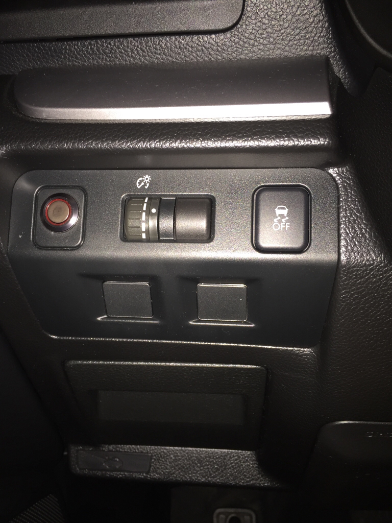

I'm interested in how you're going to wire up the light bar, specifically the switch on the inside. There's a few dead switches in all 14+ foresters I've been wanting to take advantage of with a light bar.
krzyboy2o
2,011
San Jose, CA
2976
I'll most likely put the switch here to fill in one of the blanks. It's easy access to the fuse panel and can use the same firewall grommet from the fogs.

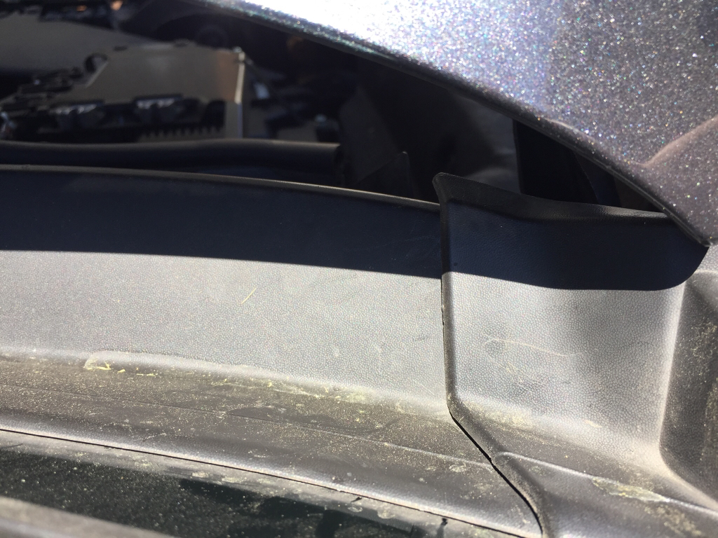

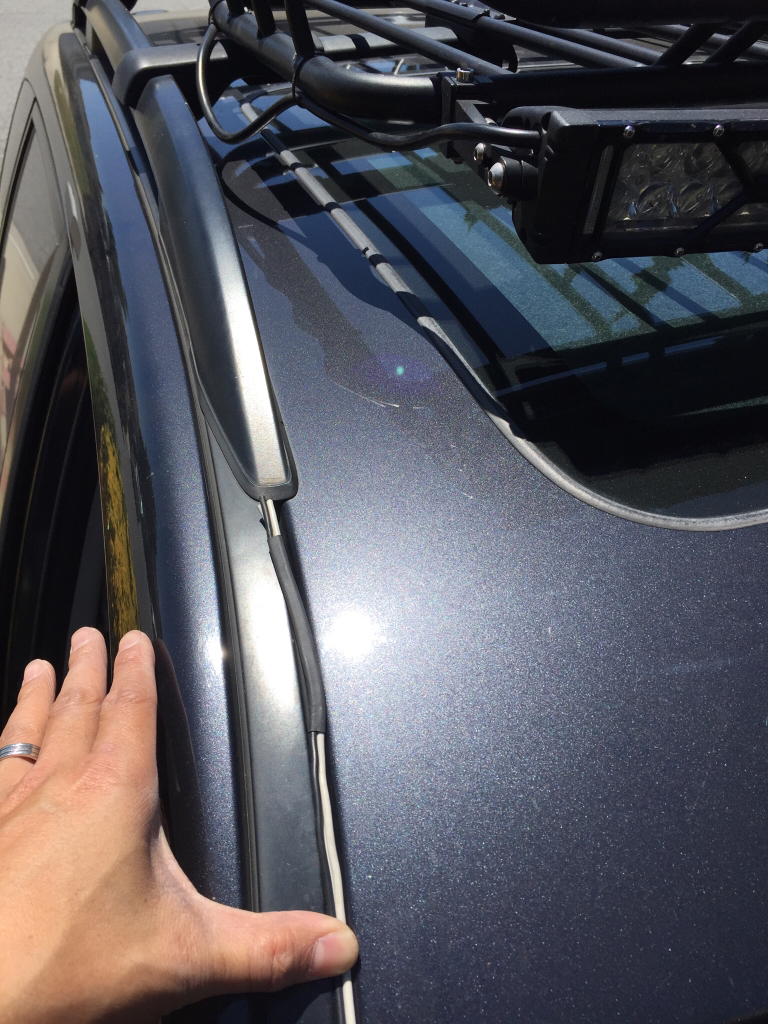

Did some pre- planning this morning trying to figure out how to wire my light bar.
In short gonna run the wire down the left windshield. There's a channel I can follow down to the engine bay.
Once I hit the top on the engine bay, (near the wiper) gonna drill a small hold in the plastic cover and feed the wires through.
From there run the wires along the back engine and to the batt.
It prolly doesn't make much sense in writing but here's some pics to help.
Questions:
Best connectors to splice wires? Butt or wire nuts?
Can I use RTV silicone down the window to secure the wires down?

Questions:
I don't like wire nuts for automotive wiring. Some folks insist on soldering, but I have had excellent results using high quality butt connectors (try a marine supply store), a quality ratcheting crimp tool, and dipping both ends of the stripped wires in conductive grease (electrical supply store) before crimping, to keep water out and oxidation away.
RTV to secure the wires? I'm rooting for you, but doubtful it would hold up with the UV exposure.

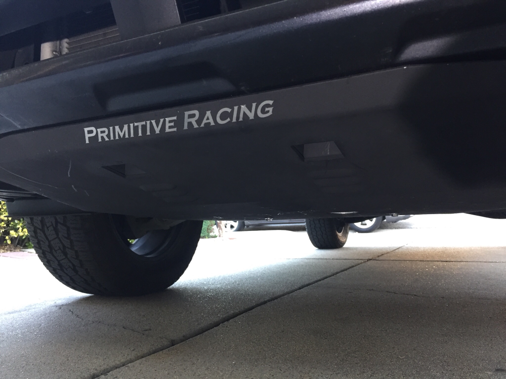

Not my best spray paint job but it'll do!
Much Thanks to @Trev4vis for the skid plate!
krzyboy2o
2,011
San Jose, CA
2976
Install was a little challenging being a one man team. But overall doable with some patience and a good beer! I'll post a video of the install after I'm done editing out all the curse words.
