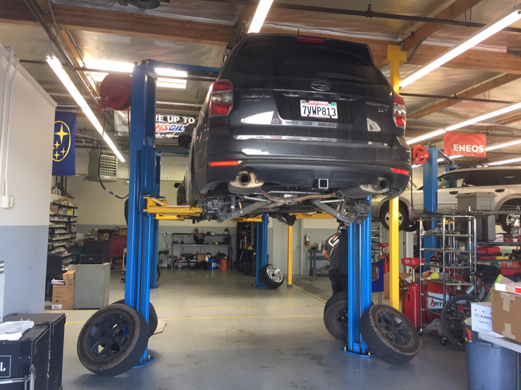

Getting maintenance work done at GarageOne in Campbell. So far so good.
As far as the leak, the tech said it's common for SJ's. It's either the O-ring or the seals that need to be replaced.
In order to find out, the underbody needs to be cleaned of dirt, grease and grime.

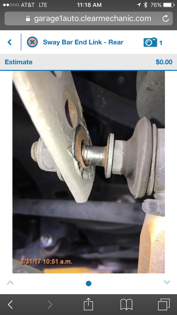

Just got the report sent to my phone.
For guys running Whiteline RSB check your bolts frequently! It's common for them to come unscrewed.
Rear Main seal is also a common problem for SJ
Just keep an eye out and check your oil every other gas fill-ups

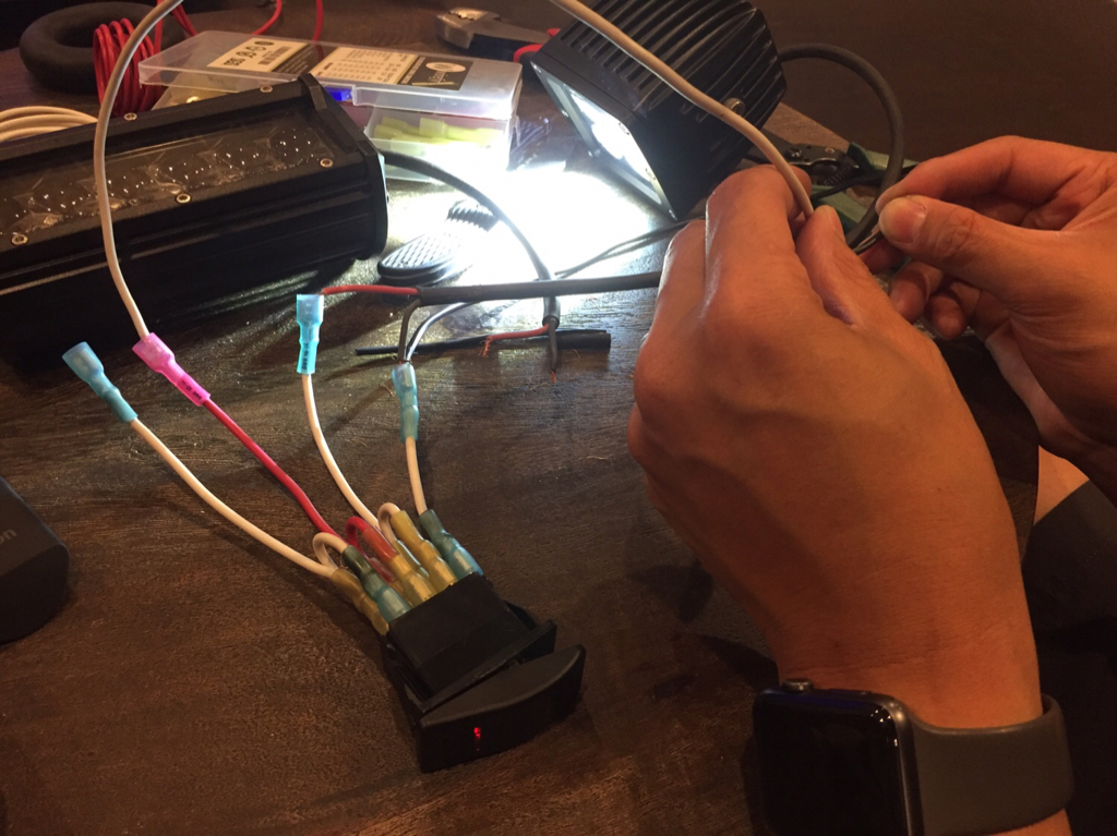

trying to remember what I studied in college.. haha
DPDT switch for the 2-way light bar. (On - Off - On)
So my plan is to bend a piece of acrylic to match the lines of the cubby beneath CLA to house my switches, USB ports, and battery meter.
We'll see how it goes. [emoji51]

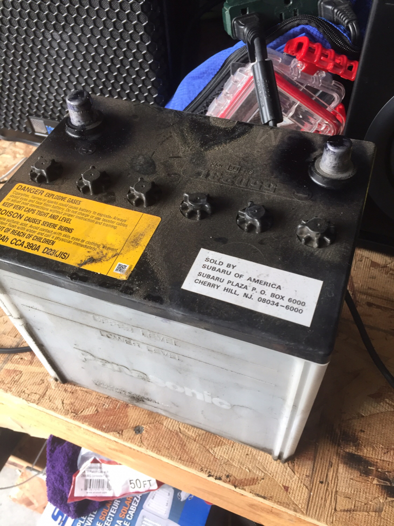

Yesterday during my maintenance check my battery failed the charging test. It's capacity is at 43% after going flat a month ago. I then went and bought a Deka Intimidator AGM however I'm having second thoughts as the warranty is only 30 months. I'm debating if I should return that and spend the extra $60 on an Oddessy that has better specs and a 4 year warranty.
Another option is it keep the Deka use Amazon rewards points and get an Oddessy for a dual battery setup. If you chose this route, what would be your primary and secondary? What and where would you mount?
It's fun building this rig and researching all the options but hardest part of this making the decisions... [emoji848][emoji51]
I don't know the ratings on the battery you purchased. I'm sure it would it would be good to you, especially on a daily but I am a fan of Odyssey. I installed a rebranded Odyssey when my car was only a year old.
As far as dual battery goes if I decide thats necessary for my Outback it will be going in the spare tire well. Not a lot of options on a Subaru outside of that.

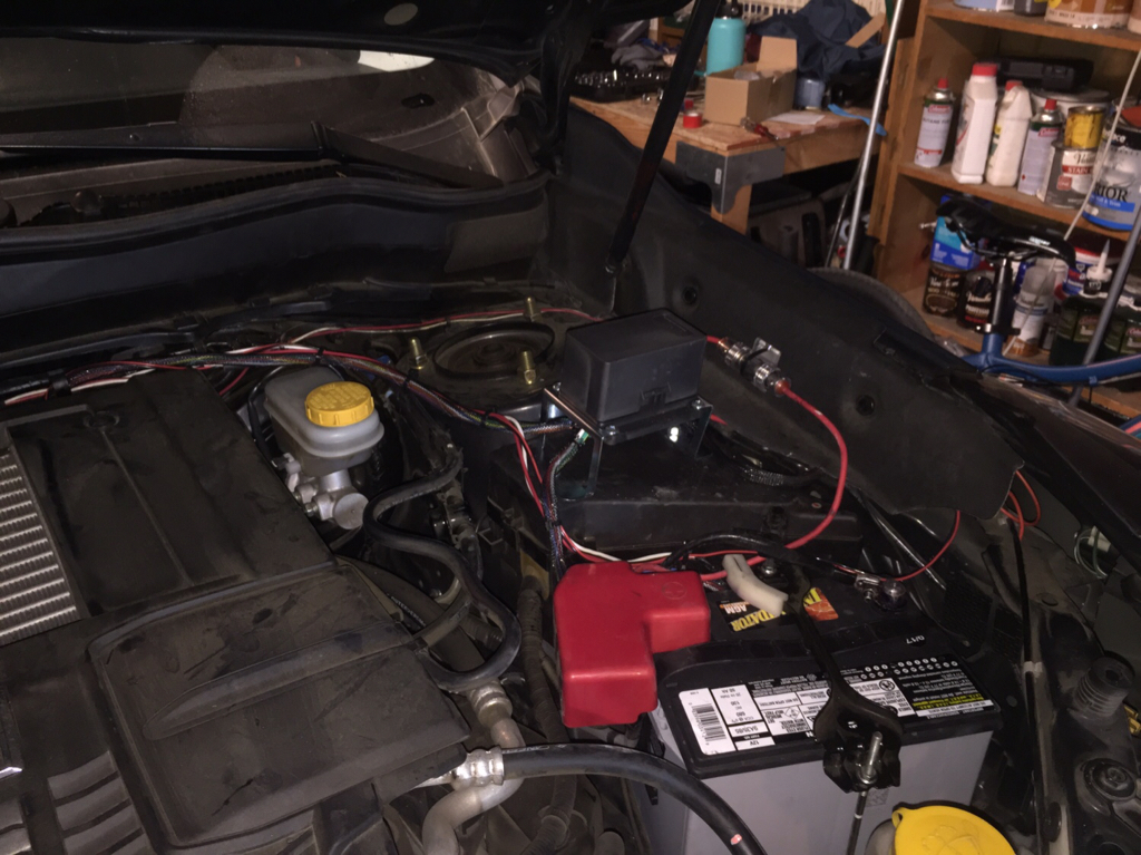

Calling it a night...
Bussman waterproof relay installed
Light bar finally all wired up.
