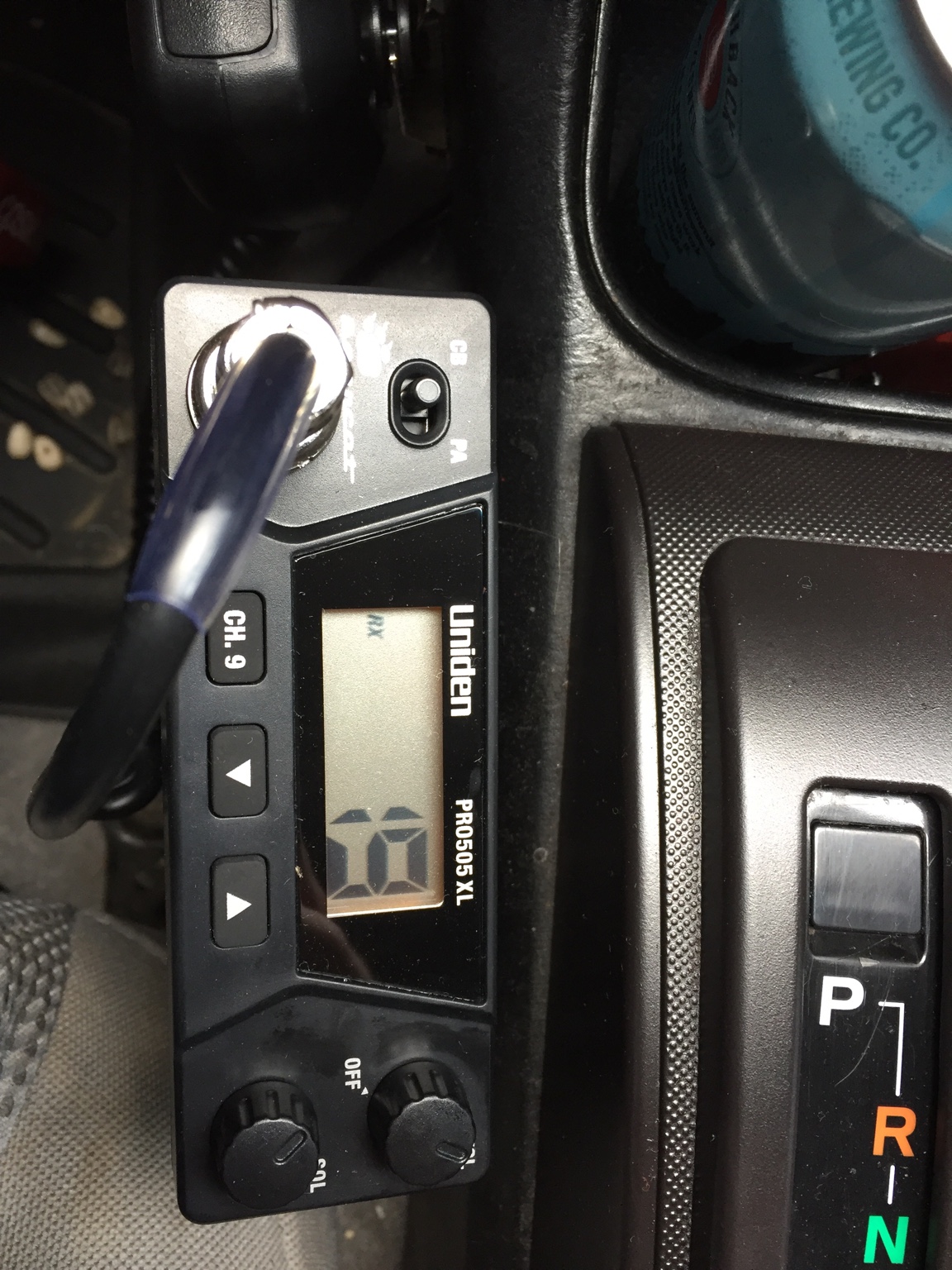

cb newbie here. if my cb looks like this most of the time does that mean I have no signal? I can hear people and signal bars come and go while I'm listening. PTT I have full bars though.
You're on the right track. The reason your CB looks like that without bars means it isn't receiving an RF carrier or signal. CB's do not constantly transmit and therefore if you aren't in range of anybody AND they aren't transmitting you won't see the bars. It's hard to say what the bars represent as there's no true scale typically. Different manufacturers and different models even, have different thresholds for representing received signal strength.
Have you measured SWR or tuned the antenna on your setup?
Here's a good read on that if not, may be worth a shot just to make sure your antenna/coax/radio are all performing correctly.
https://www.rightchannelradios.com/blogs/installation-guides/18330687-cb-antenna-tuning-instructions
Best of luck!

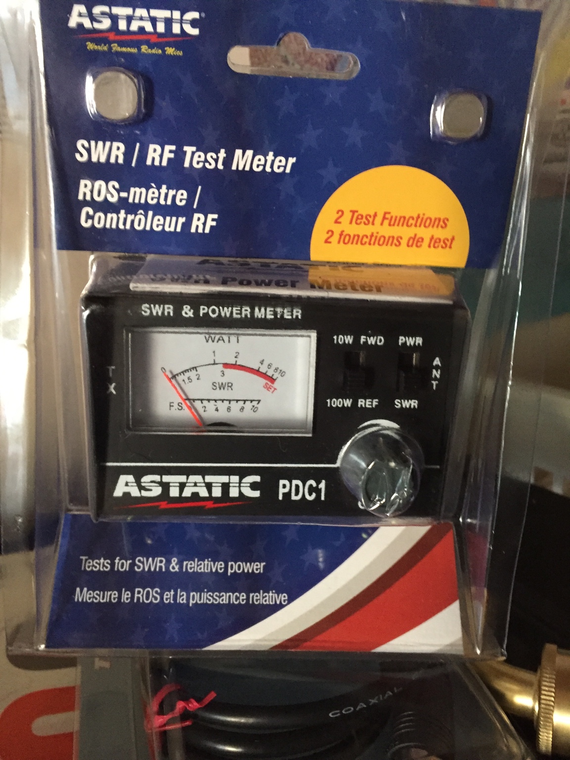

finally was able to tune my antenna with this thing. Channel 1 the needle sat at 1.4 and ch 40 it sat at 1 after following radio worlds steps to tuning an antenna. Is that a good reading? I didn't have to turn the tip on the antenna at all. Anything I do to my rig never seems to go smoothly. So I'm a little suspicious on whether or not that's a good reading on the first try......thoughts??
TerryD
3,402
Covington, Virginia, USA
Terry
R
3710
KT4OZ
Sounds ok. Usually under 1.5:1 is acceptable. What was the reading on 20? If it is between your other two readings, you can tune the tip pout a bit and shoot for getting the lowest reading on CH 20 and going up as you go toward either CH1 or CH40.
