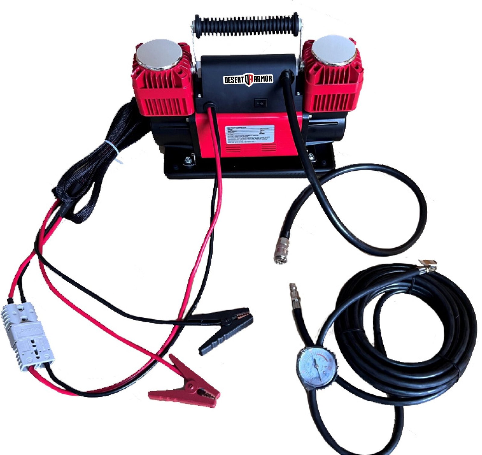

After a lot of researching, I just bought the ARB CKMP12. I hooked it up to my second battery and ran it quickly with no issues. I'll have to report back after using it to fill up all four tires.

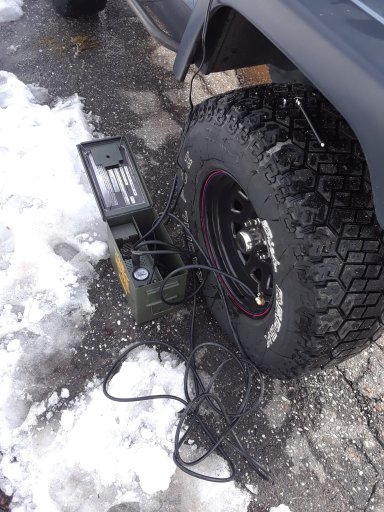

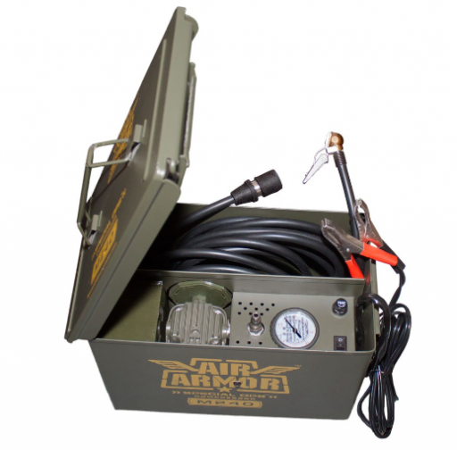

It is the Air Armor M240 I mentioned in a previous post (#74 - I went back and looked). I've had it for quite a few years now and have been happy with it for filling up my Jeep's 33" tires. Plenty of room inside the can for the hose and battery cables and other related stuff. Not the worlds fastest (not the slowest either), or quietest (it is loud, but I've never seen a quiet one other than CO2 tanks), or cheapest (you can spend a lot more for a compressor), but I like it.
Link: Tire Inflator, Air Armor M240 30AMP, 3500 Cu In
On the site linked above it runs for $129.99. If you shop around you might find it cheaper (definitely not cheaper on Amazon).
I like it because:
1) I'm retired Army, so anything in an ammo can is cool to me.
2) I can swap it between vehicles (96 Ram 1500 4x4, 98 Jeep TJ, 46 Willys CJ2A) depending on what I'm heading out in. And I have.
3) Power cord and hose are plenty long - I don't have to move the can once I've connected the power cords to the battery (they recommend keeping the vehicle running while using this thing; probably they all recommend you do).
4) Being in an ammo can (did I mention I just think ammo cans are cool?) keeps it protected and safe if knocked around. I could mount this can outside my Jeep or on my trailer and not worry about the elements harming the compressor and such.
Here's one mounting idea (but you want the one for the "Fat - 50"):
5) Was reasonably priced I thought. Folks spend hundreds of dollars for those ARB twin compressors (they are nice if you can afford it), and if I were doing an Alaska to Argentina trip I'd probably get one too. But since I'm not, this M240 thing works for me.
6) Where it attaches to the valve stem, it clips on so you don't have to stand there holding it on (I don't know if other similar compressors do the same thing).
Cons (I guess I should try and keep this balanced - I didn't mean to turn this thing into an essay):
1) It does get warm/hot after use (I'm sure all of these similar-type ones do to some extent). But since it is enclosed in an ammo can, you probably need to take a little more time to let it cool down before closing the lid afterwards. The compressor is mounted inside the can; it doesn't come out of the can for use.
2) It isn't a 100% duty cycle. Plenty of time for me to air-up my tires and help someone else out, but that's about it (although I've never timed it). Tell your friends to get their own air compressors! I'll turn it off sometimes when going between tires on my Jeep. I think it only takes a minute or two (three maybe?) per tire to bring my 33" tires back up to where I want them.
3) The built-in air pressure gauge isn't the most accurate. Use a hand gauge you trust to find out what your desired pressure is, and then compare that to the pressure showing on the built-in pressure gauge so you'll know when you're where you want to be pressure-wise according to the M240 gauge.
4) The ammo can isn't going to mold-to-fit in an odd-shaped space like a soft-sided bag might do. So it might take up a little more space than the compressors that come in a soft case (like some of the VIAR compressors).

These things get hot after running a while (I'm sure they all do). Heat rises, and normally when using this thing the lid is open so heat can escape. I don't know if overheating would be an issue if you were running it with the can on its side. That would be my concern.
I could see storing it on its side, but then taking it down and putting it on the ground when needed.

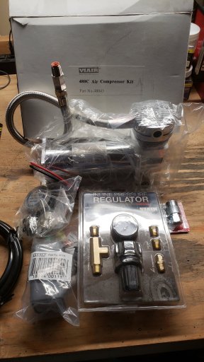

Got a 480c, trying to decide If I want to mount it on my rig with an airtank, or make a "Portable" unit out of it.

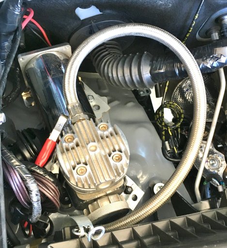

I have the same Viair 480C. It was mounted under the hood of My T4R for a couple of years and now lives under the hood of my Tacoma. Great compressor. I got mine as a "scratch and dent" buy off ebay for a great price and it has performed beautifully without an air tank.
Got pics of your setup? Any tips for a non-tank setup? I had a 450c on my T4R with a tank, but included those when i sold it.

The truck is pretty new so I have installed it under the hood but have yet to wire and plumb it. It's usable as is--alligator clips and quick disconnect on the braided hose. But I will wire it to a dash switch and install a quick connect on the bumper, now that I have a steel bumper installed.
The can looks large enough to mount a small 12v computer fan to the side of the ammo can and wire it in to the compressor switch. That way it will blow cool air over the compressor while it runs.

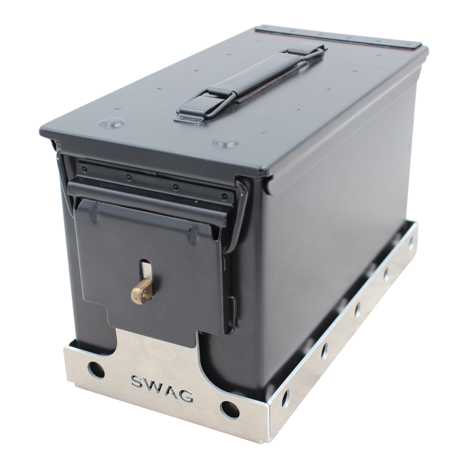

If the 400 model has the same dimensions as the 88P model, then use a surplus 400 round ammo can. This is what I use, and it has room for the 6 foot extension hose and some small accessories. Water proof and offers good protection to the unit.
