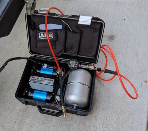

Recently picked up the portable ARB Twin. I like it but dang is it big and heavy. I can move it between my Jeep and truck though. I still have two Masterflows but I need to convert them over to standard threads. One of the coiled hoses was split into 4 pieces when I opened it up recently

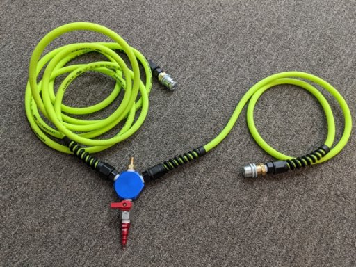

I made up my multi tire inflator for my ARB twin. I went with a two-tire system since I seldom run the same pressure front and rear. Not shown is the pressure gauge that snaps on to the schrader valve. It still fills the tires faster pretty fast. I am debating on adding a pressure regulator so I can just set the pressure and go on with other tasks while it is filling.

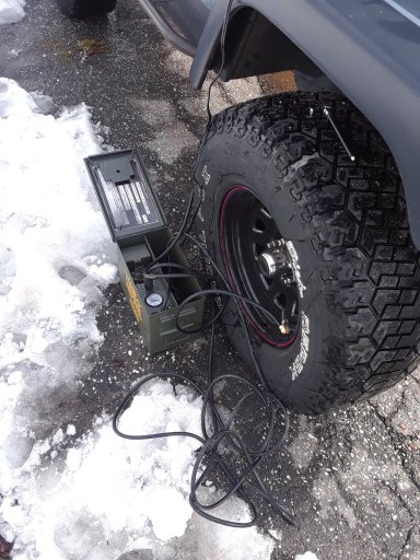

I use the Air Armor M240. Comes in an ammo can and everything fits inside, so is easily portable. It works for me for filling up my 33" tires. Hose and cord (which clamps to your battery posts) are plenty long. Cost is about $130.00.
I also own a 10lb CO2 tank set-up. Works very fast, is quiet, and overall is great... until your run out of CO2 (yes - it happened to me after a trail run). Also takes up a lot more room than my M240 set-up, and if you wanted to move the tank between vehicles you need to have mounting brackets in that vehicle too.
Cool. I use to run my 450p in a 50 cal ammo can. Was able to put compressor, wiring and hose inside. Made it easy to swap between vehicles.
